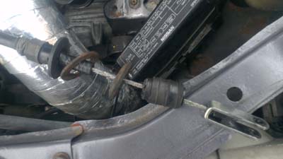

k550i-1443-jpg.29365
- cable rivet pin shearing off

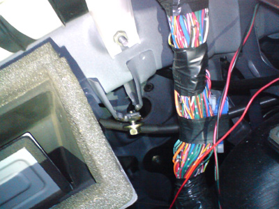

dsc09668-jpg.35992
- clutch pedal chassis mount ripped off
http://micra.org.uk/threads/pollymobiles-rebuild.35251/page-117#post-701561
in the end it was all caused by a dry cable.
so I lubed the cable with some engine oil and it became all light again.
