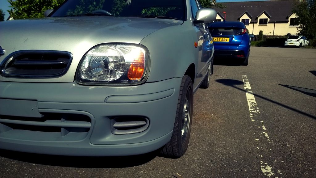

Has anyone rattle canned their car?
Yeah, lots more. It depends on what finish you're looking for. To get it really smooth and shiny you'll have to do a lot of sanding between coats as the coverage from a can is nowhere near as smooth as a gun. Lots of paint = lots of cans = lots of money.
I would also second the roller. I used Rustoleum, which has the added effect of helping prevent rust.
That's pretty much it. A brush for the nooks and crannies, a roller, and some paint. I'm using military paint on this one, in the past I've used pretty much anything I could get my hands on.
I'm not thinning the paint on this one, as I'm not after a super smooth finish, but you can actually get an amazing finish with a bunch of thin coats.
About 25+ years ago me & a mate of mine sprayed an 850 Mini with aerosols. Cost a fortune & had a really flat dry looking finish !
It may have been our technique but frankly it looked crap ;)
