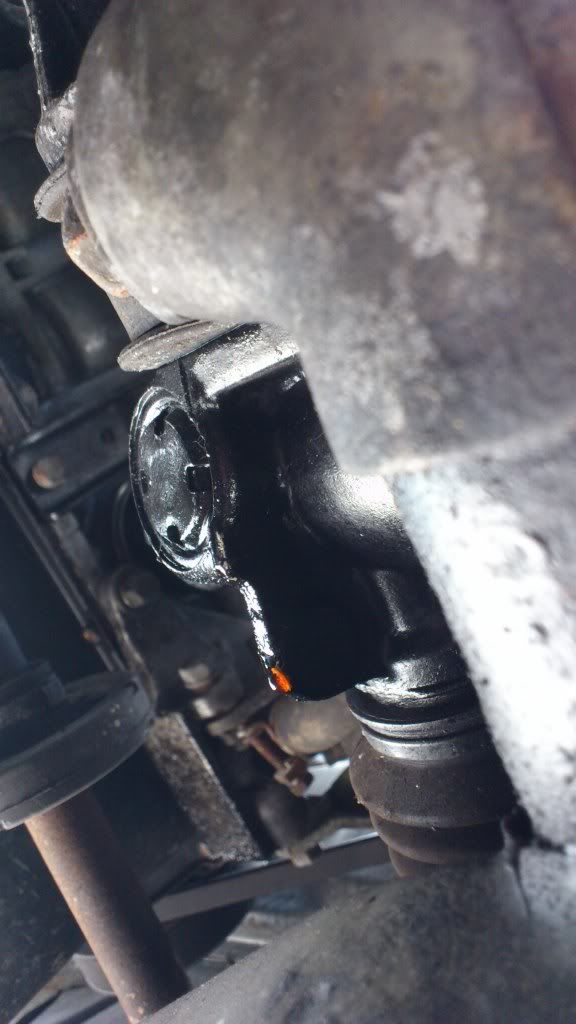

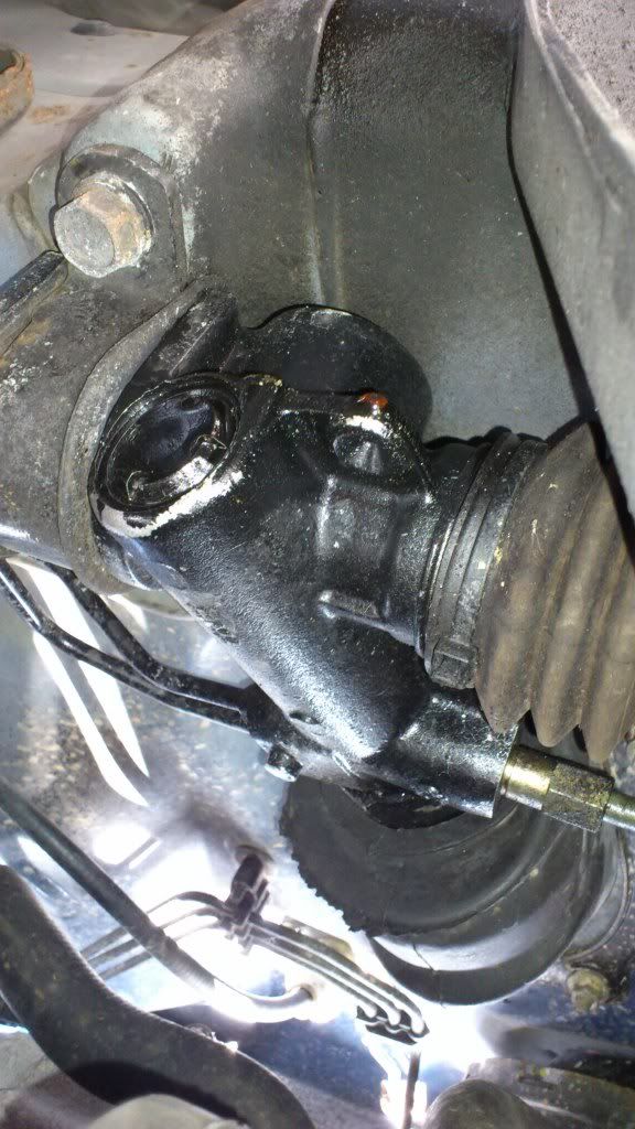

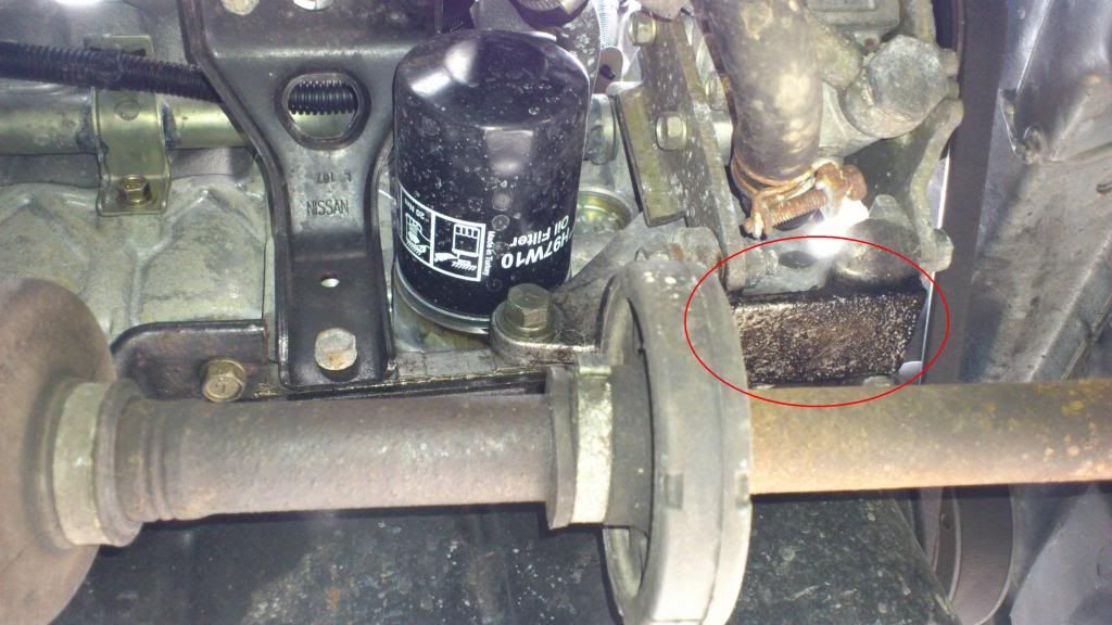

Also spotted 2 other problems when under the car. Under the oil filter there is a strut or something to memory? Well that was coated in a dirty, black oily substance, though no apparet leak from the oil filter? Secondly, what I believe to be the master cylinder (on the bulk head of the car) appears to be leaking to, though I reckon thats a cheap/easy fix?...

could that black goo not be just residue oil from past oil changes which has covered in dirt dust etc. wipe it clean with wd40 and recheck
which part of the master cylinders leaking? where the brake lines are screwed in?

I suspected the residue could just be spilt oil as there is no trace of it leaking from anywhere as I said. Yes, wiped it clean and will be keeping my eye on it.
Presuming it is the master cylinder it is I'm on about (on the bulk head, drivers side) it appears that the entire lower half of it is wet, so could it be leaking from the top perhaps?

What do you think to the master cylinder problem?

Not noticed it creeping though the braking does sometimes seem "soft" like she slows to a certain point then I really have to press down... Can't say I've seen any reduction in break fluid level though?

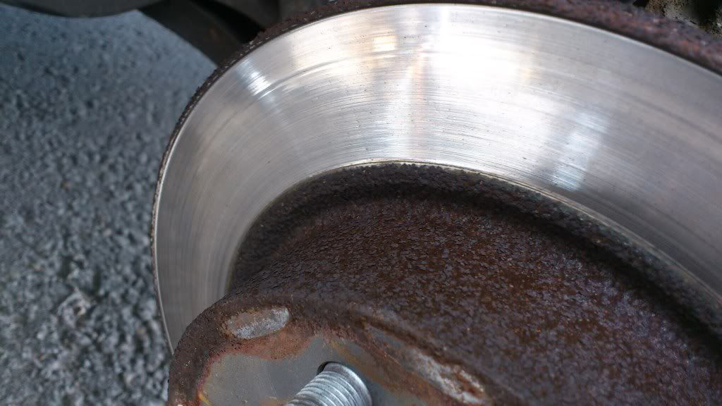

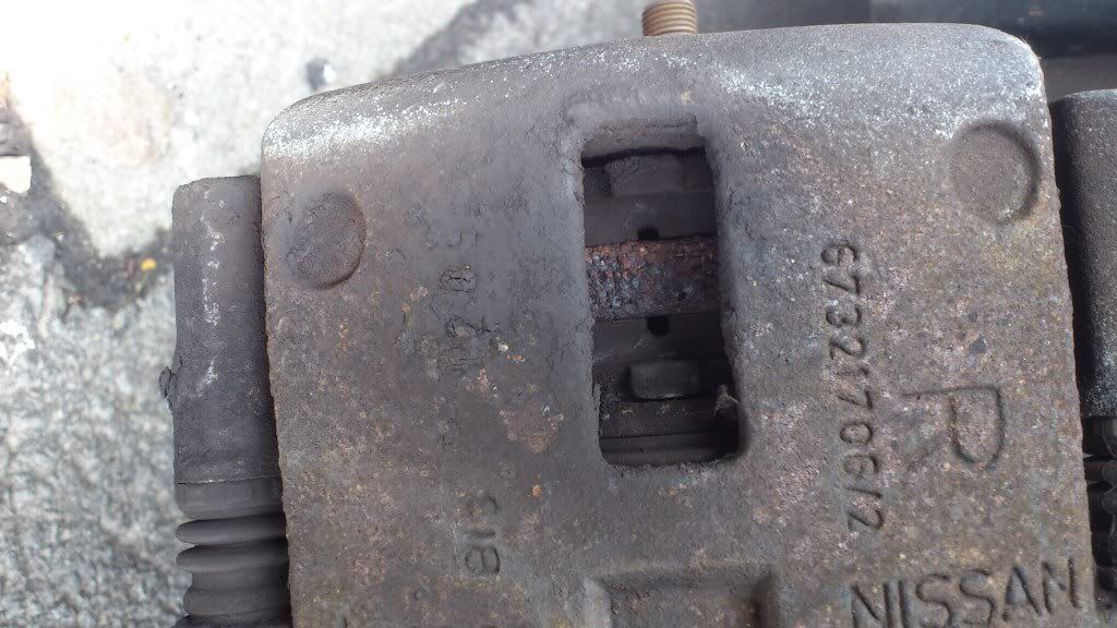

Brakes - Can somebody look at the images below and tell me if my brakes are ok? Not really sure how thick the pads should be or how to guage it? Also are the disks ok, they're scored and I thought this was a problem? My breaking feels spongey at times, like the car will slow to a point then I really have to push the pedal down? The picture of the pads is with no break applied at all, I thought there'd be a bit more clearance to the disk then that? seems like the pad is right on the disk?
As I think I've metioned earlier, when under the car I've noticed a few things. First is I seem to be leaking fluid from what I think is the master cylinder or is it something to do with the steering?
(That pictures uploaded upside down for some reason?) Anyway, it's on the bulk head, driver's side and I do have dampness in that wheel arch too but all gaitors and joints seem fine, and though something is clearly leaking, I don't appear to be losing any fluids, break, steering or otherwise... or at least not noticable amounts?
Something I also mentioned earlier was some kind of oil residue near the oil filter which I couldn't track from anywhere. Picture taken before I cleaned the area to keep an eye on it...
Finally, passenger side, just behind the arch, sort of foot-well area I appear to have some sort of dampness/stain that again I can't attribute to anything? Any ideas?

you can usually test a wheel bearing by holding the suspension leg while spinning the wheel (you will feel vibration if the bearing is worn)
and is the leak from the steering rack
I don't know what the leak is from to be honest, but it's worrying me!?... The wheels seemed very "gritty" going around... unfortunatley I didn't know to hold the suspension leg when doing it?...
