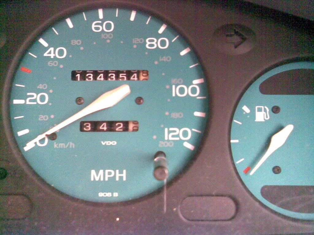

ran out the fuel today on the mileage below
no light came on, have to change in the good ol slx sender unit
sure it can can over 400 miles
It can do over 400 miles, just depends on the driving and conditions. City driving I find a tank gives me about 350ish too. Did work out though, my petrol light came on other day and I filled her straight up. Took 36 litres to fill her, they have a 42 litre tank so petrol light (on mine anyway) should come on with around 6 litres left, which I calculate to be about 50 - 57 miles depending on driving of course...
This will vary on model/engine size obv. Mines a 1L '99 Face-lift...
Hope that helps?

Update: light does work! It came on after being sat on red for a while. Gave me 12.5 miles before spluttering to a stop. I always thought micra tank was 35 litres?
