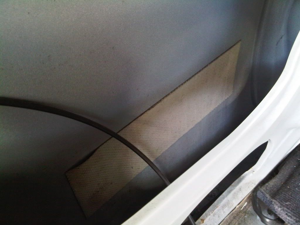

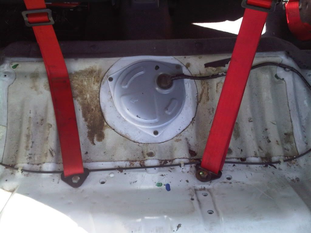

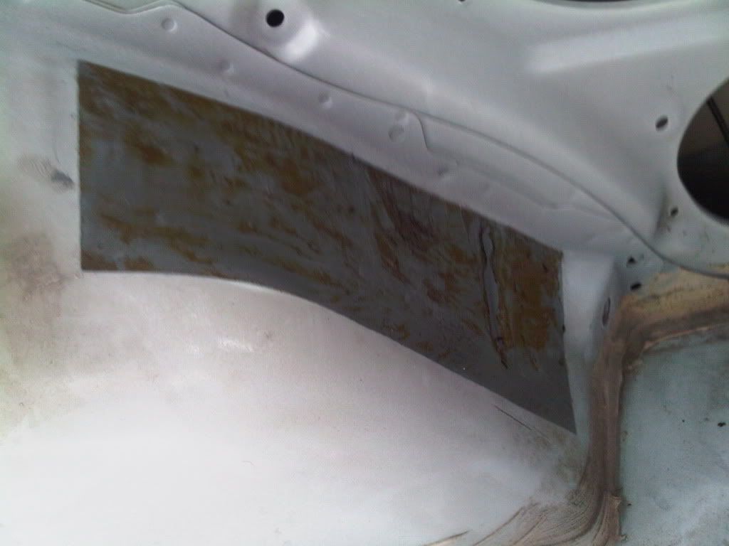

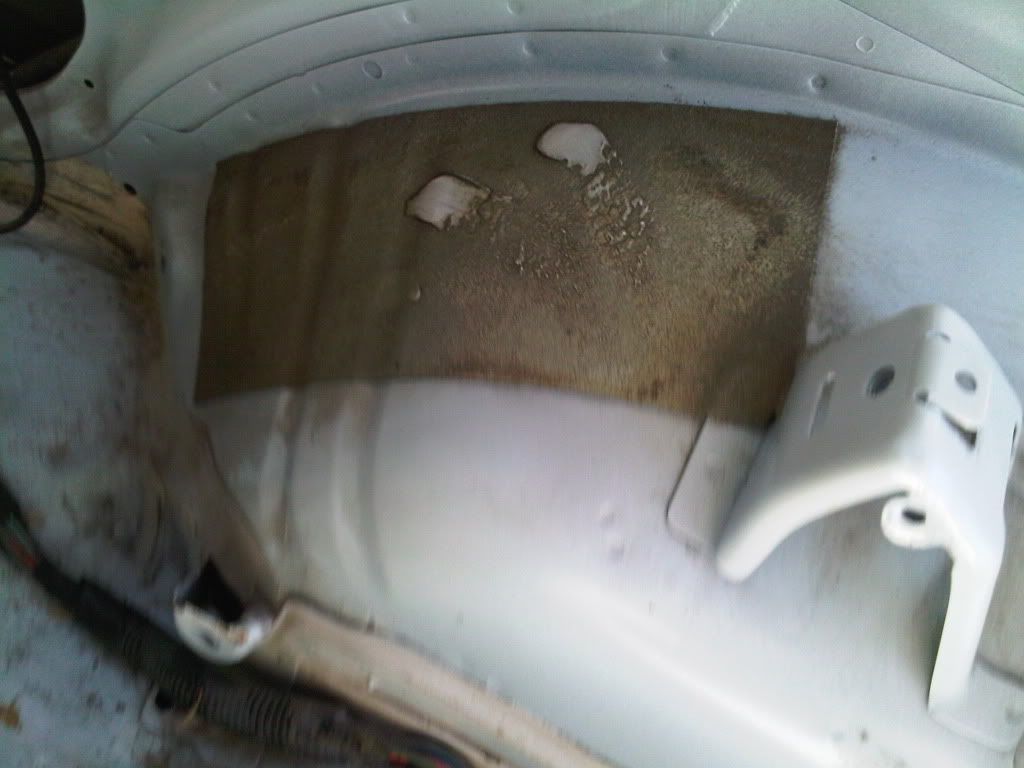

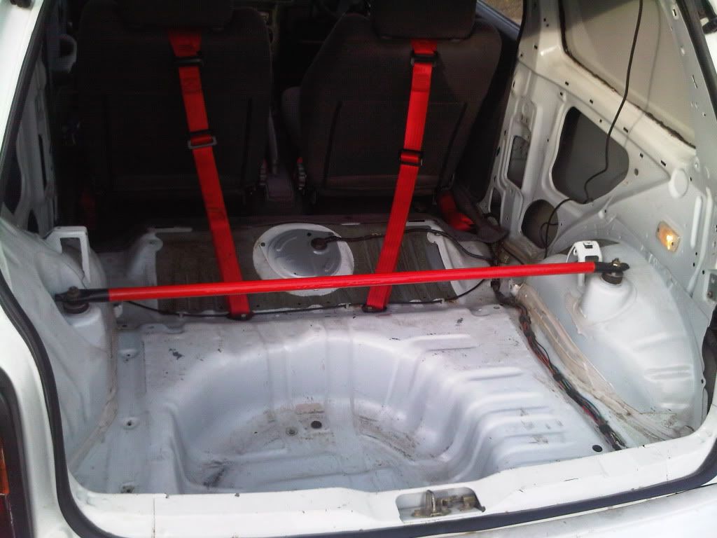

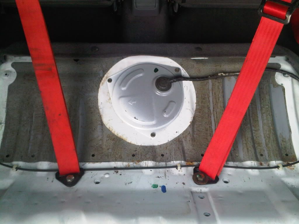

After doing that it was the rear sound proofing to go.
Before, small amount on the rear arches....
This is whats underneath the rear seat....
These are behind the rear quarters...
Took me a while to scrape it all off with a scraper and a slight tap with a hammer and ended up with a sore hand:doh:
This is what i was left with after...
Probably took a few 100 grams off its a lot of hard work just to save weight!!!!!

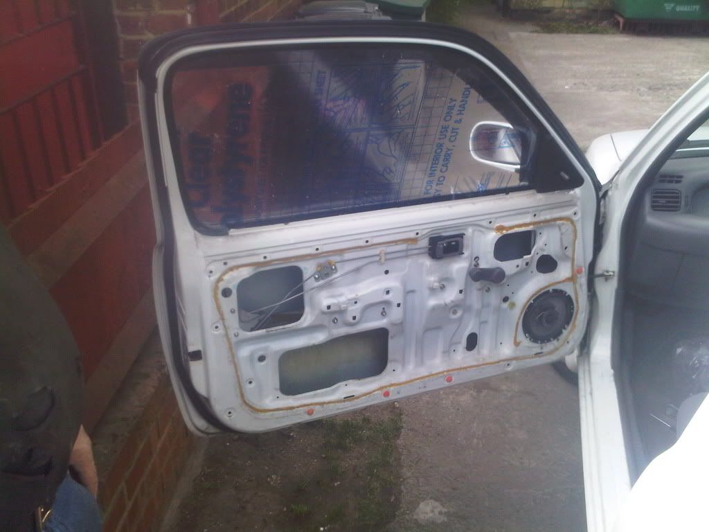

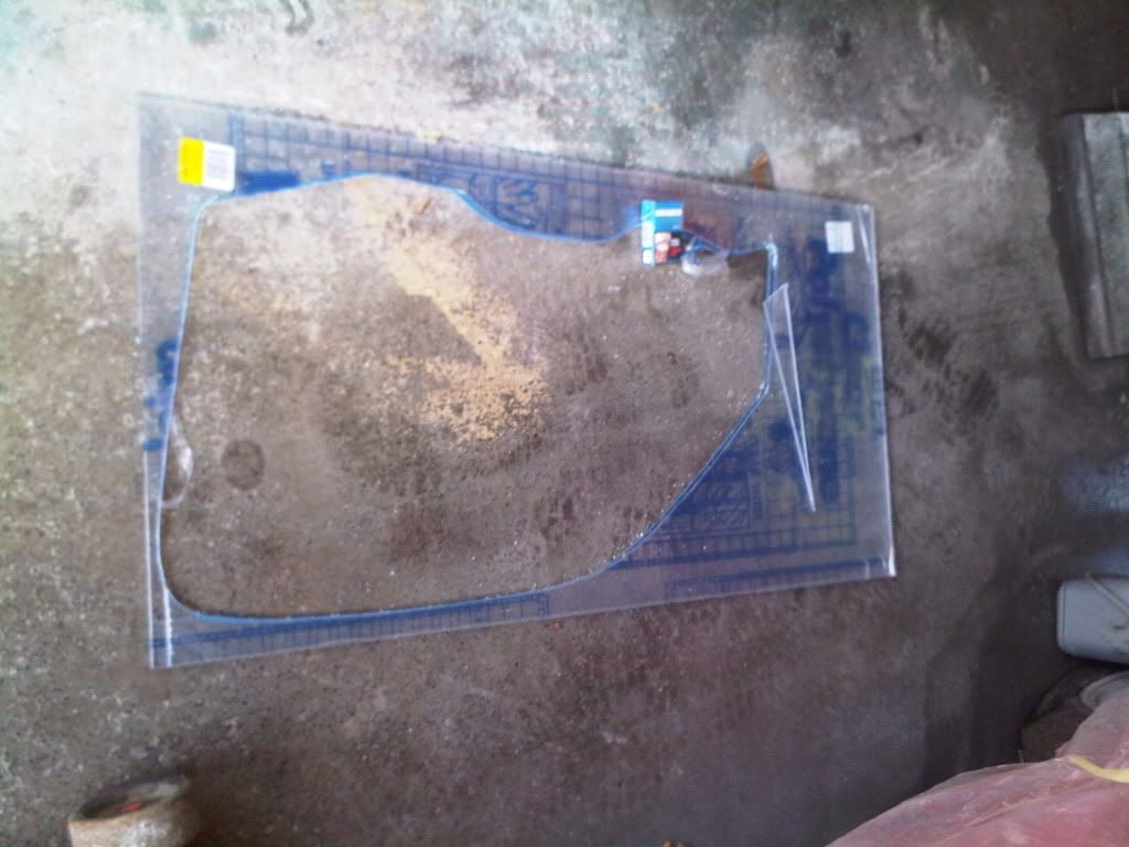

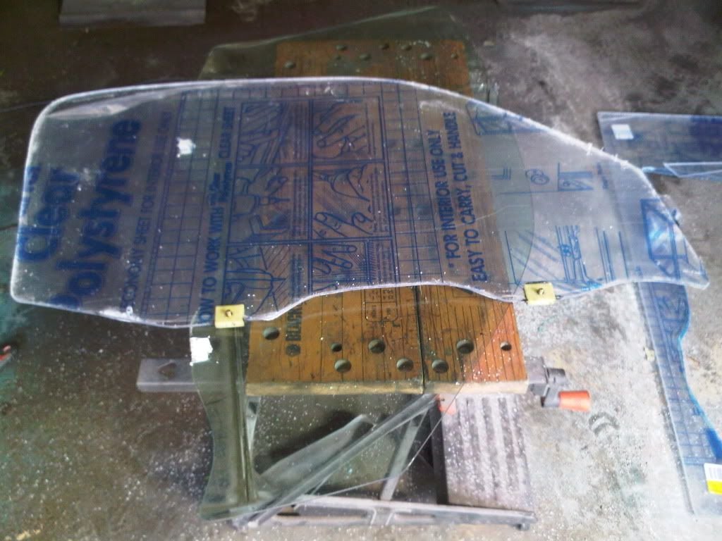

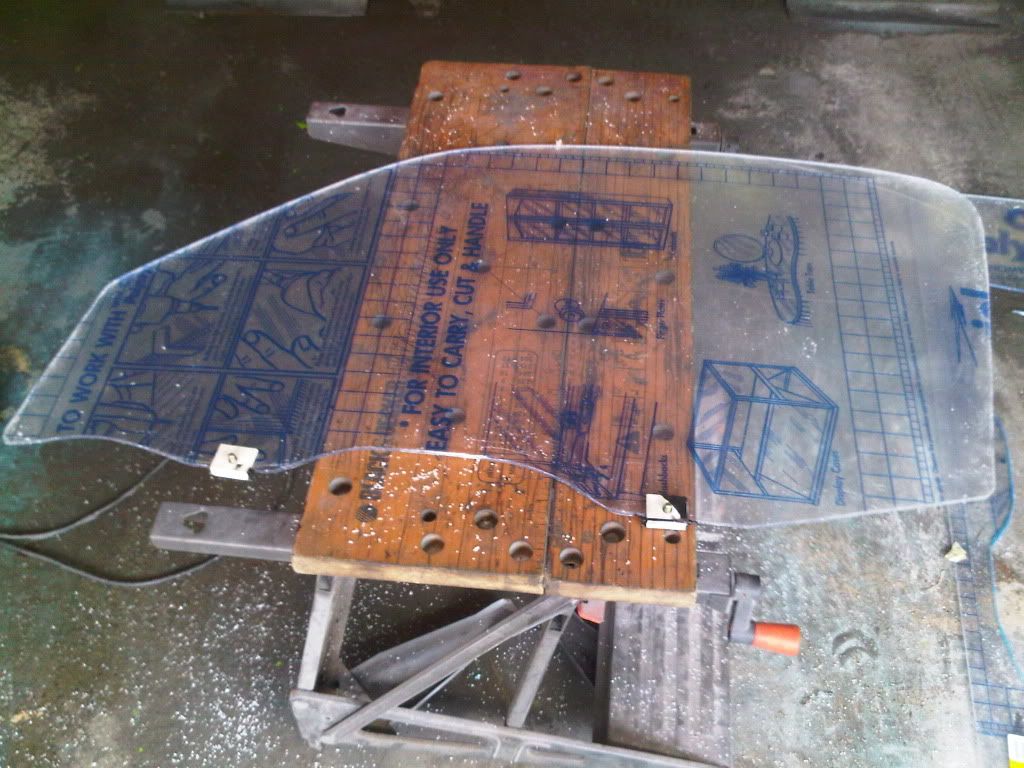

Today i decided to perspex the 2 front windows so after a trip down to B&Q £45 later i was the proud owner of 2 pieces of perspex 4mm thick! Took the glass out of the doors, drew round it and cut it out with a jigsaw very slowly! Half way round the blade got hot and started to melt the line i was cutting (not the end of the world with some sand paper)
Here are the results....
Drivers side
Passengers side
The waste material

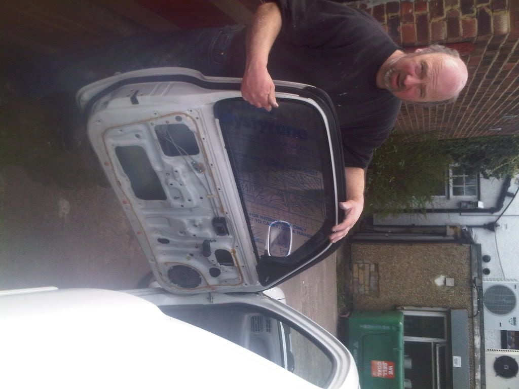

Fitted
And Darcy standing proud in front of the new light weight front windows!
The weight differnce is quite noticable with no scales not sure what i have saved but a cheapish and quick way of saving some weight....
I had to seal the plastic clips to the perspex and found it quite hot driving back home without having the window open otherwise the plastic will come off the clip and cause me problems.

And notice my new front windows... they don't look any different at all to the stock glass ones!

Cheers Manny- very pleased with how they turned out and yeah i have taken the film off just left it on for the photo, looking out of them is just like looking out of normal glass and being 4mm thick they aren't flimsy and quite strong to bang and hold up it the wind.

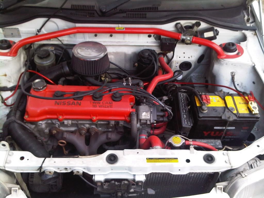

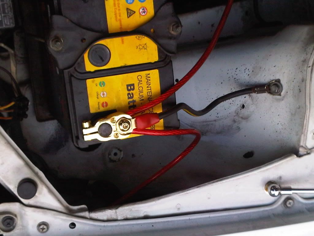

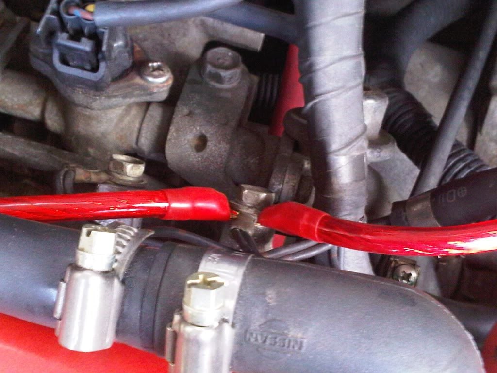

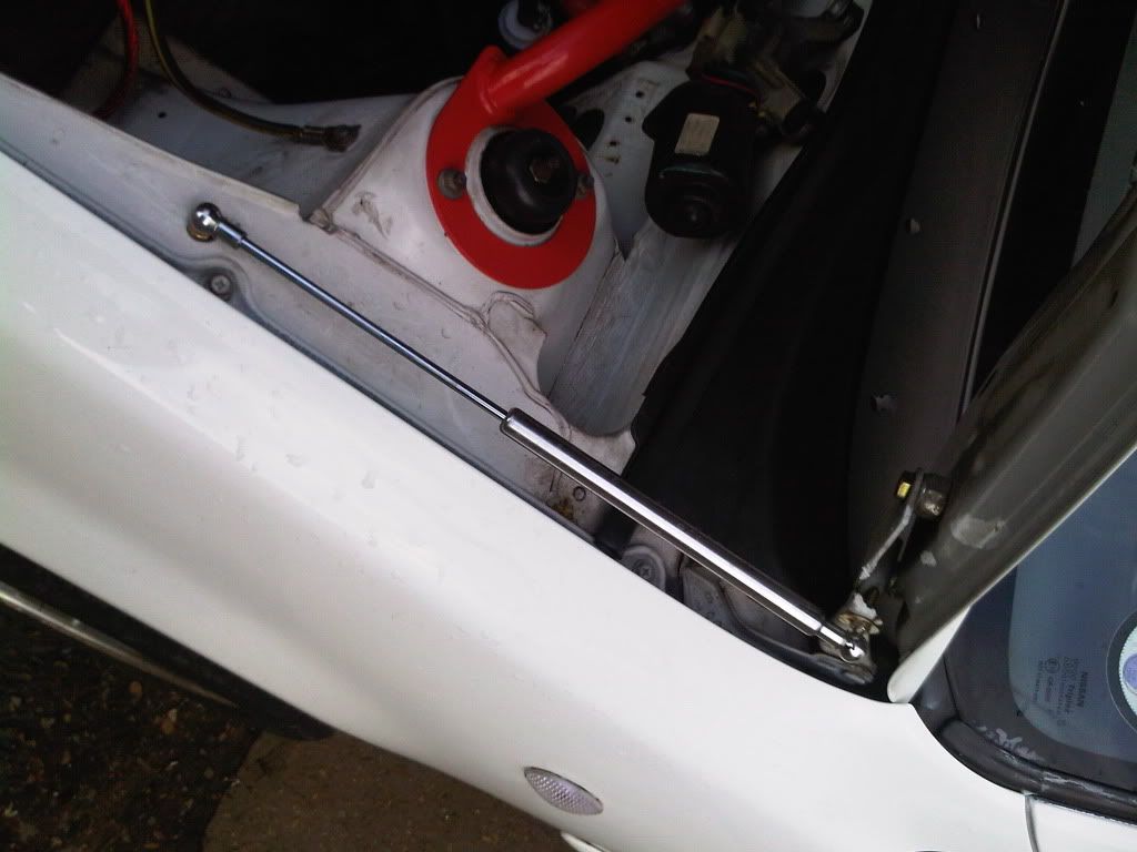

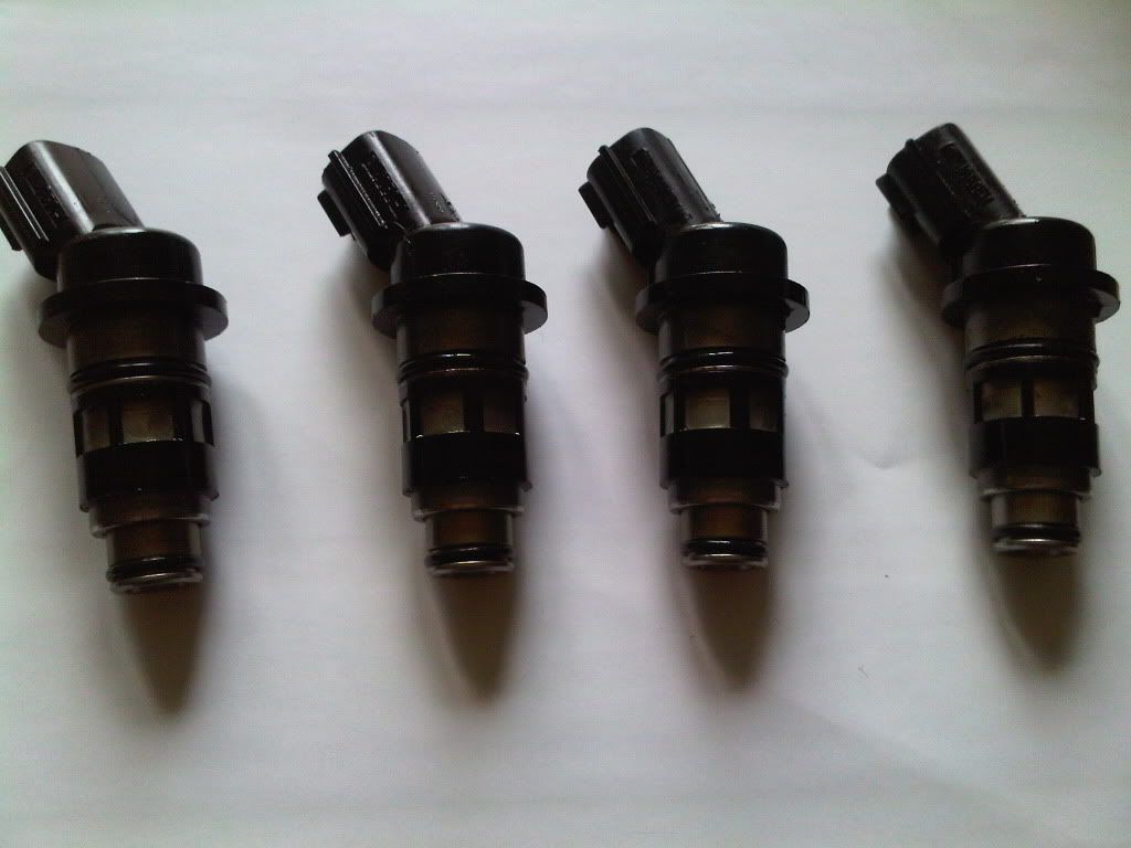

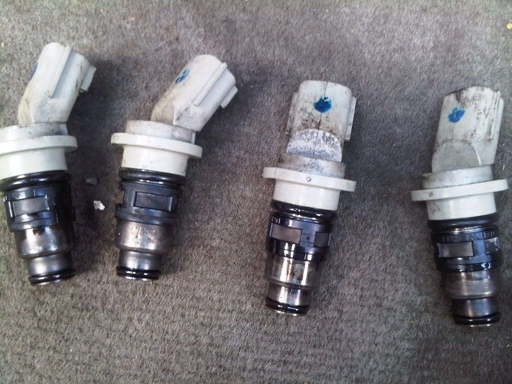

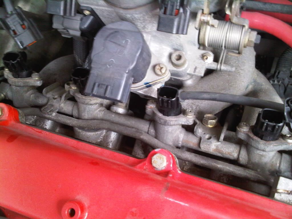

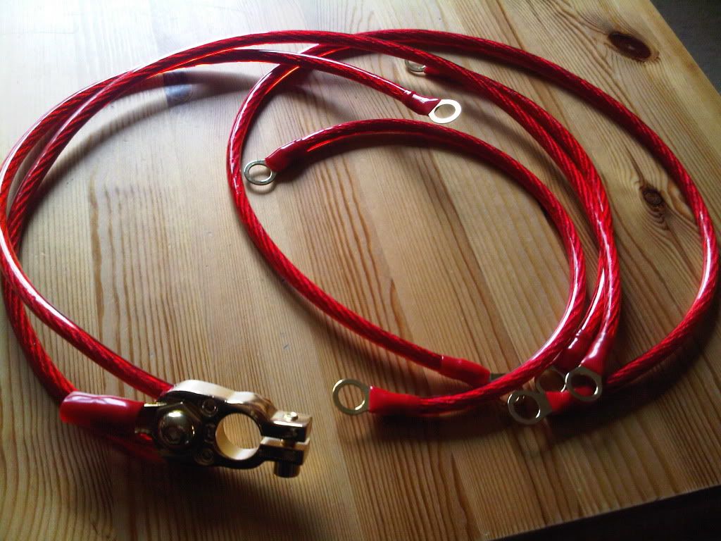

Been a while since i have been bothered to do anything to the Ferrit mobile, so had a kick up the backside and fitted 1.6 injectors, extra earth straps and bonnet lifters and turbo styled the bonnet. Extra earth starps to give better response, 1600 injectors for extra oomph and turbo'd the bonnet for a bit of style, it was a very cheap mod (few nuts and bolts laying about!) and also lets the hot air out of the engine bay quicker!
New GA16 (black) injectors
Old CG13 (white) injectors
Fitted in the fuel rail

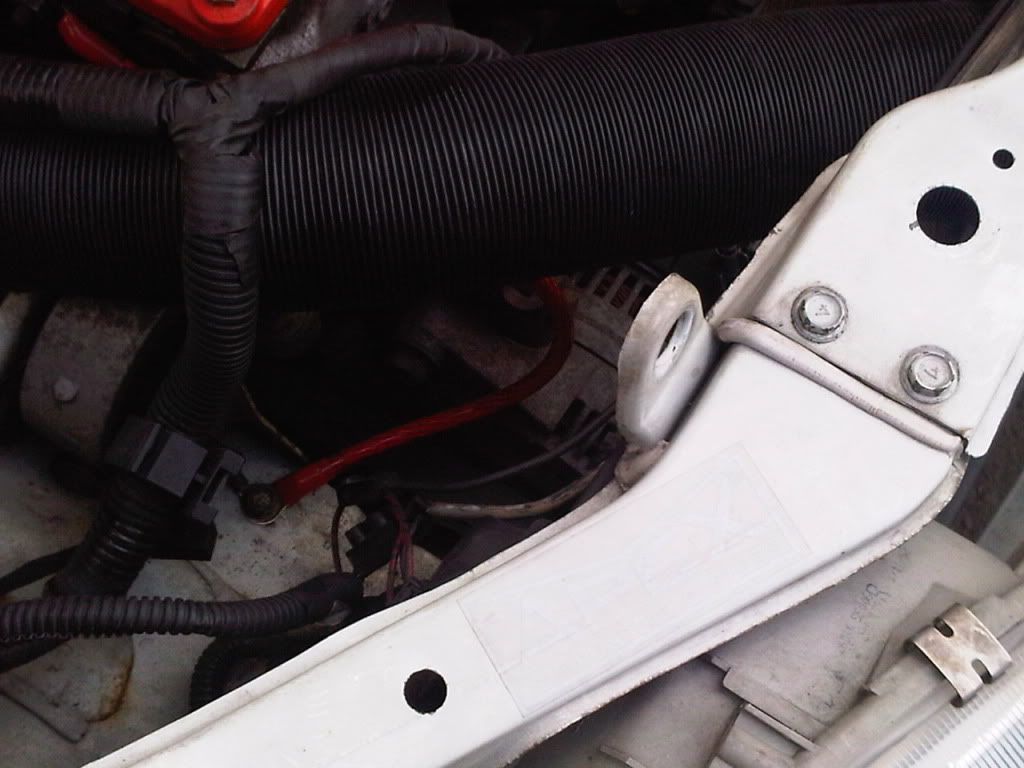

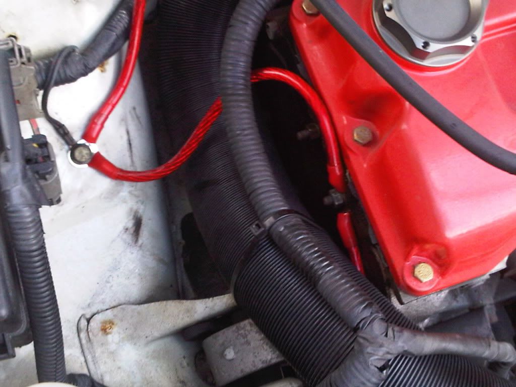

Earth straps in red (i know thats positive) because of the red theme under the bonnet
Start from behind the nearside headlight and negative battery terminal
Run it round the back of the engine and connect it to the block
A few different connections on the left hand side of the engine bay, back to block then body again.
And finally finish off behind the offside headlight
All the original earth on the car were very rusty so cleaned those up by sanding off the rust back down to the shiney brass, some of the 10mm bolts were also very rusty so just replaced them with cleaner ones.....
Nice new shiney bonnet lifters, had to cut away abit of the hinge because when the bonnet was closed it slightly bent the lifter.
The engine bay after all my hard work YAY!
A re-map is on the cards next, along with a bigger exhaust and some more subtle weight reductions.

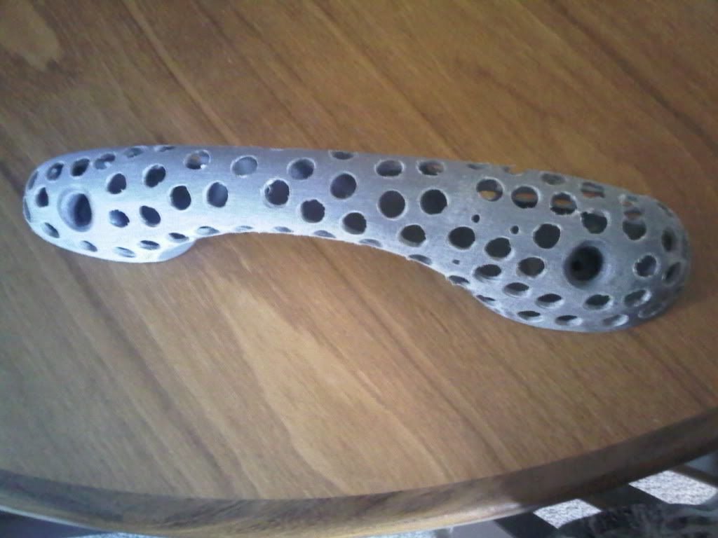

Got abit bored this afternoon, so decided to lighten the already lightweight door handle.... how [email protected]! drilled alot of 4mm holes spaced out then opened them up with a 13mm bit. Saved about 50grams but it all adds up!!! Going to spray it black before fitting.
