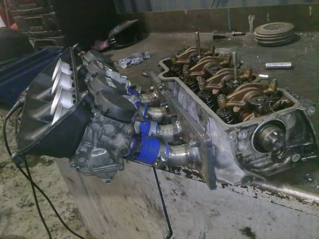

Im hoping my ma10 engine im building should be a quick one.
Dave walker head:
#mega skim
#ported
#kent valve springs
custom cam (dunno duration)
cbr600 bike carbs
4 branch exhaust manifold
3.5kg flywheel
Dave walker head:
#mega skim
#ported
#kent valve springs
cbr600 bike carbs
3.5kg flywheel
i think you may get over the 100bhp mark with that lot (Y)
Dave walker head:
#mega skim
#ported
#kent valve springs
cbr600 bike carbs
3.5kg flywheel
I think it will have arround 105hp or a bit more, depends on the skim. Also if this car should be your daily drive and you use the lightened flywheel your cam should not be more then 296° otherwise ist would be undriveable. It would be idling really bad.
RTLkyuubi
It doesnt idle atm with the kent cam and non existent auto choke lol
Well it's about time we found out then :p
Go For It!! (Y)
Just gotta find some pipe for my inlet manifold and then an exhaust manifold and it will be going in
It's possible. But the engine will not last 60,000miles ;) that's clear.
Well its going in my daily so will have to see how many it will do. the engine ive built had 150k on the clock and the bottom end is untouched! just checked lol!
