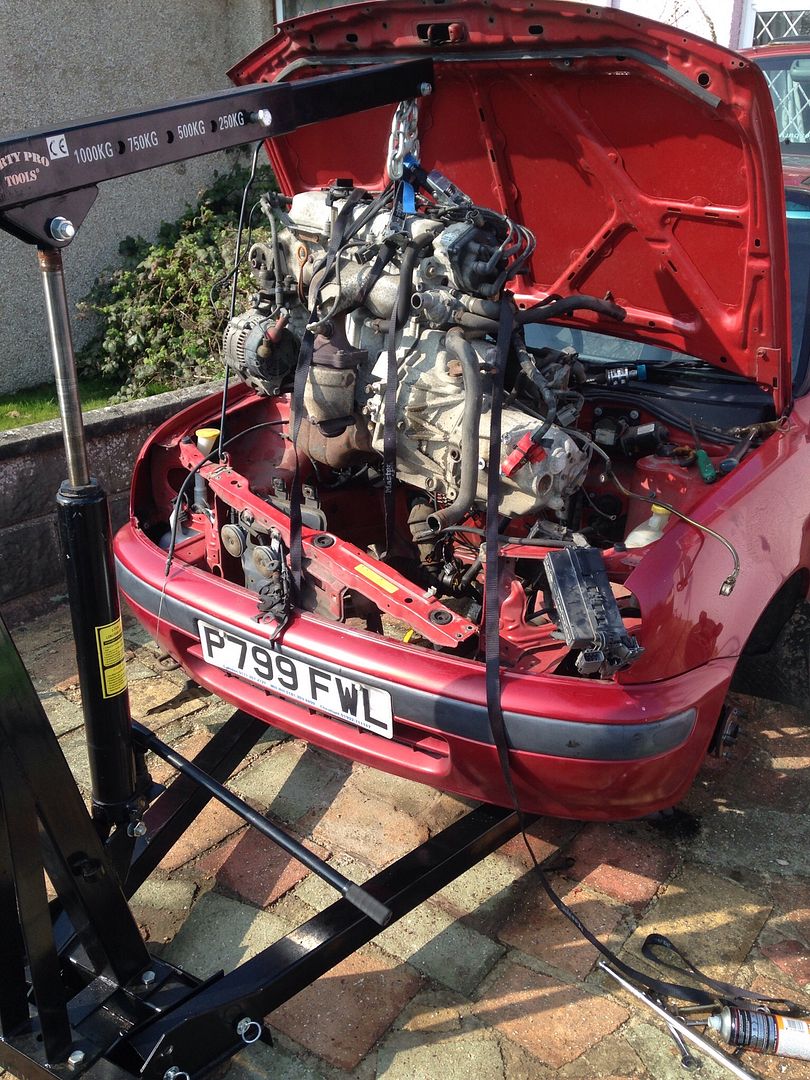

engine hoist pfft :) just hump it over the cross member
You can see where I bolted the lifting bracket too. There was an identical one on the other side. Using these two points keeps the engine level. The other red strap was used for adjustment due to me removing with the gearbox, so altering the pivot point.

We used a hoist. The only picture I have is a selfie with my CG13 from the Super S ...
Not even ashamed!
