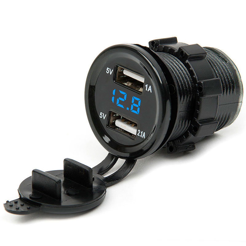

Finally got round to fitting a charging port to the K12 today. I got this for the princely sum of £2.99 from an ebay seller in the Phillipines.
It arrived today (after only a couple of weeks) so fitted it straight away.
The lower dash panel to the right of the steering wheel had a spare switch position so fitted it there...
I used one of these piggy back fuse holders to get the power feed from the fuse box directly below the panel......
and picked up the earth from an M6 bolt that secures the OBDII socket support.
