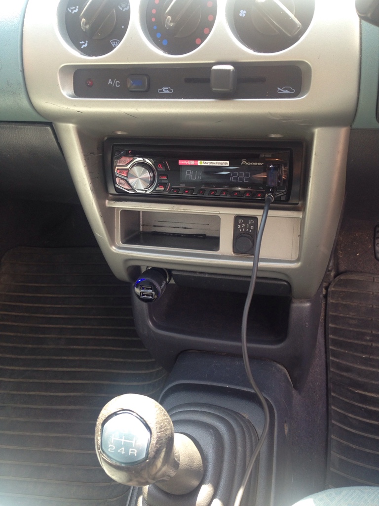

You've got aircon, power steering, central locking, electric windows. How good is that.
