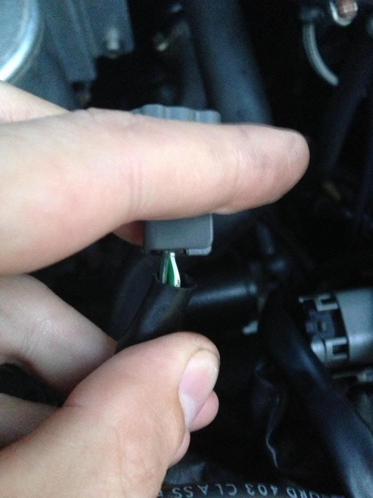

Hi guys, can anyone tell me the color / location of the negative coil wire on a K11 dizzy?
Don't have a manual to hand unfortunately!
I think it may be the white and green striped one

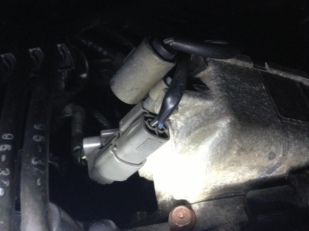

my tacho wire was blue paul, on the smaller 2 wire plug
Thanks for the info guys, from looking at the coil plug it looks like the white/green wire connects through to the blue. So i should be able to take a take off from either side :)

For anyone else needing the negative coilwire it's the Light Green / Black wire :) (also the blue wire on the opposite side if the coil plug)

It did on mine, btw car still runs if the connection is broken(if your tacho breaks the car would still run), somehow... but gives an error code, seems the ecu monitors the return from the coil. You can intercept the wire closer to the ecu of it's easier for your wiring.
