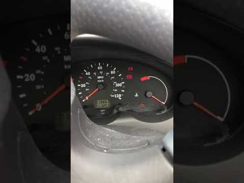

Rather than the “click” of a failed starter, the car actually tries to turnover once before stopping, as if the starter is jammed?
video here (notice to hilariously low mileage for the age of the car ! )

Sounds like low battery charge. How old is the battery? You could charge it first then have it tested to see if it is holding a charge. But, first & foremost, check all wiring connections to battery, starter and chassis earth strap. They must be clean & tight. The starter motor is best accessed from underneath the car and not particularly easy to remove & replace (you may need an assistant). Don't forget to observe safety precautions when jacking up and working underneath the car.
