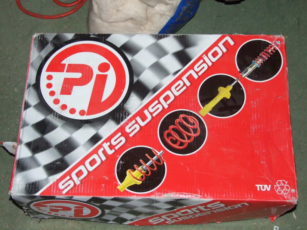

Hey guys, just a really quick one. Is it possible to cut PI lowering springs? I currently have my K12 sat on the PI springs that take it down 35mm with some 16 inch bbs reps and the arch gap is really annoying me (more than it should) is it possible to chop these coils or not? Will link them below :p
http://www.ebay.co.uk/itm/like/1604...f11=ICEP3.0.0&ff12=67&ff13=80&ff14=108&ff19=0
(I just included the links/pictures if you needed them for reference). Hope someone can help, only looking to chop around an inch, maybe an inch and a half maximum as I don't want to be slammed.
