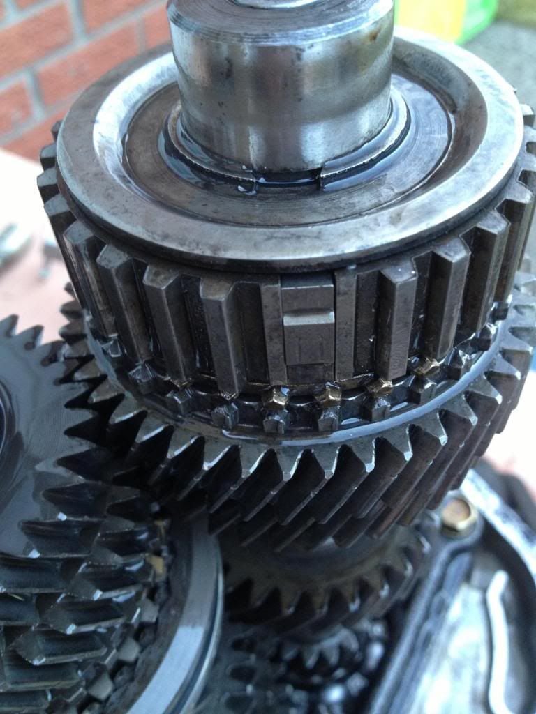

Lol ive been messing with it for last 20 mins, it seems that if i select each gear and turn the diff that in 3rd and 5th i can continually turn it. Any other gear just locks......

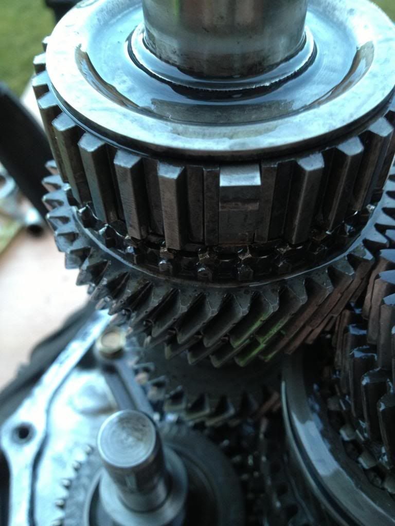

Hmm heres what ive found

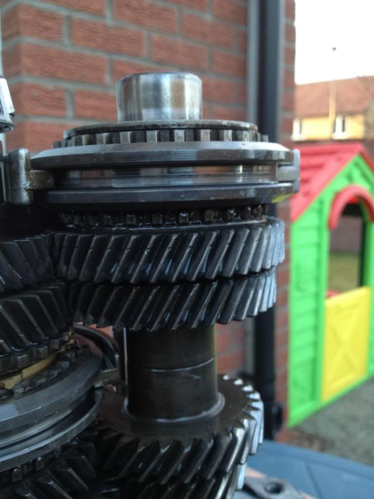

This is 5th gear in neutral

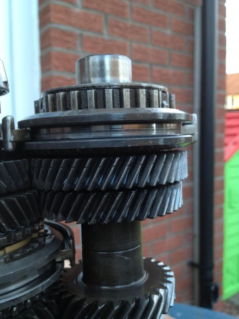

Then 5th in gear

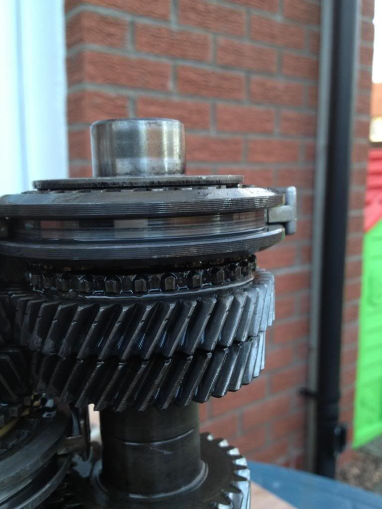

Then back to neutral (what are the chances?)
Now if it is this that would explain the 20mph wheelspin when on axle stands and the stalling when engaging the clutch and it being difficult to select other gears because its already in a gear?

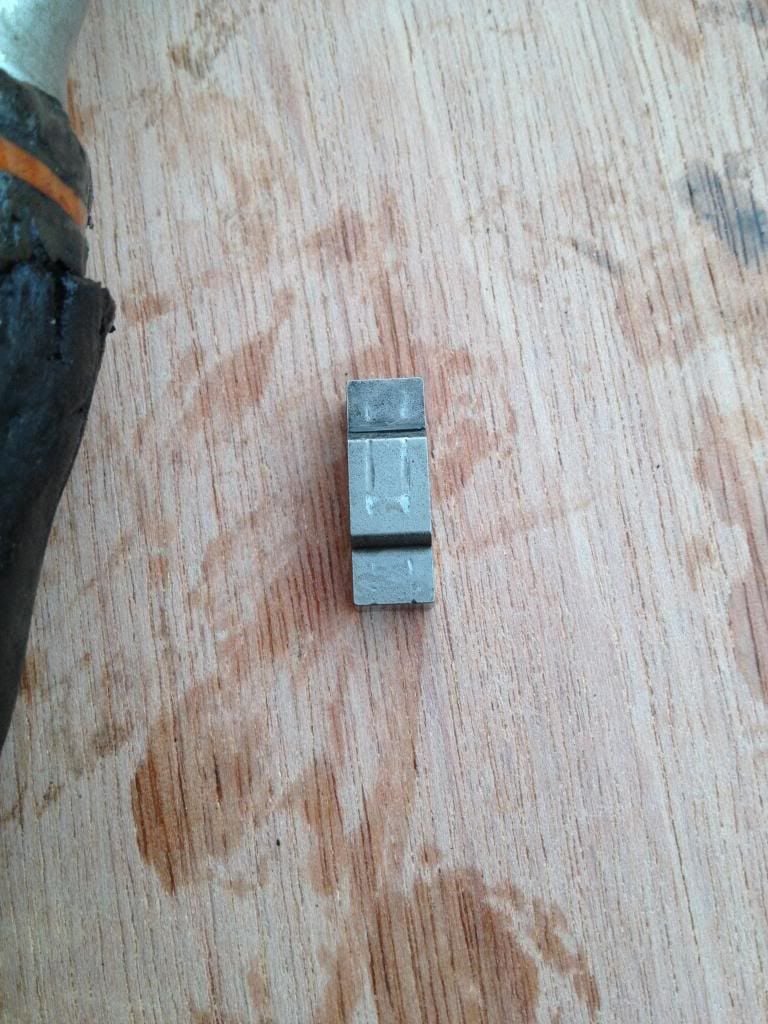

Is this a pawl frank? Theres 3 of them and i found that 1 isnt sprung.....
One that is sprung
One that isnt sprung
Thoughts?

I had a similar issue on a rover box and it was caused by a sticking 5th gear syncro, sounds like your issue could be similar....
first the synchros.
with the bare gear shafts, move the synchro by hand. you should be able to slide it on fully to engage a gear and when you pull it out of gear, it should 'click' back into neutral position and the ball checker should hold/secure it's position.

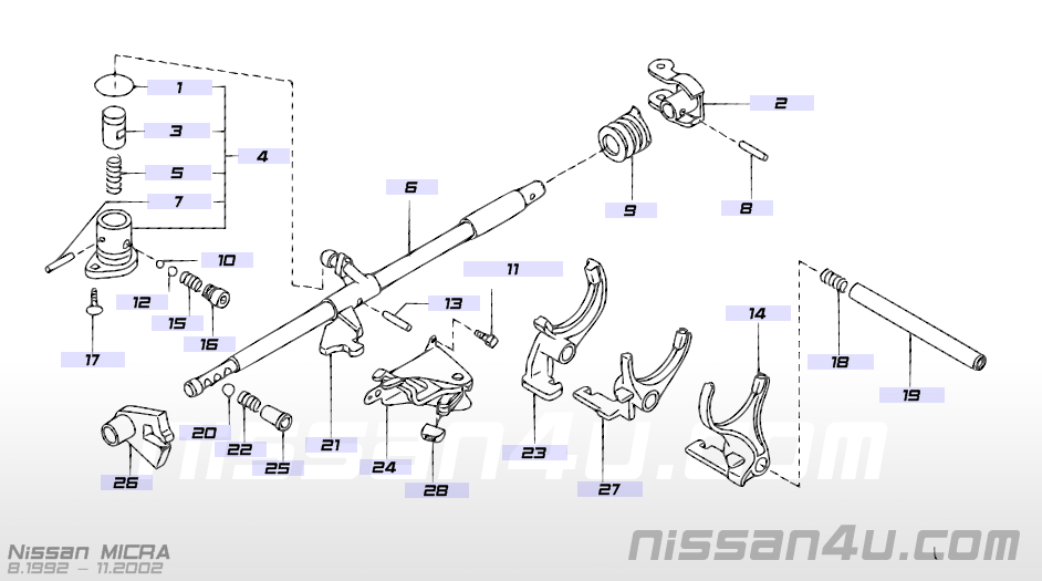

next most important part that's easy to mess up is the selector gate assembly (24).
-all the synchros must be in their middle neutral state,
-slot the shorter 1st/2nd selector fork arm (23) into the selector cage (24) (obviously cos you can't fit that arm with the cage in the way).
-NOW its important to make sure when fitting the cage onto the bell housing that all 3 selector fingers in the cage are held in neutral and the selector 'striker' peg (21) is located within the 'slot' of the middle finger.
- still keeping the fingers equally in neutral, fit the middle fork (27) and the long fork (14) and the shaft fork (19) to hold it together.
- slide the reverse cog in place and insert the cog axle
- now if done right, you should be able to easily turn the rod in neutral between 1st/2nd and 3rd/4th and selecting 5th/rev should only require slight force pushing against the sprung check spring (4). if it doesn't turn easily between left/right, then the fingers weren't in neutral during fitting and is out of position.
- holding the two shafts steady, engage all the gears and it should feel and appear to engage positively as expected.
- whenever the selector goes into neutral between gear changes, the synchro is moved into neutral and the ball should hold it in position. if you see the previously selected gear synchro 'sag' and unexpectedly slip towards a cog (like the 5th gear synchro pic) while you turn the rod to select one of the other 3 selector fingers, then the synchro ball checker isn't working properly.
next, whenever you push or pull the rod to engage any gear, it is held/locked in place by the selector rods sprung ball check (20) slotting into 1 of the 3 groove valleys at the end of the rod. if a gear isn't fully engaged (whether misaligned fingers or driver error), the ball check won't be fully slotted into the valley to resist back/forth movement, hence could pop out of gear.

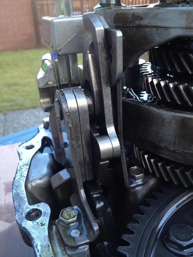

Thanks for that paul, i am sure it is 5th gear causing this. It doesnt click back in place like the rest of the gears do. Heres the selector gate assembly, i am very confident its correct
yea all the fingers n gates look matched, so I'd investigate why 5th gear synchro isn't staying in neutral. missing or sticking ball spring?
Are you talking about springs on the shaft? As above 1 out of 3 pawls doesnt spring out which could potentially jam the selector?
yeah the 'shift insert', what's beneath the insert? spring?
according to nissan4u, 3rd/4th and 5th gear synchro uses the same 3 inserts but 1st/2nd is a different part #
I suppose all 3 inserts should be doing the same job equally all round the synchro ring.
if the shaft to synchro gap is tight, the unequal force could jam the spline.
if the gap is loose enough, the slack insert could allow the whole synchro ring to shift offset, relax the other 2 insert springs = less ball spring locking force = ring not held in place.
logically whats the point of having that 1 insert unsprung just to rattle about loosely with no purpose?
