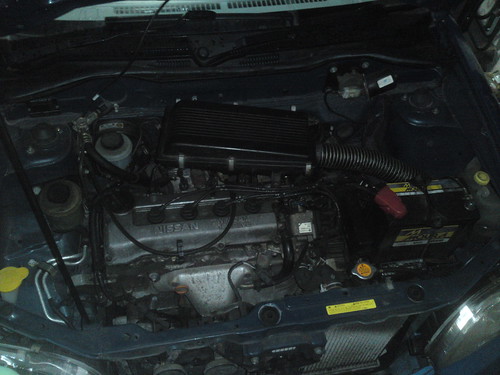

I'm looking at improving the power in my 1.0, I've already got 1.3 cams a ga16 airbox with k&n filter and I've removed the rev limiter which is a nice little combination for unlocking some power in the 1 litres, but I need some more. I'd like to do a 1.3 conversion but most mechanically challenged thing I've done is change cams, so I'll play safe and stick with bolt-ons for now -which would be good as they'll still be useable when I get around to fitting a 1.3.
I've done a lot of reading on here and it seems like some reprofiled cams would give me the best bang for me buck, but with it being a daily driver I'd still like to keep some low to mid power too, which is where the mani should come in useful. Teamed up with a lightweight f/w it should create a nice little high/quick-revving little package.
But I need advice on where I should go for parts. What weight f/w is best for fast road use? What cams would suit me and the car, and what information I need to know to get them reprofiled? I'm also thinking of just reprofiling the inlet cam -keeps cost down, and the 1.3 exhaust cam on the 1.0 should already be adequate enough?
