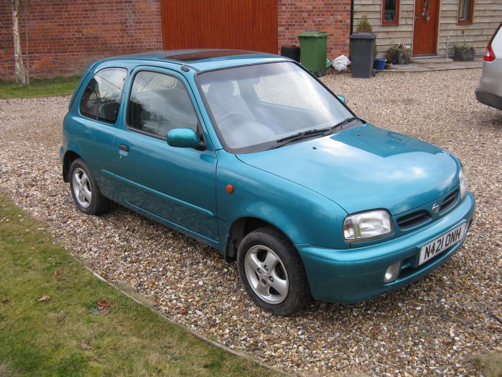

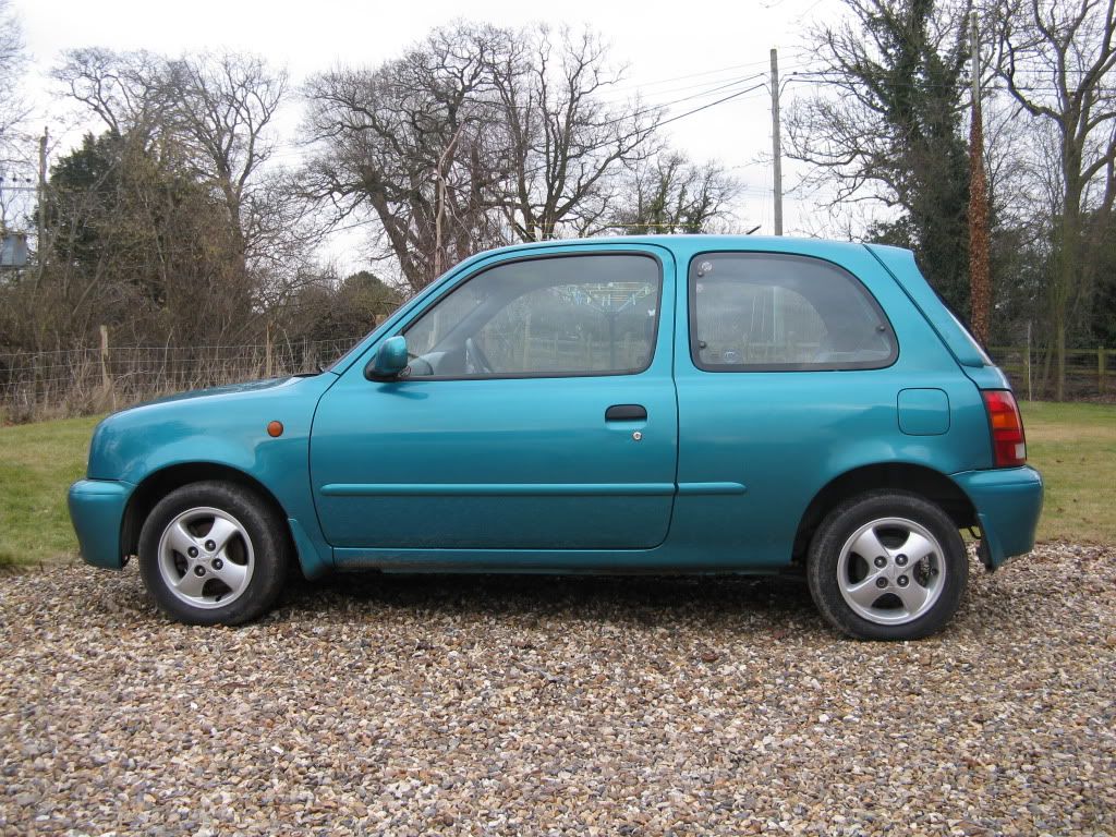

So I finally found her on the 1st of February 2010, a loooooong 5months after I set about looking for a decent SR.
Went to go view her after I got a second chance offer on ebay, travelled 70 miles up to Derby and took her on the spot for £375. Personally although she has no Tax or MoT and has a few other problems I think it was a steal at that price!
Ok so the good points;
Bodywork is pretty flawless, only one or two tiny trolley dinks.

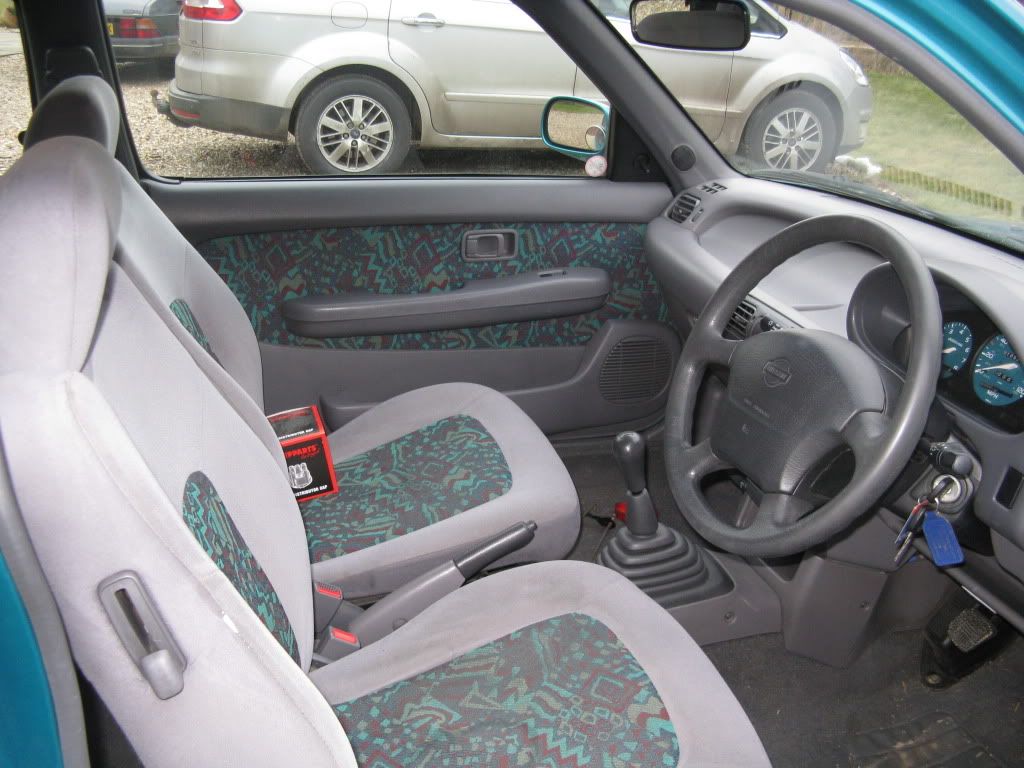

Interior is like new other then a small area of unstitching on the drivers seat.
All alloys are in good condition along with the tyres + there were 2 spare SR alloys with the car.
Starts first time and drives well (as far as the clutch would take me)
Brand new battery
No rust on the front cross member and none on the sills as of yet (I know this means its likely I will have to pay for it to be done in the near future but the way I see it atleast I can get it done well and how I'd want it, saving as much of the original paintwork as possible.)
The not-so-good points;
Very noisy timing chain! (not yet had the chance to look at it but fingers crossed its just tensioners)
Clutch barely excists (New LUK clutch ordered this afternoon)
Mileage is just over 100k which is slightly higher then I was looking for but we all know how well these engines last!
Small area of rust (bubbly paint) on the rear drivers side arch.

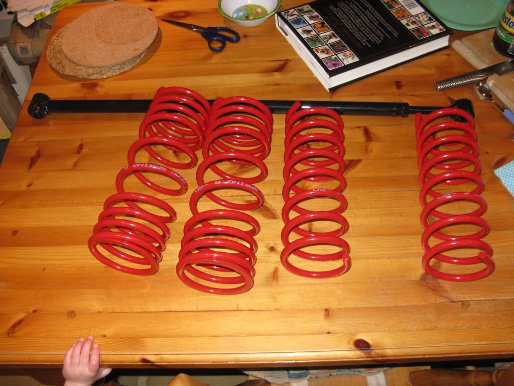

Lower by 60mm (springs and panhard rod ordered from MPH (thanks Matt) this afternooon)

60mm Lowering Springs
Great service from Matt Humphries! Ordered 2p.m yesterday, arrived 11am today! Thanks very much. Will make sure I get some good before and after photos!
no probs mate, and how much are the springs of matt, and can i just straight swap them for the ones on my car and use the original struts and it will lower it, my blog is on here somewhere just put cjfords k11 n should find it, i need some advice on what i could do with it, after some alloys and a backbox but cant find anything anywhere close by. and does this mean you are goin be selling your sr alloys if ya might be getting some new ones haha :L :), cant wait see what you do to it.
Springs were £310 posted. So quite pricey but definately worth it! Their a straight swap for the originals and yes you can use the standard struts. Ill have a look as soon as I can. Yep SR alloys will be for sale as soon as I get round to purchasing some others. Have you had a look at the Janspeed from Matt humphries? Or maybe try C&P Motorsport?
£310? Erm, I'm assuming that's a typo. Matt's the man if you want things quick, I never use anybody else for k11 parts. As for the manifolds, don't be swayed by low prices from people like Roadrunner, Micrasport or C&P, Matt's Janspeed manifolds are the best available and of superior design........they're also the only ones available in stainless if you have the cash. Also since you have a lot planned I would highly recommend a remap from Ed at Fusion once it's all together......it'll finish it off nicely and make passing the MOT a sinch ;)
Sorry £310 for 60mm springs and adjustable panhard rod, thats VAT and delivery included. Yer I was really impressed with the service! As for the manifolds Matt again was my first thought. A re-map could be a good thing for the future. I'll have to see how quickly I can acquire the other goodies first.

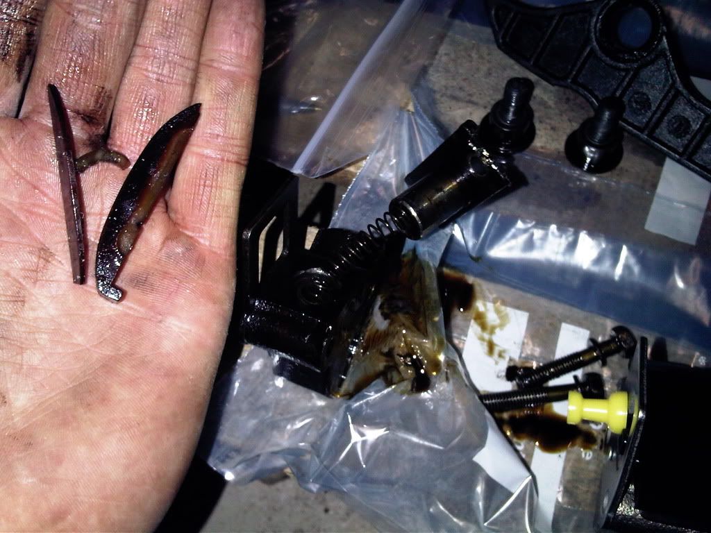

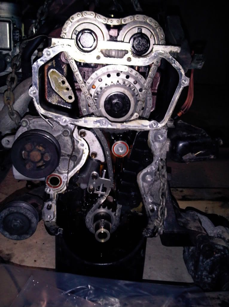

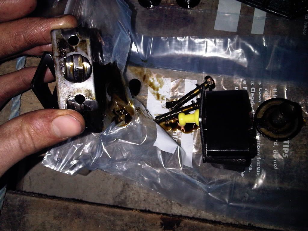

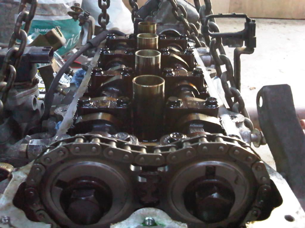

Small update. Timing chain is cooked for good, started taking the block out on Thursday evening. Almost ready now just need to split the block from the gearbox.

oh forgot to add --- are they pedals in the passengers footwell? look in the first pics posted? was it an ex learner car?? Thats probably why theres no clutch.
Gunk it is then. Seems cheap enough eh :D
Thanks Ferritboy. Yeah forgot about that! It was supposedley a learners car for about 6 months before it was put of the road because of the timing chain. I suppose theres good and bad points to that. Bad in that the engine would have took some added strain for a while and as you said probably what caused the clutch to go, but on the other hand its good in that its been maintaned and kept clean for that time.
As for the instructors pedals, does anybody know how theyre connected? Not had the chance to look yet.

All the clues pointed to it being a learner car!! I think the pedals run behind the centre dash and connect to the primary pedals some how. Easy to disconnect for u collision. And would be worth putting on ebay I rekon they are worth a couple of quid, might fit other cars....

Continued splitting the engine and gearbox this evening, sorted it all slowly to make sure I knew precisely where each bolt lived (the old cardboard cutout technique) and then I got round to the rear gearbox mountings and remembered the freaking sheet of metal that seals the two! grr
Now I have to go through the lengthy process of taking the nearside hub off just so I can pull the driveshaft out! (Ive try'd Franks method of popping the CV joint out but I just cant seem to crack it.) To add insult to injury the Socket I borrowed to undo the nut has only been returned to the owner so now I have to wait until Wednesday to carry on. :(

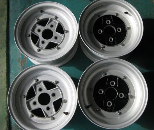

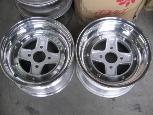

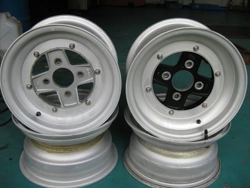

Ive decided to import some second hand SSR MK2's hopefully using 'Jesse' as the middle man. Now these wheels are very wide so theres definately a set of wide arches on the cards. Im hoping the arches will actually cover the rust on the rear arch so I'll be killing 2 birds with 1 stone :D
Pics below, there the same as what 'Solarice' has, however they wont be that colour.
Comments? Do you guys think its the right choice or not?
The above are 14". Not sure on colour, think I will decide once ive done a trial fitting, but Id maybe like to do something a little different with them like a black rim maybe? What dyou think?

First thing to do was to change the clutch. Simple enough. Noticed the previous clutch was also a LUK one so I take it its already been changed once in its lifetime.
Second was the timing chain, bit more complex, had a little trouble with timing the correct links up given that there was only 1 coloured link on each chain! (Not the 2 and 3 that haynes says there should be). Got there in the end with the experienced help of Frank! Soon realised what was making all the noise though, take a look at this tensioner. The chains actually started to char through the metal :eek: . I managed to find part of the pad inside the timing chain cover, fingers crossed the other part is in the bottom of the sump. All thats left to do now is to seal her up.
