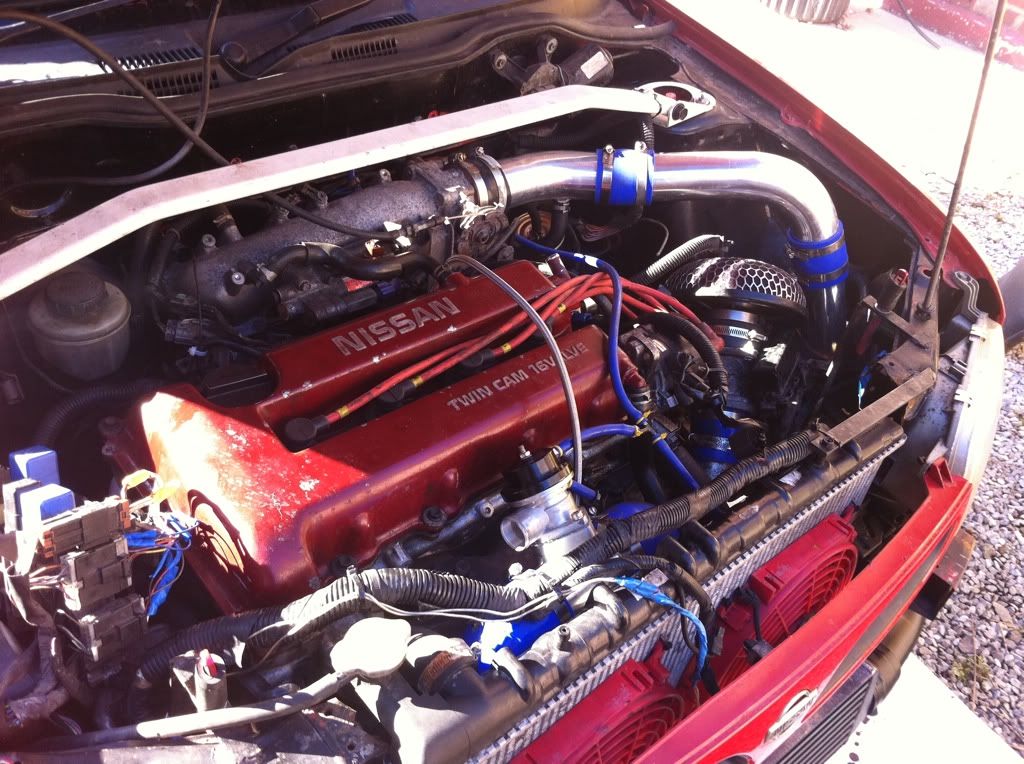

Boosted SR20DET K11 Micra

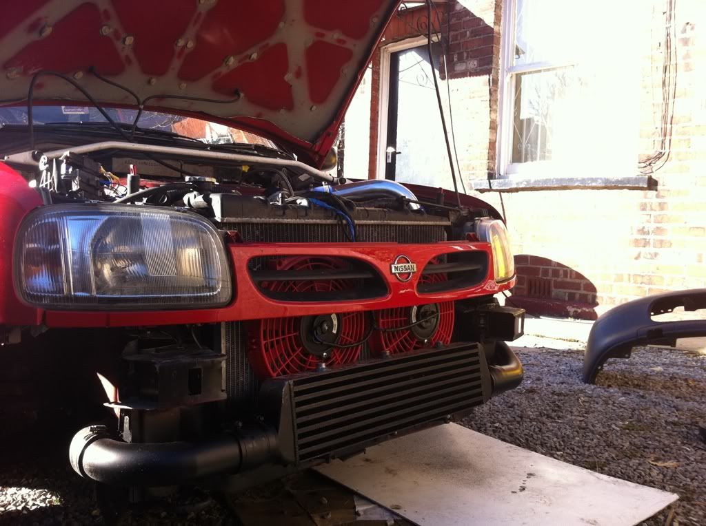

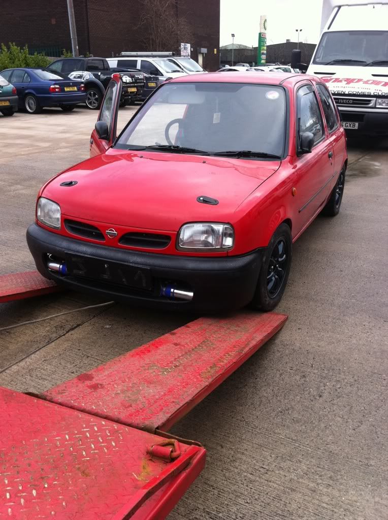

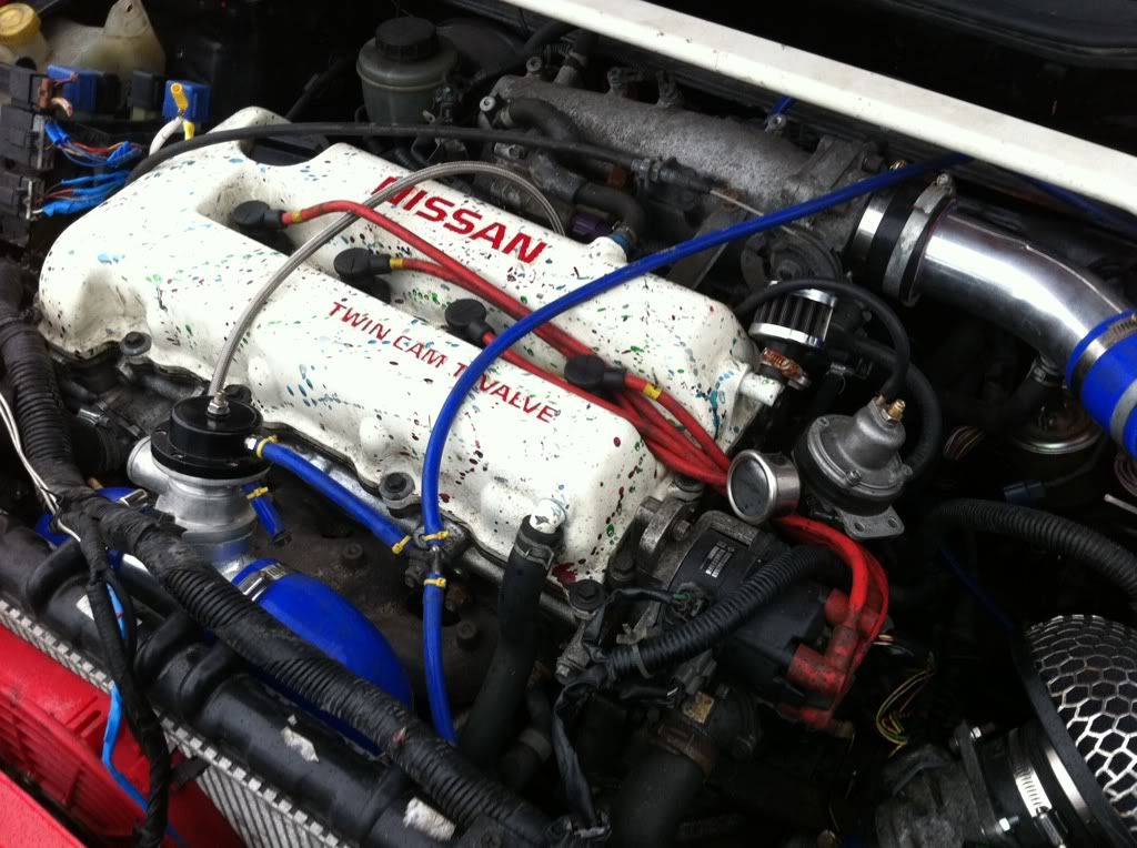

Popped down to get the downpipe fitted properly

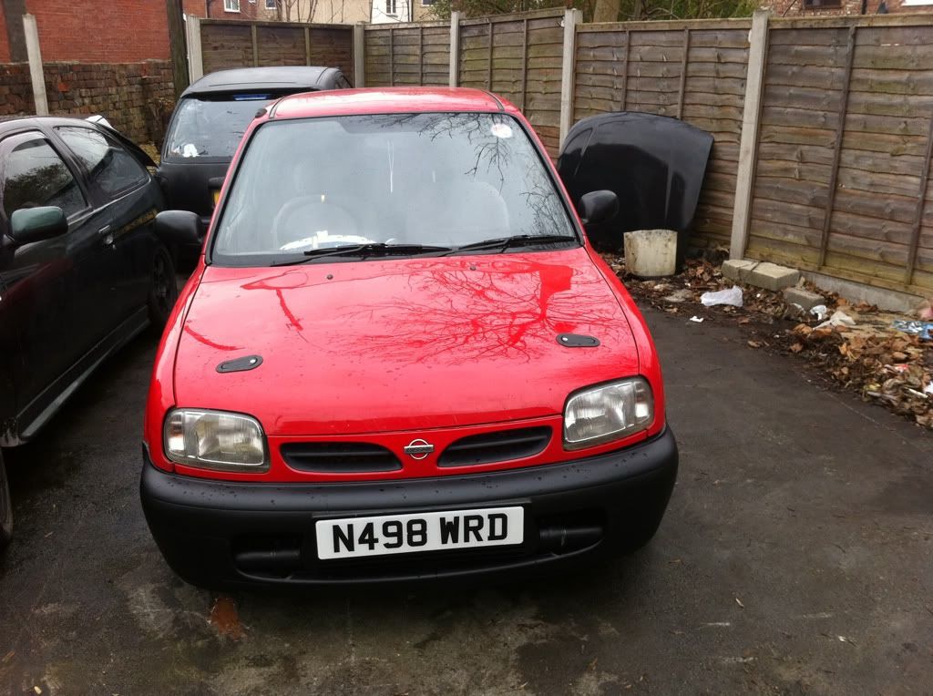

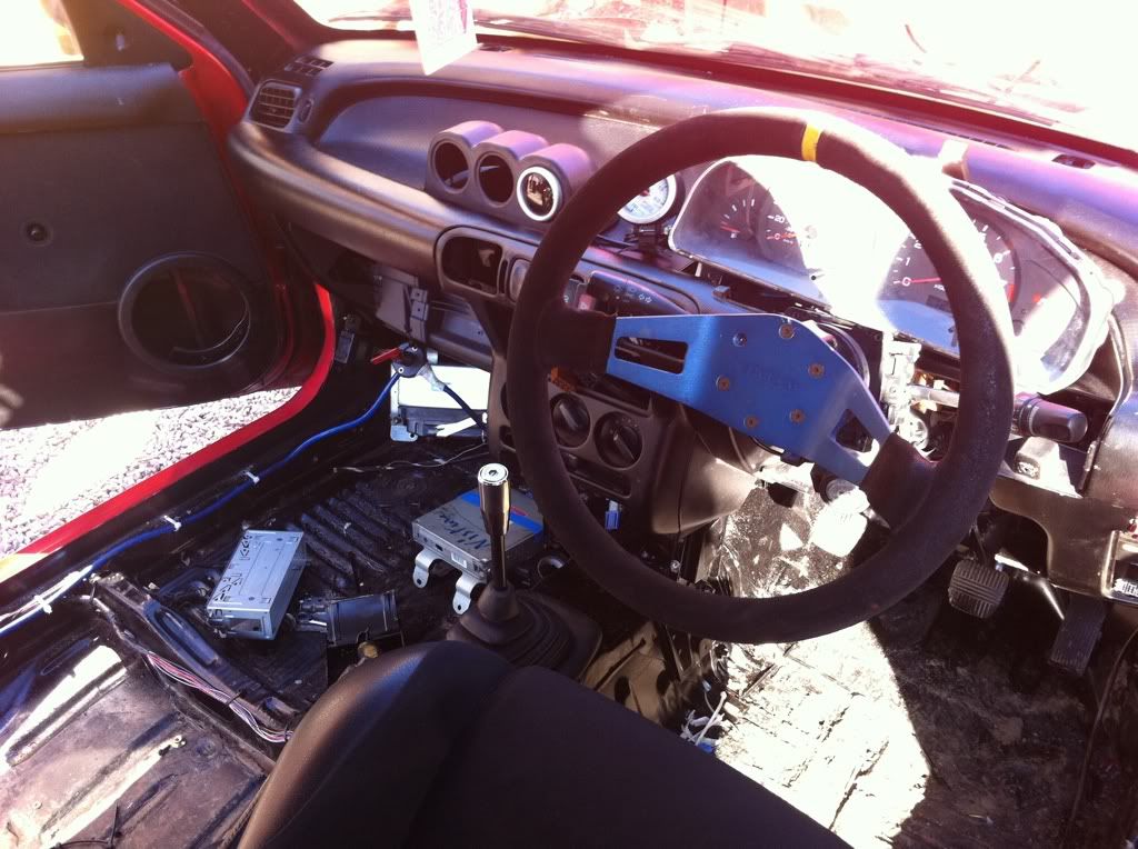

Got the car up and running.. couldnt figure out the wiring so just used a mera one
It messy but booked it in for a mapping session on the 1st of march so gives me time to sort it properly
Car runs boost up to 7psi cause iv got a ****ty map on the nistune board

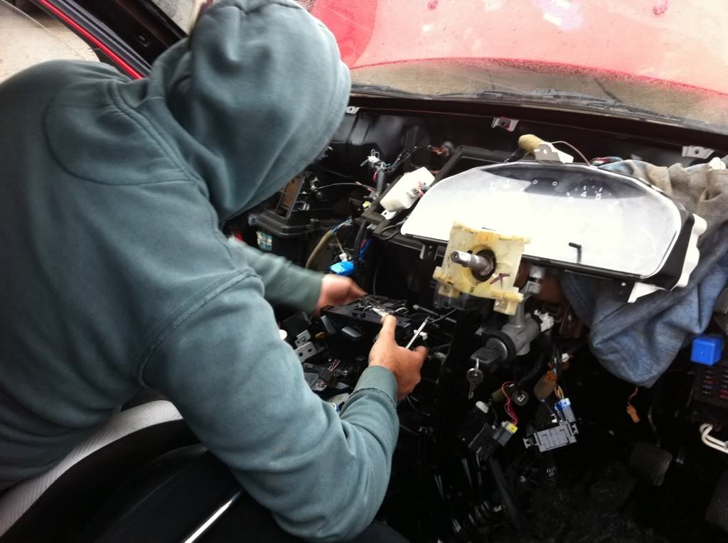

Mov, ago some months sent you a pm asking about wiring, how hard was wiring? what about adapt SR20DE keeping Micra cluster?
BTW, Your works are really good.
Hi mate. i used the full loom from a almera gti.
I used a almera loom so it work how it should of in the almera
Everything works
Hi, i means first time when you did swap, you did keep micra cluster.
I'd like when i swap SR20 into my k11, to keep stock cluster!.

Very nice figure Mov, is 0.5 the highest boost level throughout the rev range or is 230 actually achieved at 0.5 bar; does your boost curve tail off? graphs?
Its much much neater however just to merge both the Micra and Almera looms rather than swapping the whole thing.
Mov I guess you decided I was too far? In any case, whats your boost and AFR curve like? I'd expect a much smoother graph if done with nistune etc. Fair play though, you have it running nice one :)
if you look at my blog it is possible , im using micra clocks in my sr20 micra , you just have to go through all the pinouts :)
