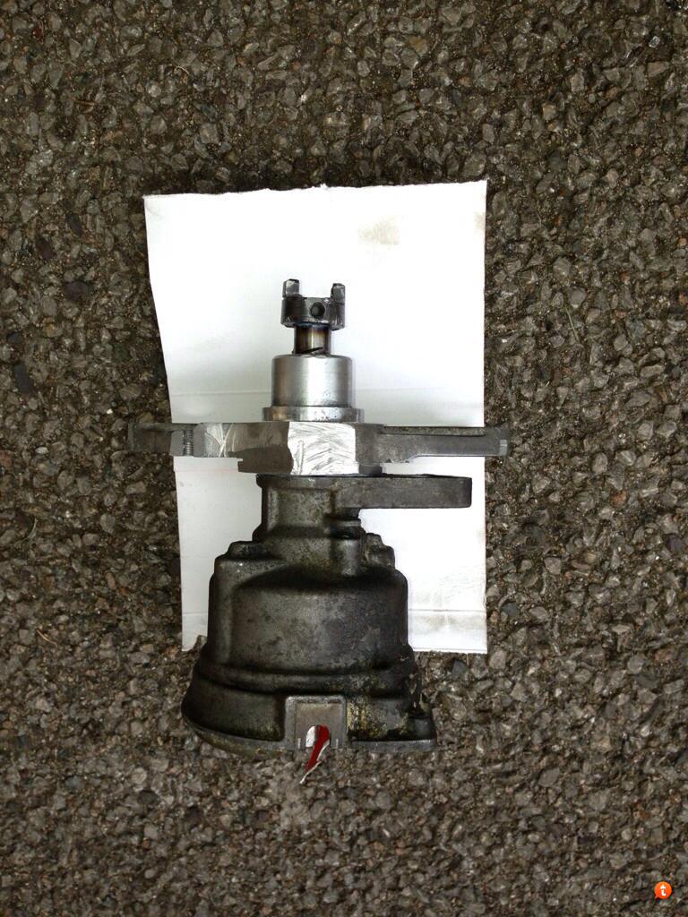

You need the k11 dizzy coupling part that goes to the cam, then stick it on the k10 dizzy
But skinner still uses his k11 ecu to do the spark I yhink
Here's pic of mine I made
K10 dizzy, k11 coupler, then I chopped up the k11 dizzy to make a adaptor/spacer

Because making a k10 dizzy fit, seems pretty easy.
I can TIG weld the coupler, and mill an adaptor to make it fit
