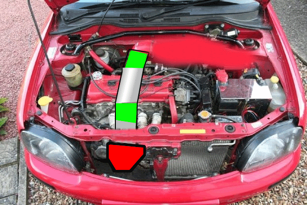

Came up with this idea (5mins in Photoshop later...)

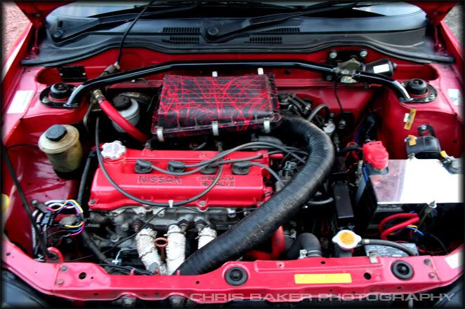

Idea came from Solarice's car:
I know his set up is for something completely different,but its a better way to get cold air,rather than tucked behind the battery. I'll get a custom shield to go around the filter to stop water being sucked into it (as me and cold air feeds dont mix....some may remember ;))
Will this work? Is there another filter with the same/better gains other than a K&N (Green Cotton/PiperCross/BMC etc)

to be honest i never really though air filters and cold air feeds made that much difference to an engine of our sizes.
looks like you have a good plan drawn up though. (oh and your quick photoshop looks like a penis.) (Y)
but im just childish - Good Luck! hope you get it sorted out.

Matt does a group A induction setup like your 'shop hooded, bit expensive though.
Im sure somone will say get a ga16 airbox and performance panel and move on lol

I'm using some ducting running from the front by the horns, into my std air box, could just do that with the performance panel filter? Or was the point you're after proper metal tubing?

One thing i always wondered was turning the battery thru 90 degrees (or locate it to the boot) so you could heatproof that corner of the bay and take air from there that feed from the arch or summit.

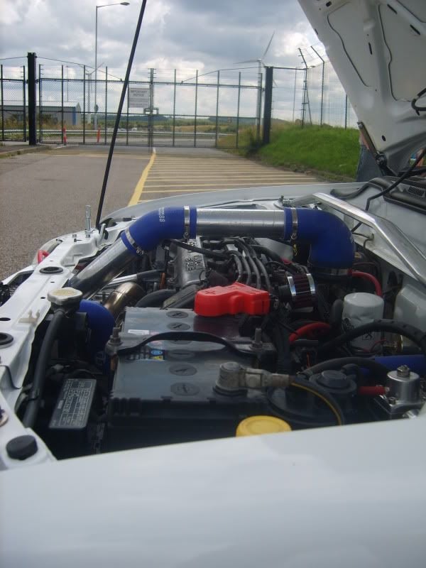

I saw loads of people with the induction kits in the first picture of the thread and thought 'what difference will taht make, other than the noise?'
So I done a bit of research into where you can gain power with an induction kit.
Temperature. Colder air is denser. Mine is made of alloy pipe and wrapped in heat reflective tape.
Length and shape. Shorter and straighter gives the air less chance to heat up. Taking the engine out the road would lose power so my kit takes the most direct route. (Other than putting a big 50s hot rod bonnet scoop on!)
Volume. You need there to be lots of air ready to be sucked in for better throttle response. I found an HKS filter and a load of alloy piping lying about the workshop. Plenty volume!
Position. Being mounted low and in direct line of wind should cause a ram effect forcing the cool air in.
So on paper my induction kit should work. I don't have any figures to compare it to and I have not done enough to warrant a visit to the dyno.
Sounds great and the air appears to be getting into the engine ok.
As for driving thru puddles or washing the car I just won't drive it thru big puddles and I'll be careful washing it!

hooded its mr bling here have you thought about cutting a hole in the left hand side of the bumper (passenger side) and gettin a pipe made up from the front of the bumper through the hole that is in the chassis leg then bolted up to a filter like what you used to have or like i used to have
if you look under the radiator tank next to the battery there is a hole that leads to the bumper or behind the passanger wheel and there is nothing there really as thats what i was going to do take my angel eye lights out then cold air feed from the passanger side up through a pipe under the tank then to my filter which would be fully incased in a heat proof shield so only cold air from the front of the car would be getting to the filter but thats just my idea

The GA16 air filter is an improvement over the standard, the one most people on here have (Picture 1) is better than the GA16 one but if you want better still you have to make your own. If you are making your own you might as well make one with the largest capacity to direct air into the throttle body using the shortest route to keep the air under pressure and dense.
