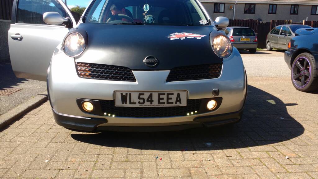

Well these are mine :)
Just an example its a bit like marmite love or hate...
Lights on!

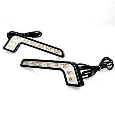

My idea is not direct bolt-on, this requires little bit tinkering and electrical know-how. If you have clear front turn signals, use these: http://www.ebay.com/itm/2pcs-20W-Am...Parts_Accessories&hash=item4ae21e4533&vxp=mtr with these: http://www.ebay.com/itm/2pcs-1157-2...Parts_Accessories&hash=item233823c715&vxp=mtr. Then your turn signal work as DLRs and blinkers, without any visible modification to vehicle ;)
I've done the DLR for A3. Its very easy job to do. Its kind of same as connecting HID kits.
Anyway i went for direct bolt on with Micra.

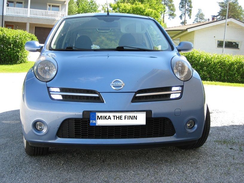

Now I finally had time to install the DRL's, easy to install and works fine. Now my headlights look like candles compared bright blueish light in DRL's, got to get xenon's... ;)

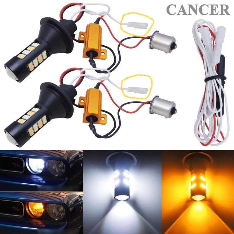

My kit works perfectly. I connected orange circled wire in the picture to constant 12V. Cut sockets off from DRL kit and also cut connectors off from Micras wire harness then connected red and black to to vehicles original wires.
Now similar ones are cheap on ebay: http://www.ebay.com/itm/No-Hyper-Fl...ash=item3d1c3aac48:g:M9AAAOSwnFZXUVcI&vxp=mtr

John, with your option you have to mount something to front of your vehicle...
By using original indicators, you only need some connectors, few meters of wire and one automotive relay ;)
And DRL's look like been mounted in the factory.

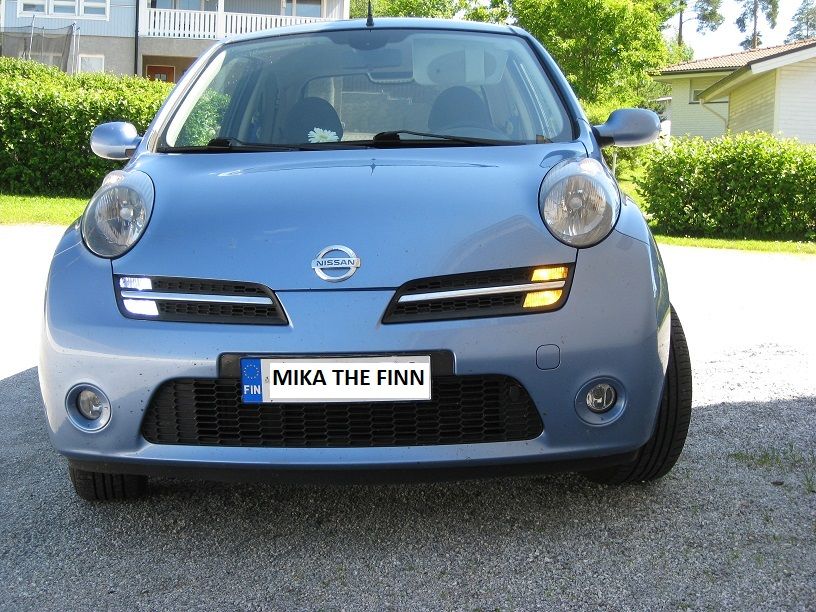

Bright white DLR's will change to yellow inside lamp housing when turn signal is used, so it flashes in bright yellow. When turn signal is turned off, there is 1 sec delay, after this time bright white is back on. And Audi, Mercedes and BMW's are having same or similar function in their DRL's.

In my opinion these don't detract from the visual operation of the indicators and other road users are visually able to see difference between DRL and turn signals due color difference, even they are in same housing.
Simple visual example of my Micra with DRL's on youtube now https://youtu.be/HCeLKCHS18I.
