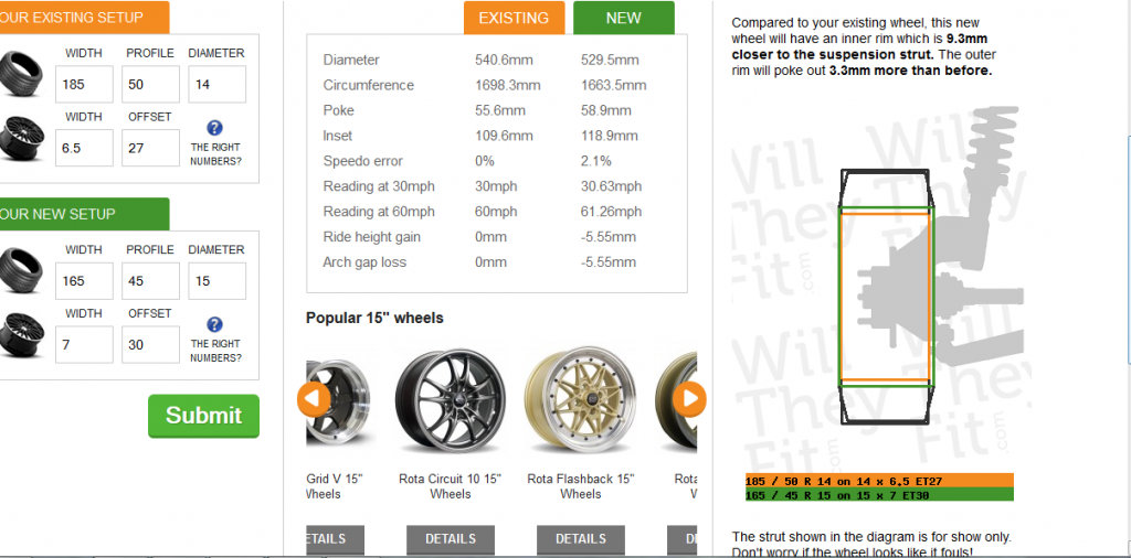

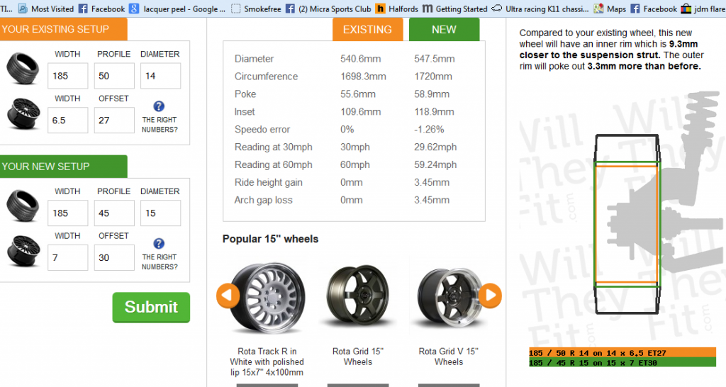

Right I am saying bye bye to my wellers now. Getting some Rota watanabe reps, 15x7 30et. I am either going to use 165/45/15 or 185/45/15 tyres both are near enough the same as the stock rolling radius.
I did have 14x6.5 27et bbs's on my old super s with 185/50/14 tyres and they were a tight fit on the back so these should just fit. This where I am stuck.
get some 185/45/15 tyres get better grip but run the risk of having bad fitment ie tyre rub or run 165/45/15 tyres have stretch, worse handling but a promise to have good fitment.
It does look like with 185/45/15 tyres the fitment is near the same as the bbs's just a tiny bit more poke which could lead to disaster. Is it enough to worry about?
