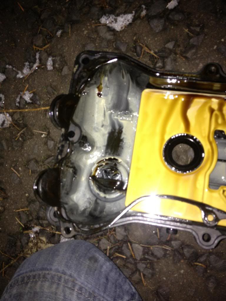

looks ok to me stani, any coolant gone ? i have my a little plastic bag on the end of my rad overflow pipe now to check for coolant loss, because on a previous engine it spat about half a cupful of coolant out when i was ragging round our track one day, guess the boost stretched the headbolts a tad and lifted the head up and pressurised the coolant, because it never leaked any more :)
Bra! I've had small coolant loss over a few months but my waxstat on the TB is still leaking so I know that accounts to that. The condensation I presume is through my 'clicky' oil cap so I replaced it for a standard one and really tightened it up, after first realising the creaminess we had to drive approx 8 miles to get the other cap and when swapping them the 'clicky' one was once again a bit creamy. But after approx 10 mines with the over tightened cap on its not creamy so tomorrow I need to burn the rest of my fuel approx 70 miles left before I fill up with v-power so will check again after that :)
