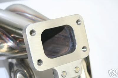

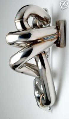

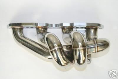

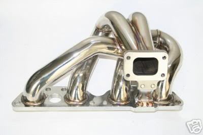

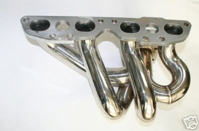

gonna do a search to see how differant they are.........search done and these look complicated but hey i will still have a go are these the correct ones....
OP
OP
kennierobo
kennierobo
Buy & Sell Member
so the differance is the mating flange but can someone explain why I get the feeling that the flange on these dont point down it points upwards........these look very complicated ie the bends..............can somone go into detail has anyone got one that could be measured up and photos taken in situ got to start somewhere ............and im still looking for a standard 4 branch thats busted to copy it.........surley im not going to have to go out and buy one just to make them cheaper for other people I need to save as well..............

the hks cast maniofld points upwards, this is the most direct route to the inlet, but causes masses of piping thats not needed if it hangs below the manifold for intercoolers....
