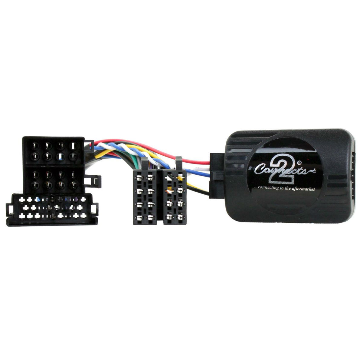

This isn't finished yet, as I still need to buy an adapter for the steering wheel controls - I've found one, designed for the Note, but is £26 so I have put it off for now - at the moment, I'm just using the up and down volume buttons. In theory this should be plug and play, but we'll see.
EDIT So I've now done the steering wheel controls, found a 'used' adapter on ebay for a bit less than new - still sealed, presumably the guy bought it and just left it in the garage, the packaging was a bit tatty but everything was inside. Same part number as the new one I linked above so wasn't worried about it not working. For my generic 'Chinese self learning' headunit as the instructions referred to similar systems as, I followed the instructions just to connect one wire up, labelled KEY 1, which was the same label as on the new stereo harness, and it worked fine.
Set up the scan up/down and volume up/down buttons to do what they did originally, ie skip forward and back tracks and do the volume, and it works great. Unfortunately, the SRC button wouldn't do anything, and I'm not quite sure why, although I don't remember using it with the old 6 CD changer either, so I don't really miss it, although it would've been nice to have it set up as a home button or similar. Might just be a common issue, I'll have a google of it but won't be losing any sleep over it. More importantly, the Info (i) button still works no matter what is plugged into the stereo wiring, it's not like it needs something plugged into the steering wheel controls wiring just for that, it's on its own loop. Glad I did it, although it does seem a bit expensive when it adds like 40% to the total price, but now it's just the reversing camera to sort.
