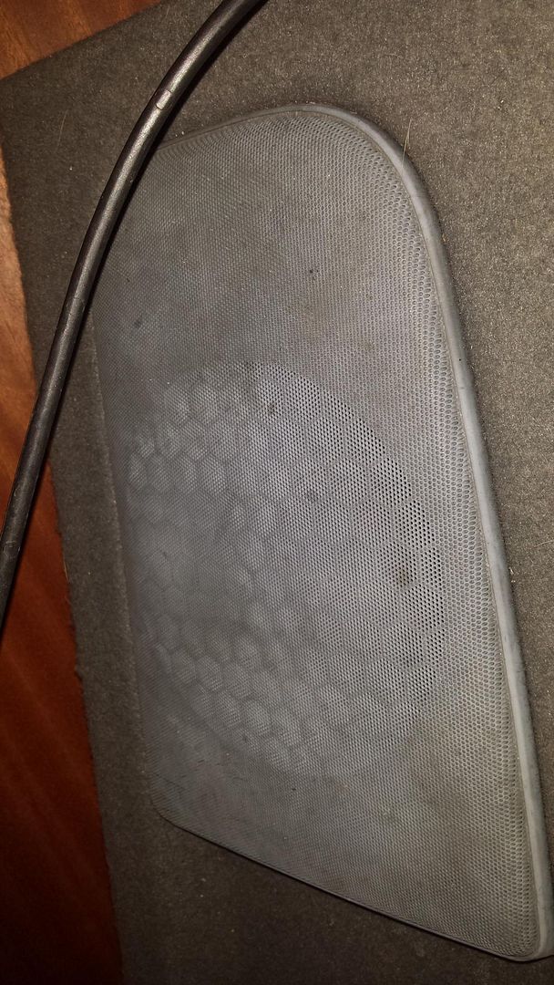

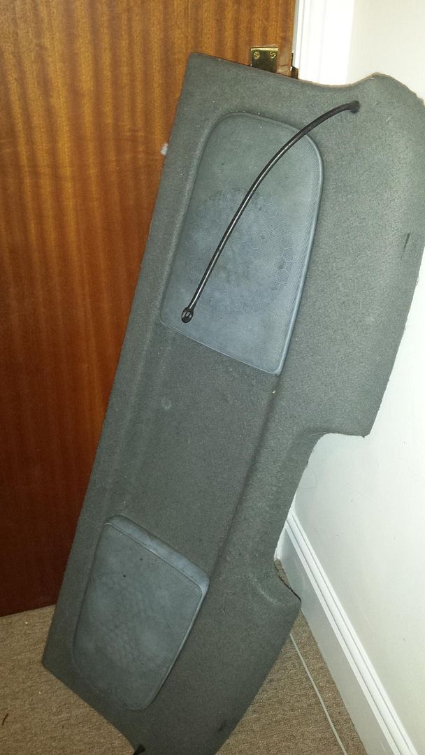

It's a bit tatty right now but I got it for exactly £0! I've got a mate who's stripping a micra and sticking a SR20DET in it so he's got pretty much an entire interior he wanted rid of so I took this! My car is pretty immaculate inside so this is going to need an deep clean before its a loud in my car!
So I'm going hoover it, scrub it with interior shampoo on the fabrics and cockpit cleaner on the grilles to see how much of its former glory can be recovered! Then to see if my car has the wiring behind the dash for the rear speakers! The plugs are in the boot so fingers crossed!

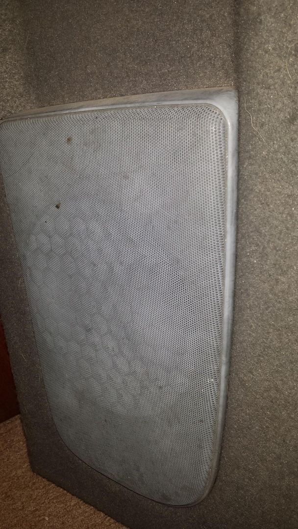

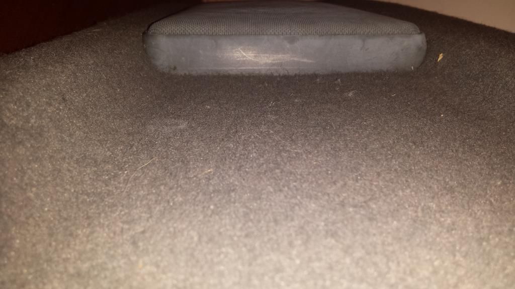

So the shelf didn't clean up fantastically and when I test fitted it I realised theres a void for a brake light, mines at the top of the window so plans are at changing!
The grilles look like they will slot into my existing shelf with some drilling and cutting for the speakers and screw holes.
The originals that came in the shelf are 17cm and ate just screwed into the grilles so nice easy swap!
Plans are now to spray the grilles to match my original shelf. Upgrade the original speakers in the shelf to a pair of Vibe Slick 6 speakers and retro fit them to the grilles, then retro fit the grilles to my original shelf. I'll use the original wiring guides the keep everything under the shelf tidy, simple job of removing the speaker blocks and replacing them with spades.
I'll heat shrink all the wiring to keep the OEM look even whey the boot is open. Then see how it all sounds hooked up and contemplate replacing the door speakers with the same.

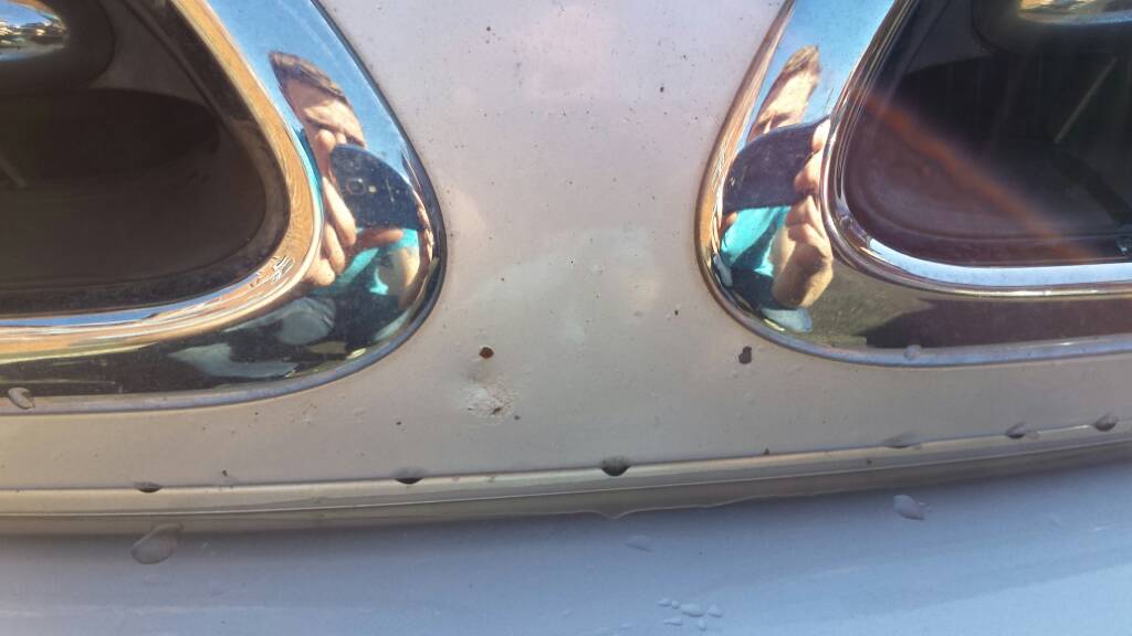

I noticed a good few stone chips around the front so I'll be getting the paint code and mixing up a touch up pen at work

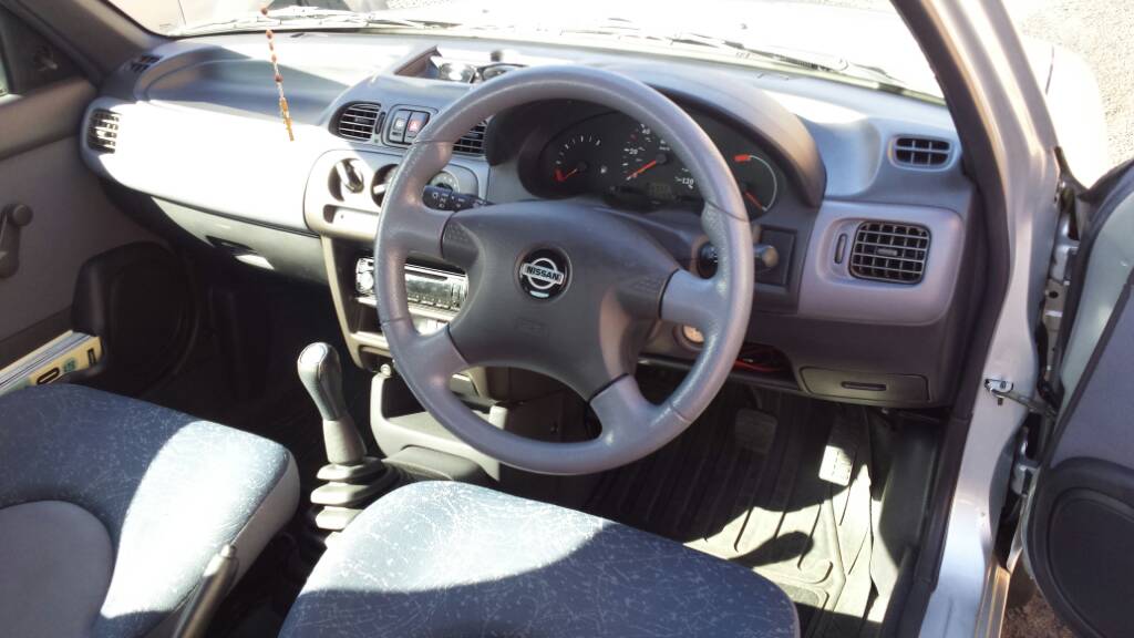

I gave the interior a deep clean the other day and it's incredible how tidy the inside is for a 13 year old car!
Next job is going to be to remove the tatty pre facelift parcel shelf and put the original back in. I am going to remove the speakers from the tatty shelf and retro fir them to the tidier one. I'll respray the grills satin black to keep a OEM look in the darker coloured shelf.

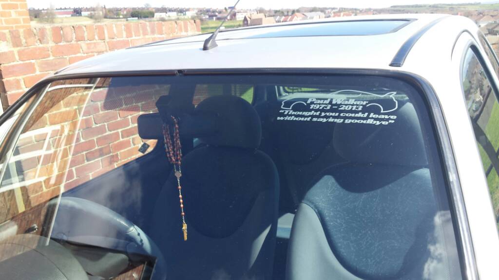

My Paul Walker tribute sticker arrived!!

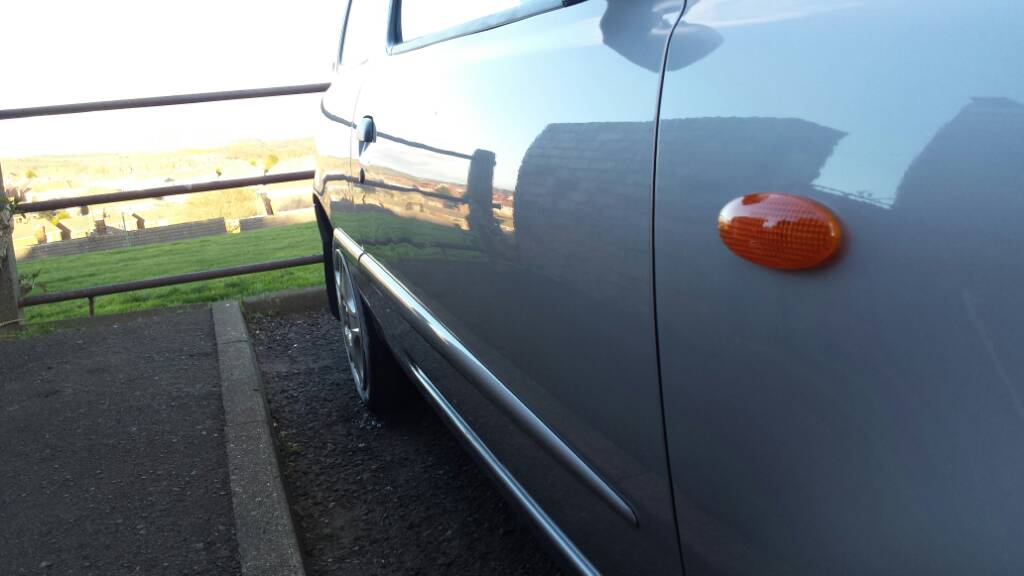

So I polished Persil on my lunch break today with a mate, full T-Cut Metallic and Autoglym Super Resin... it's come up awesome!
Before
After
Mind the dents lol

Hi Kev the Mighty Micra looks great I have always liked the metallic silver colour suits the shape of the car. My project 2002 (Nov) 1.4SE did not have rear parcel shelf speakers so I replaced it with the one from my other donor 2002 CVT 1.4SE+ which had them. It was a very easy retro fit with the speakers plugs already in my SE behind the right side interior facia and also the rear speaker plugs were behind the CD player and I do find the original Micra rear shelf speakers are of good enough quality!
