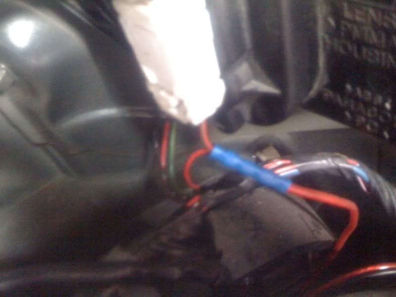

No how to i'm afraid positive in the 3rd brake light goes to the red/green wire on the brake cluster. (use a multimeter if needed, to be on the safe side.)

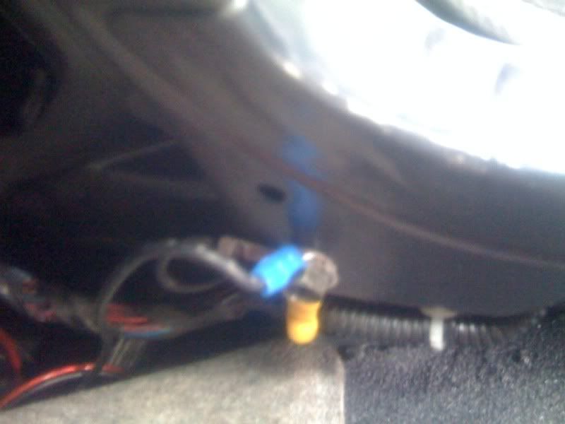

and it's grounded on a bolt on the right hand side next to the right cluster.
the problem is actually getting the wires through the boot to the grommet and to the cluster the rest is easy.
Poor pictures from an old iphone i'm afraid:
Positive:
Negative:
