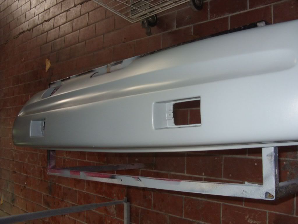

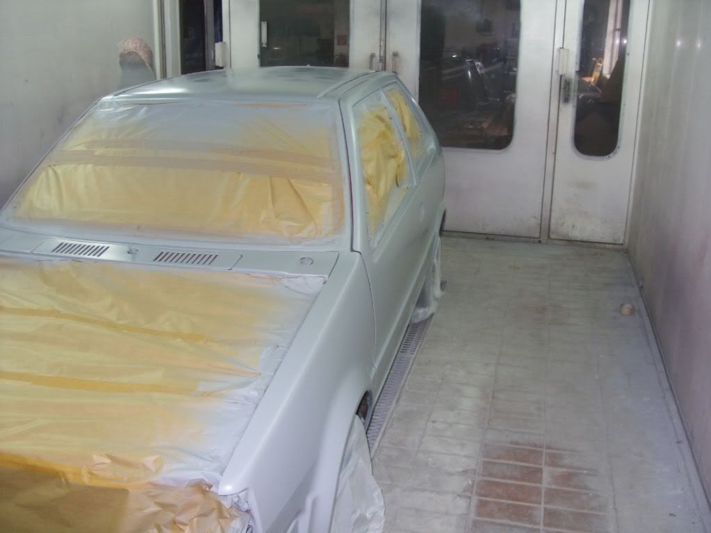

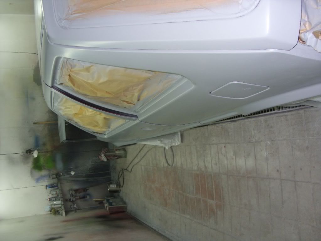

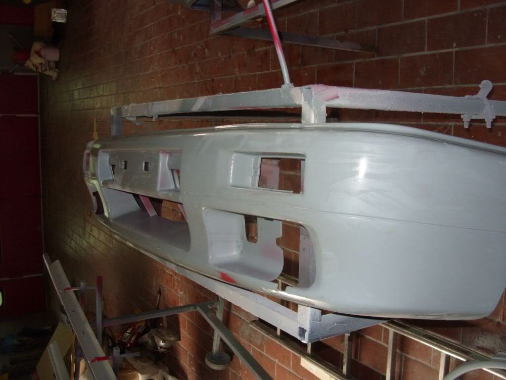

after I bought the bumpers (the sideskirts are not installed)
the alloys

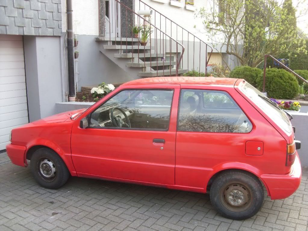

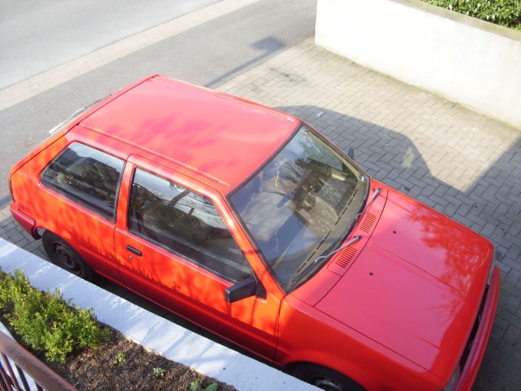

and now the car with primer on it, unfortunately I have not taken photos of the finished car yet, because I broke my frontgrill and need new tyres for the alloys and the sideskirts are not installed. I want the car to be finished before I take photos

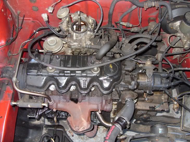

Anyone know what the brass looking pipe is on the left hand side of the photo?
I think its for the winter/summer mode you have to choose manually on the non EGR k10s, It gets warm air from exhaust manifold back to Airpan.
no the winter/ summer switch is on the airfilter! this thing is supposed to burn the "hot used air" (sorry don't know the English word for it, in German it's "abgase") again. It's just because of the German rules about air pollution. It makes the car "greener".
(I think, not 100% sure)
You don't have such a thing at your micras? I don't know if this thing costs power. It goes straight from the manifold to the inlet!
And what does EGR mean? Cold start automatic or something like this?
its exhaust gas recirculation alex (to reduce the nox emissions i believe) :grinning:
EGR= Exhaust Gas Recirculation? Interesting, in Germany it's AGR and that's what I thought the pipe at the left is supposed to be a part of.

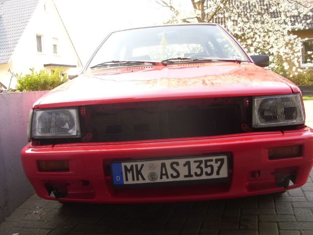

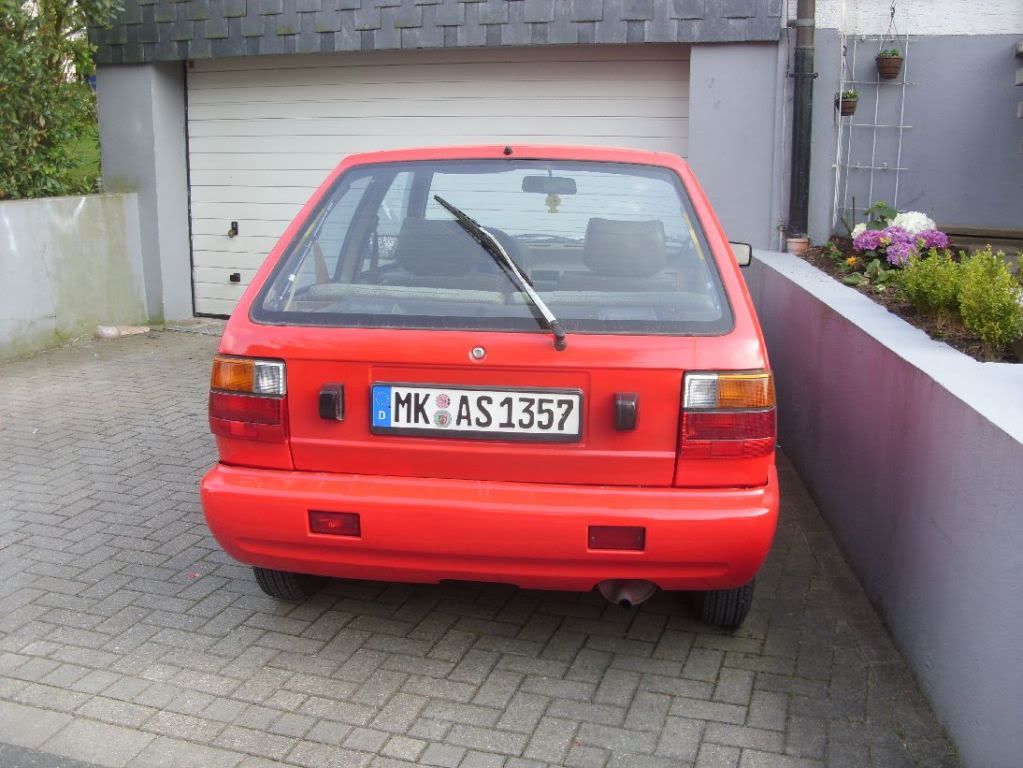

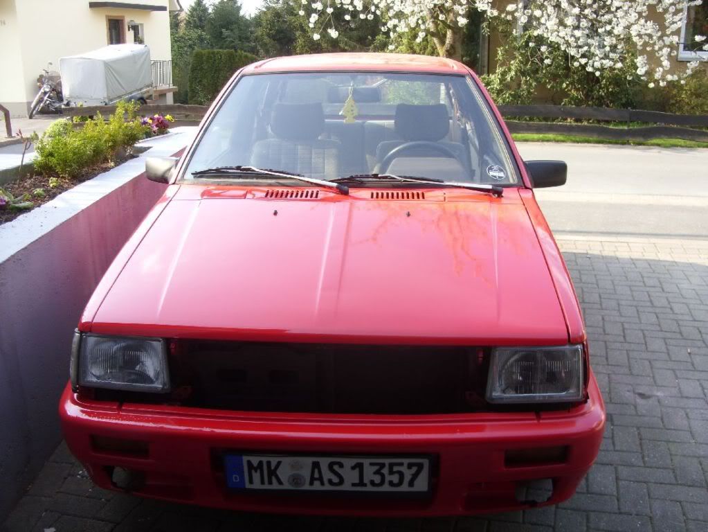

even if I didn't want to make photos yet, I had to do some for the nissanboard.de
I want to share them with you too
I will leave it on, because the German cops are very strict. You have to carry a permission with you for every part which is not standard. So if I take the horn cover off, there is no Nissan logo anymore and I have to explain it to them. Probably it would be ok, but I don't want to talk to them longer than necessary :D

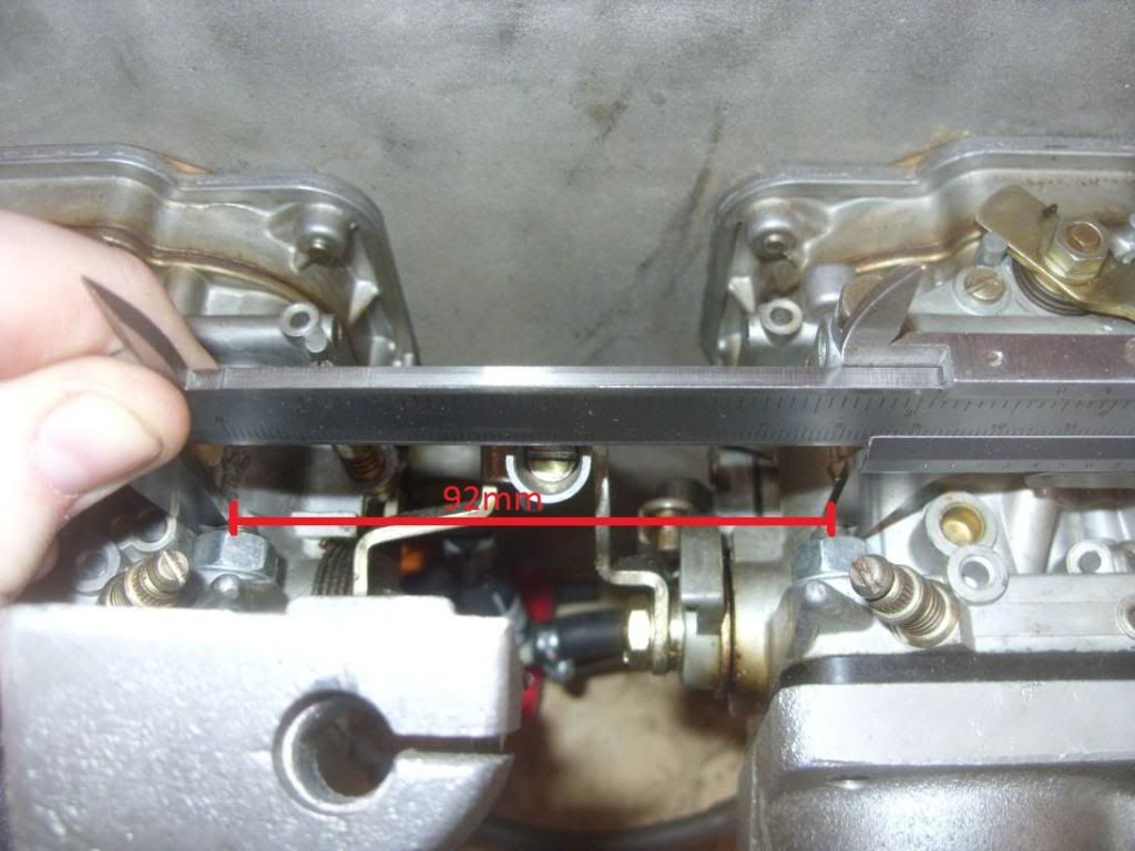

Would you be able to take some measurements for me, on your webers and manifold setup?
Iam making a new manifold and I need to know how far apart the carbs are!!
Can you measure how far apart the bolts are that bolt the carbs to the manifold. Measure from the middle of the bolts please!!
Just the inner ones will do. I will make my own linkage so it doesn't have to be 100% accurate measurement.
Thanks
Kev
I measured some things yesterday, because I want to convert to throttle bodies with injection (not 100% sure)
first the measurements are like this for a dcnf flange (probably you don't need it, but it is a nice info to get it 100% accurate)
http://www.dta-motorsport.de/PDF Dateien/TC.pdf
and the space between the inner bolts is 92mm as shown here.
If you need any other info, let me know. I will help you
