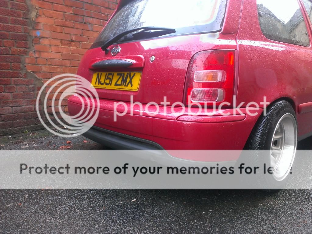

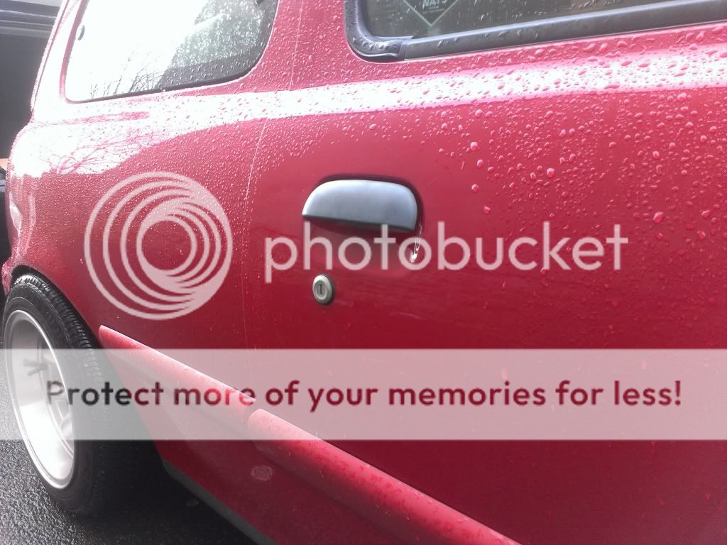

cousin had his hot air gun out today so I used it on grey plastics. Looks million times better

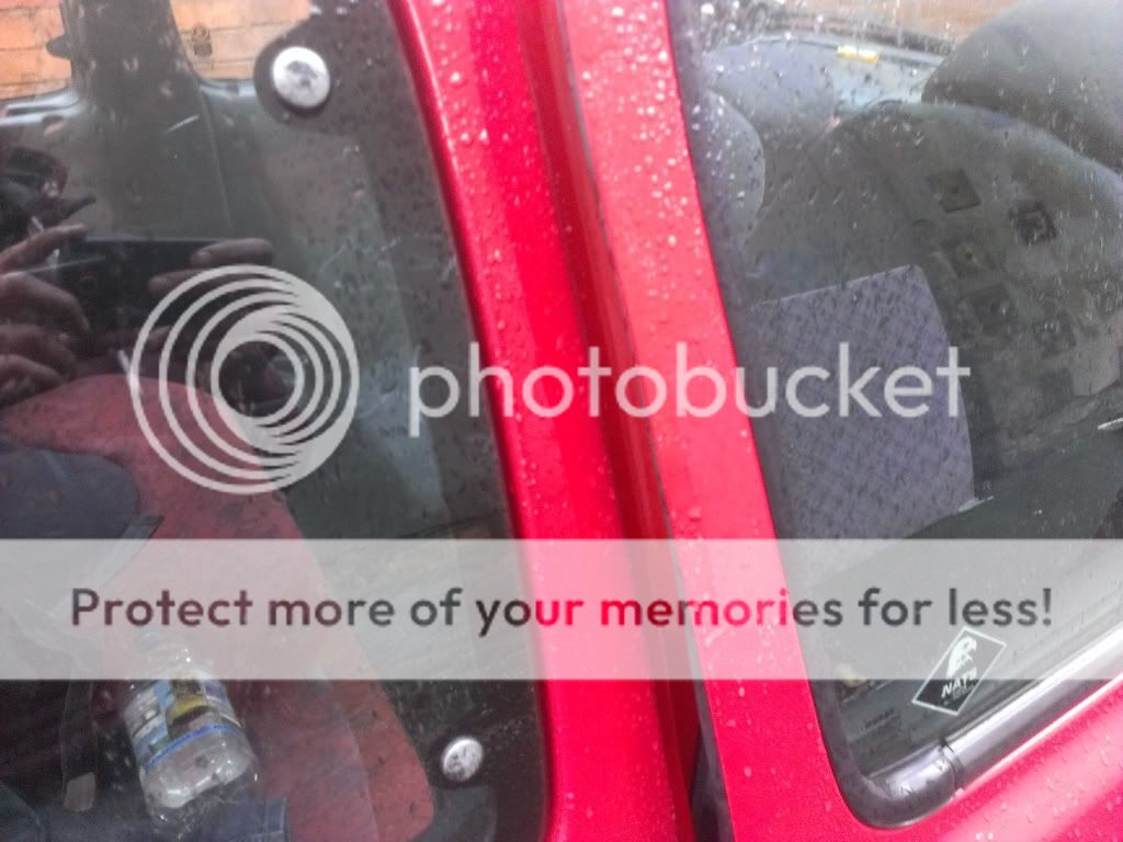

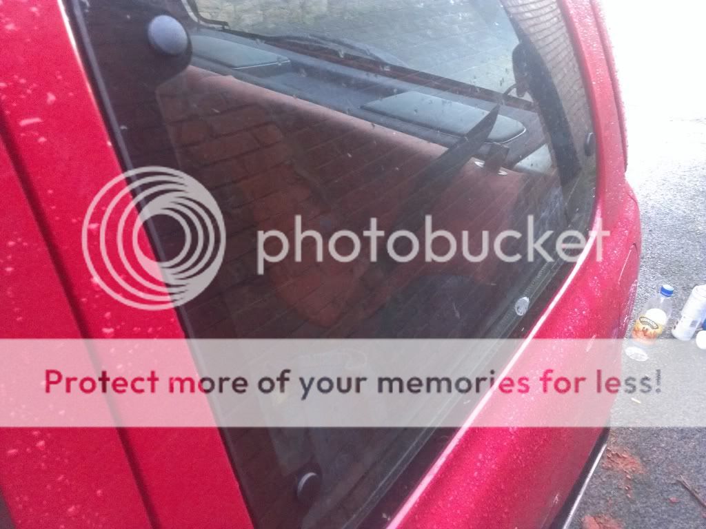

was sick of the chipped paint on windows so painted them

with the airgun just slowly run it back and forwards along the plastics, you can visible see it change in seconds. each bumper took no longer than 10 mins each. also done the door handles and the red strip on the rear lights. just make sure you don't hold it on the same spot for too long. id say even 5 seconds on the same spot too long and be careful for the paint because it can be damaged. but on a whole its simple and well worth the 20 mins youl spend doing it @Magpie42
