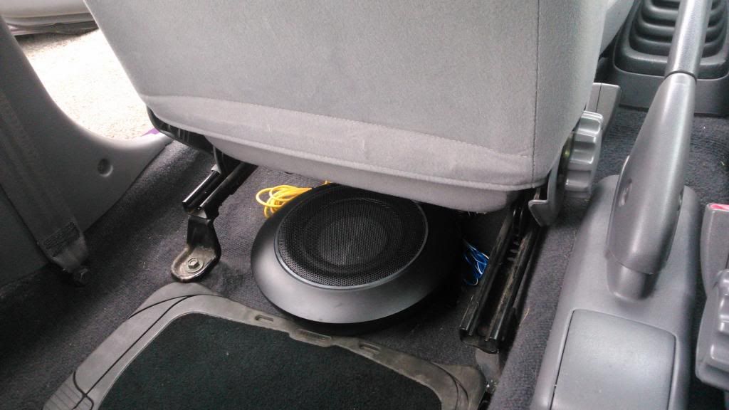

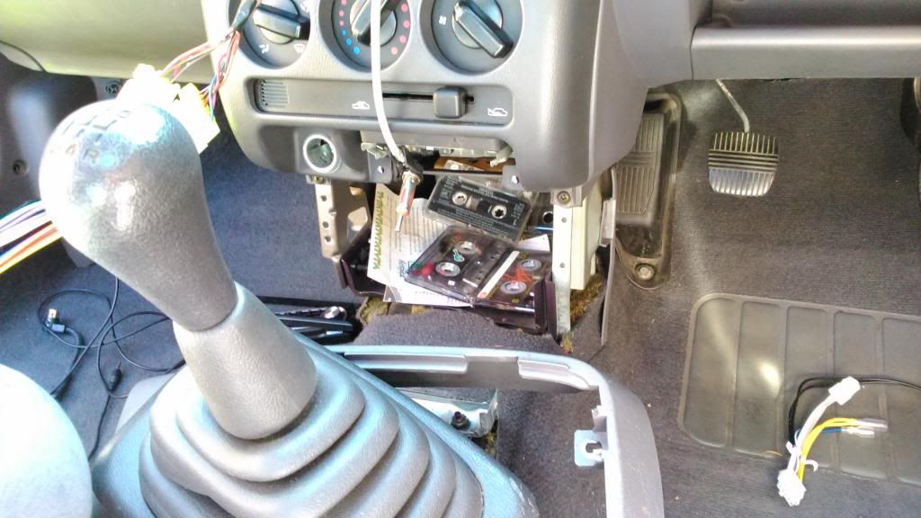

Then I fitted my headunit and underseat subs. (These don't count cost wise as they get moved from car to car hehe)
The centre console cubby seems badly designed as there is no top to it... Found a load of weird things lost behind it; titanic audio anyone?

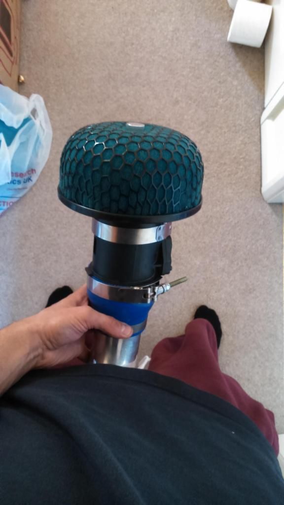

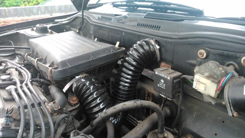

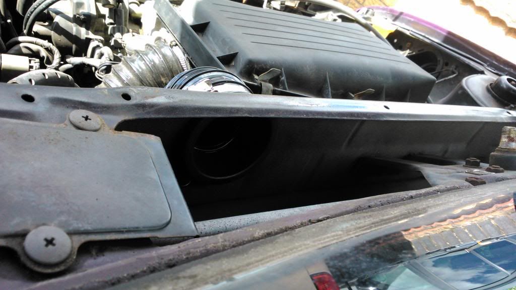

I know CAI aren't much good for huge gains, but it makes me feel like some super illegal pro tuner street racer. Plus I had all the bits lying around so went ahead and rigged one up. I had to get rid of the charcoal canister to make way for it.
Anyone else here a fan of cowl intakes? There's a good bit of info on them here: http://www.autospeed.com/cms/article.html?&A=110680

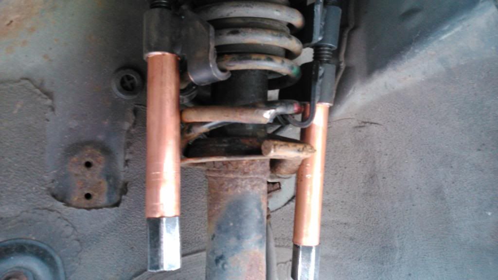

I wasn't much into the off-roader look so I started looking around at coilovers. But... I remembered this is a budget build, so choppies it was.
However, when I got it up in the air, I saw that all the bolts were too corroded for me to attempt without oxy on standby.

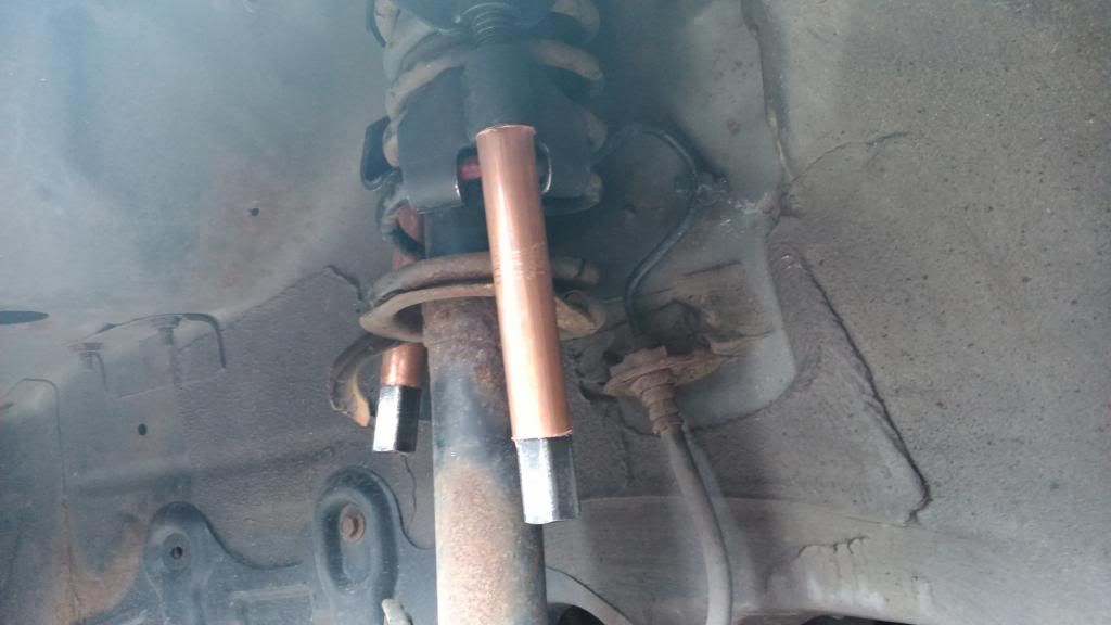

So I got the modified spring compressors on...
...And cut them in situ. Possibly the safest thing I've ever done.
I went for 2 coils off each corner. The fronts are just about captive, but the rears are a tad wobbly.

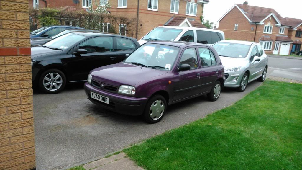

Anyway, this is how she sits now after settling.
The rears look a little tucked, but I'm not sure I like the idea of spacers...

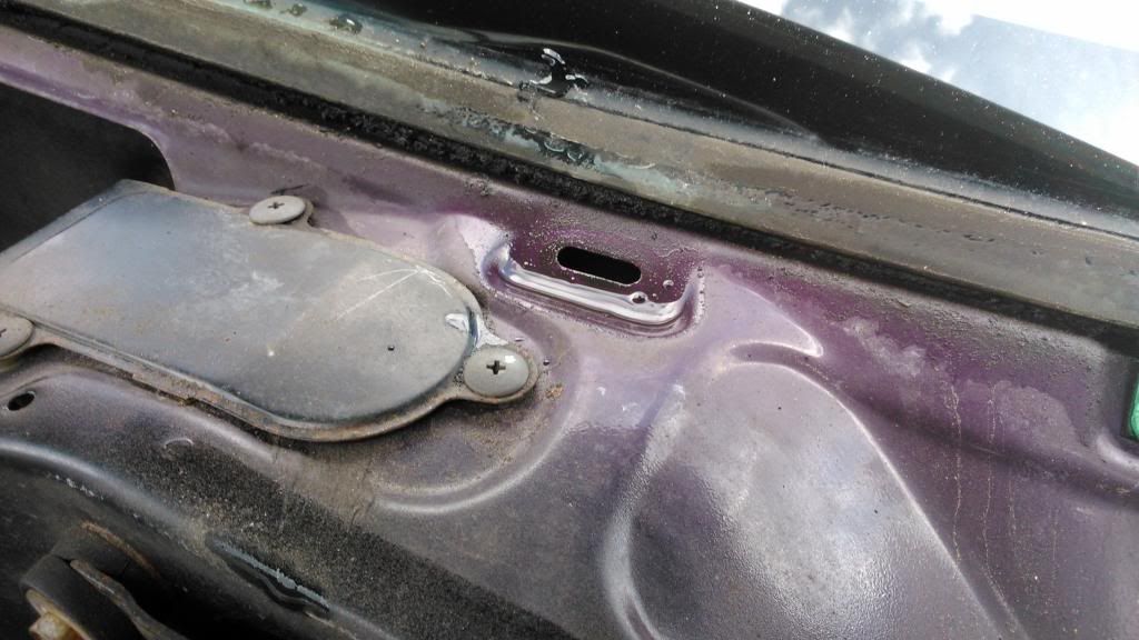

It lashed it down this morning and I discovered I have a leak - passenger footwell area. Possibly many leaks as the water did not seem to be too fussed as to where it gushed out of. Hopefully tackling this one when it dries up a bit out there.

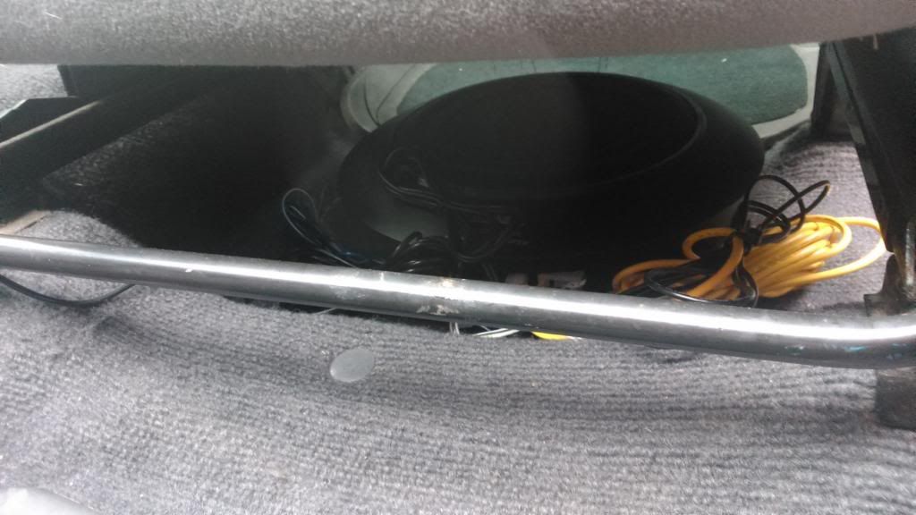

I was thinking of getting some under seat subs to conserve boot space. Are they any good?
Well these that I use are In Phase USW-10. Plenty loud enough and there's tons of room under there to fit them. They vibrate the entire seat when they kick which feels lush. The rear seat passengers sometimes complain that they can feel them rumbling in their feet, but meh. I love em!

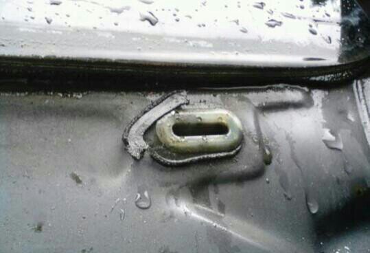

Your leak will probably be from these...
These live underneath the scuttle cover at the base of the windscreen and need sealing with silicone, sooner rather than later as you may end up with a soggy ecu :/
Thanks Ade! Yep, judging by the state in which I found mine, I would say that's pretty plausible. However, underneath these clips is a channel that I would have assumed can drain water away? And when I peered inside, I saw that the heater inlet is raised up about an inch? So I'm stumped as to how the water makes it into the car after getting past the clips...
Nevertheless I siliconed them in. Better safe than sorry
I'll report back when the rain hits again :)

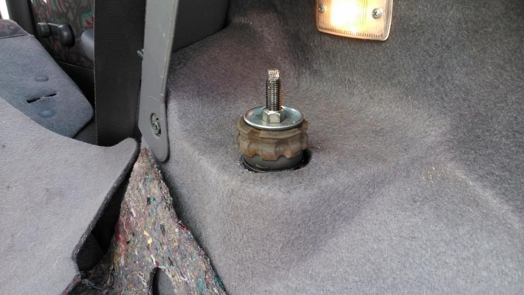

I decided to revisit the rear suspension as the uncaptive springs make me nervous..
I moved the rubber bush from under the chassis to the top. The springs are still loose, but to a lesser extent now, hurrah!

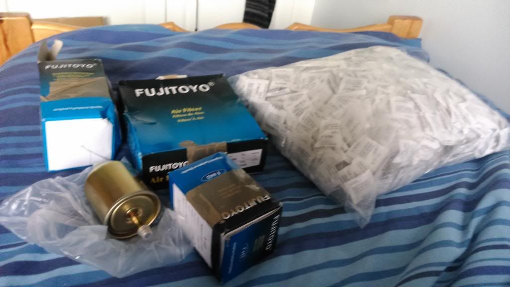

2kgs of silica gel packs stuffed under the carpet seemed to do the trick. I also picked up an air, oil and fuel filter as I suspect it has been a while.

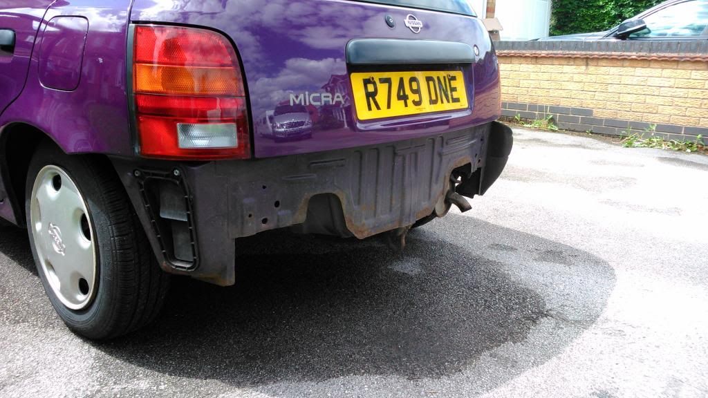

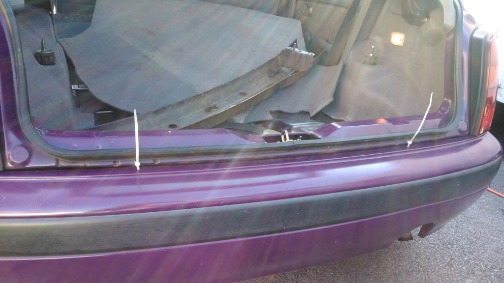

I read about a few people on here removing the reinforcer out of the back bumper. Mine wasn't sitting particularly straight anyway, so off it came.
I'd never have known those flaps were there. Something to do with cabin ventilation no doubt?
Reattaching the bumper without the reinforcer was simple enough. Few holes, 4 cable ties, jobs a goodun.
I quite like the idea of cutting a bit off to reduce the parachute effect too. Have many people done this to theirs?

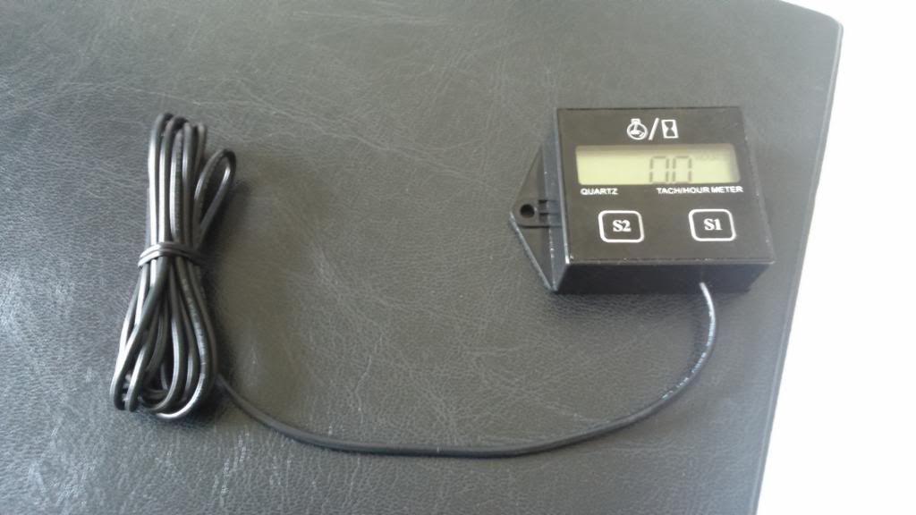

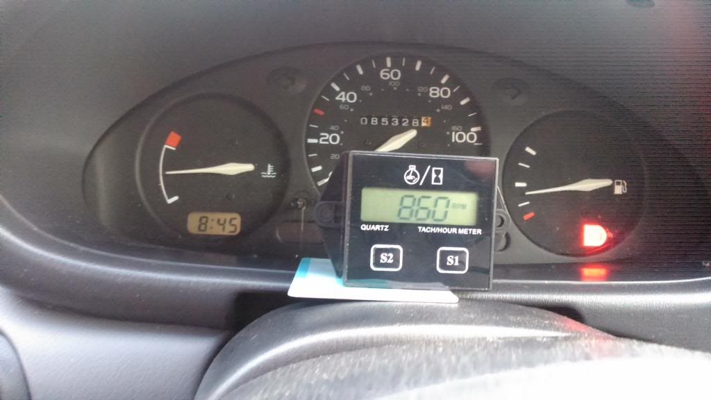

I've missed having a tach, so it got dropped in straight away
I took it out for a run and discovered that my car redlines at 5400... I knew these cars were reined in somewhat, but this surprised me nonetheless. So I checked that It was set properly and wasn't getting interference off anything and it gave the same reading.
I've seen people fiddling with the dizzy wheel in various ways to back off/remove the limiter so the next step is going to be reading up and experimenting with this :rolleyes:

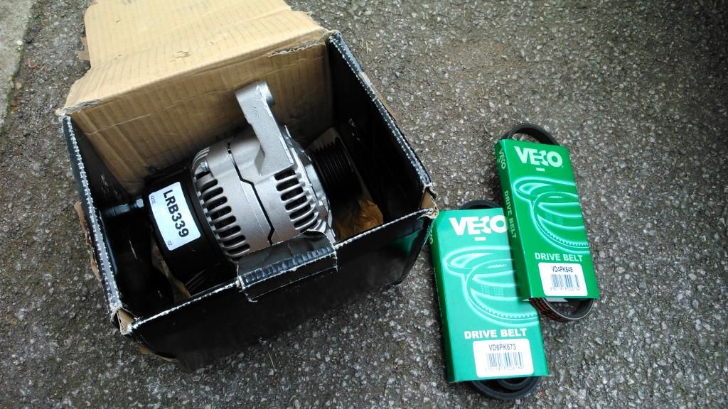

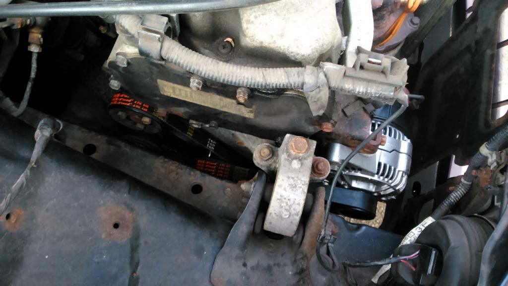

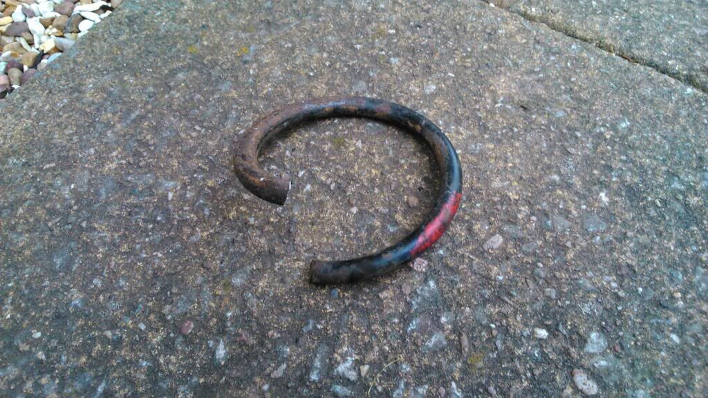

Upon returning, I set about pulling out the old alt

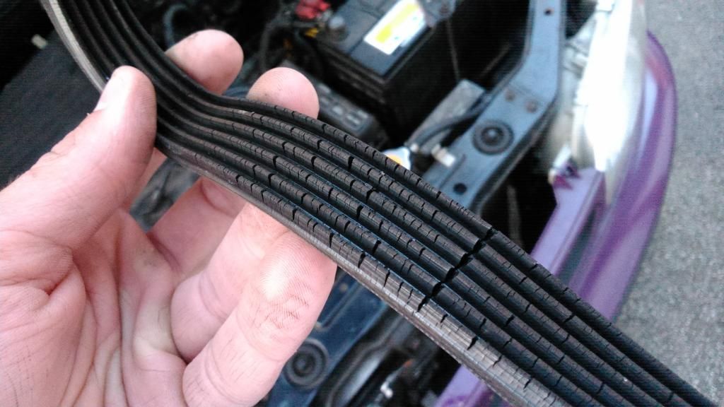

Noticing that the belts were demonstrating all of the properties of chalk, I decided it best to replace these too.
Sitting back, I awaited the arrival of my postman, who would undoubtedly come bearing gifts in a few days time.
Sure enough, said gifts were beared upon the postman's arrival. This resulted in some much needed brightening of my engine bay. Fluorescent orange bits on the belts, yo!

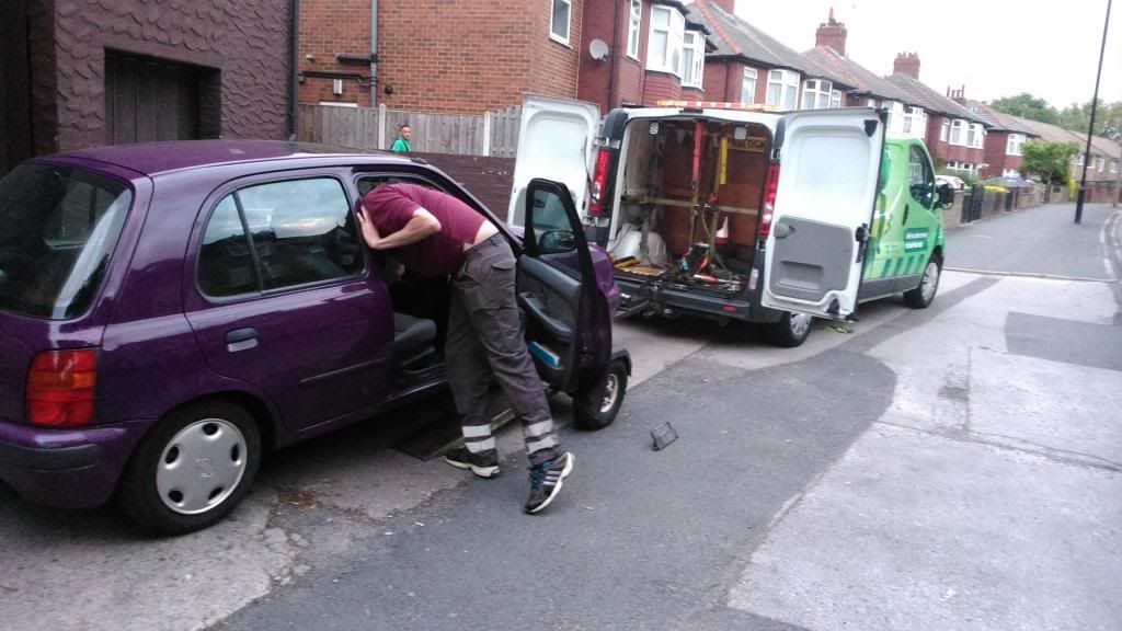

A week later however, upon leaving Tramp Spec for just a couple of hours, I returned to find her sitting there lifelessly. My predicament did not go unnoticed for long and soon the Mafia arrived.
Offering help, we attempted to get her running again, to no avail. I was dragged home again to ponder the mystery electrical fault further.
After about a week of testing and poking, I admitted defeat and sent it in to a garage (coincidently the same one I had bought it from). They made embarrassingly short work of the problem, tracing it back to corrosion under the fusebox. Upon receiving the car back however, I was greeted with another surprise. While working on the car, the garage must have stumbled across a spare key in their files as I found a shiny fresh one sitting on the passenger seat - NATS chip and all.

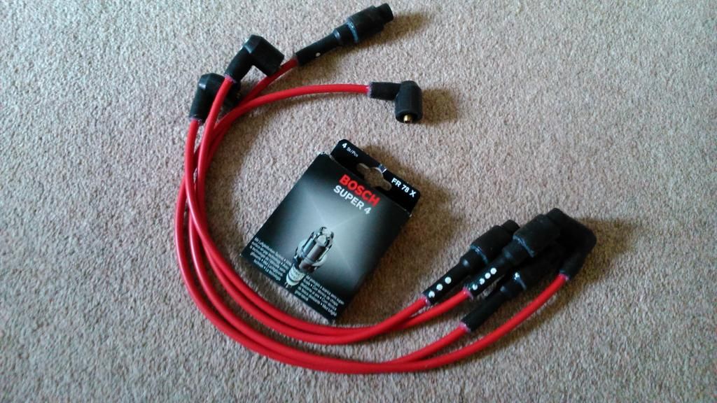

I also rigged up some fresh HTs from a knackered set and some copper wire. (Yes, I've been reading EBB's blog...)

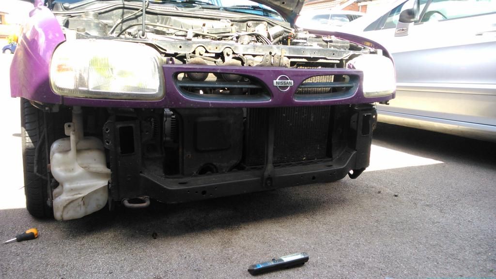

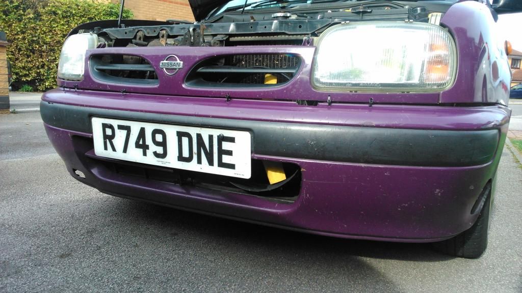

I got the front off to mock up where the intercooler could go and suddenly remembered that the front cross member had been replaced just before I bought it! Felt like I'd just found a twenty in an old coat pocket.
If anyone in the Nottinghamshire area is able to map a Nistune then shout up?

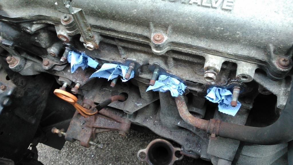

The manifold looked horrendous with all of the corrosion. I was pleasantly surprised however when I managed to remove it without sheering and studs and only rounding one nut!

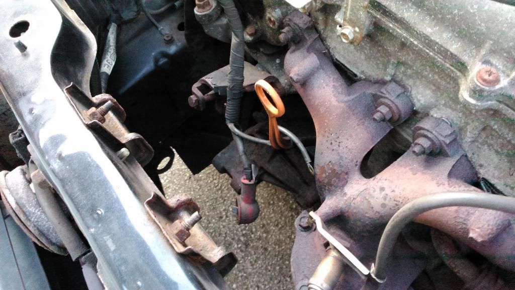

It didn't take me long to encounter a proper problem though...

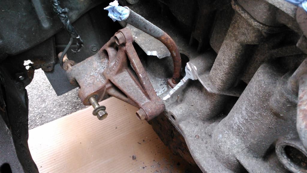

The turbo didn't fit properly against the block with that shroud around the dipstick ^
So out came the grinder.
And now turbo not hit block.

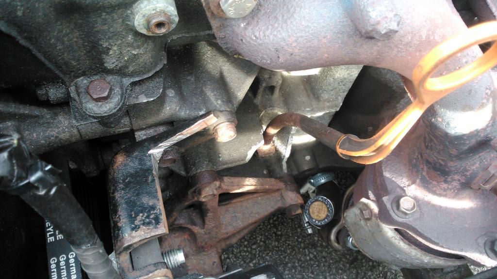

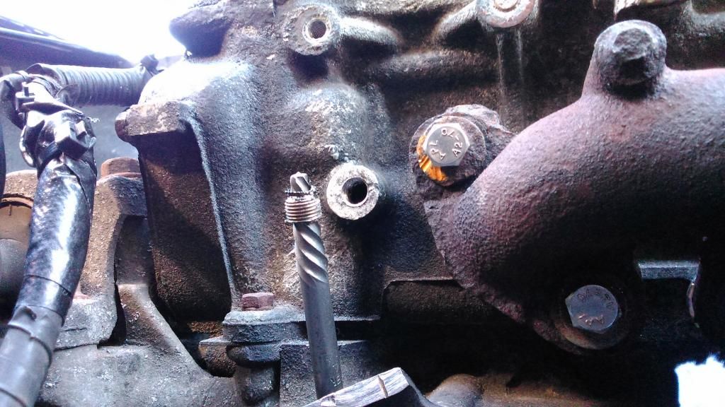

Then I sorted my oil feed and return. The grub screw in the hole next to the exhaust ports rounded on me :( And I had no luck with an extractor. Reluctently, I came up with a bodge involving drilling it through and aralditing a plumbing fitting into it:
I'm actually quite pleased with how it went!

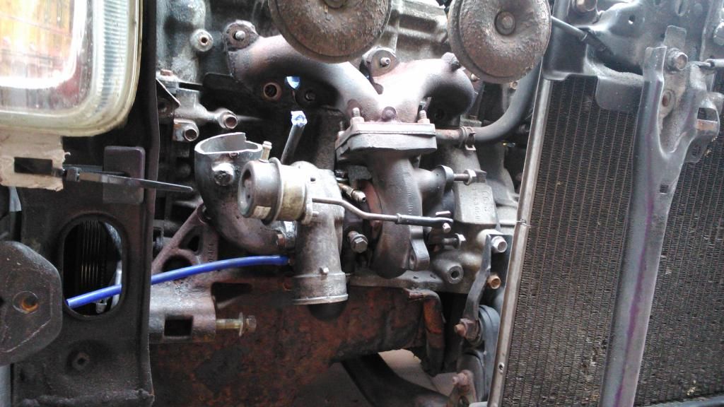

I've bolted all of the major bits down properly: Mani, tubby and exhaust. The exhaust ran where the fan used to sit, so I had to relocate it to in front of the radiator.
The bodywork took a bit of fettling and cutting, but it doesn't look horrendous :)

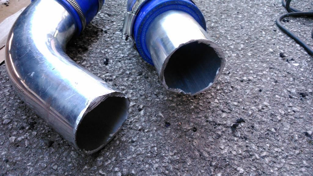

I'm not quite sure how these pipes were cut, but I thought it best to sand them down a bit...

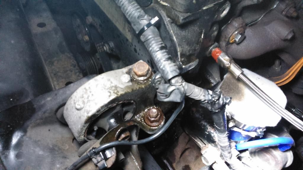

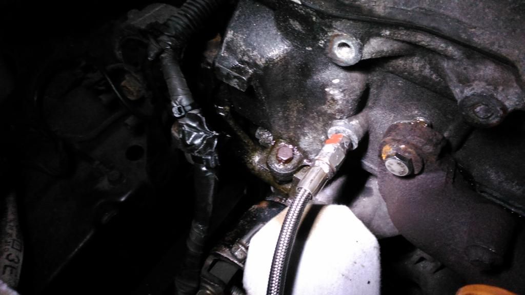

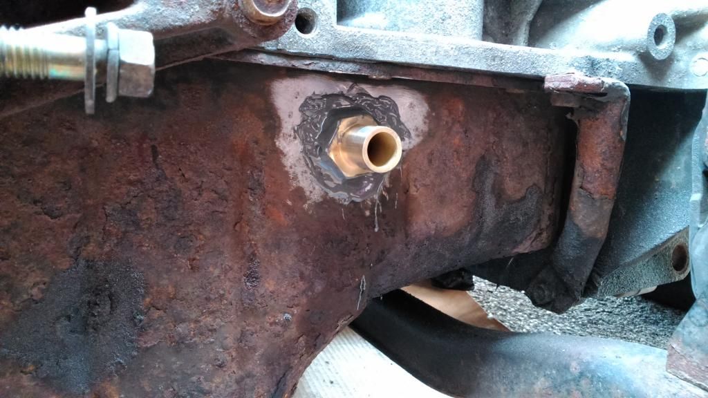

Unfortunately, my oil feed bodge with the brass connector sprung a leak. However, it prompted me to have another bash at removing the stuck grub screw...
Success! :cool:
BUT. Its got another leak now. This time on the hose itself, so I'll have to look into a new one. 1/8 tapered male for the head and a female for whatever the T25 takes (thread identification isn't a skill I possess). What oil lines have others used??
I've fixed the oil line leak and had it running (without boost connected). I took it out for a test run and came back deaf. However, I was happy that I could hear the turbo spool up nicely.
Upon getting back though...
I opened the bonnet to find that she had been sick
On closer inspection, I've still not been able to pinpoint the leak(s)... The oil feed line is clean, as is the thread holding it into the block. It had no leaks before fitting any of this and it seems odd that it'd just suddenly develop one.
Hmm.
crankcase pressure blowing past the crank seal maybe ? have you altered any breather pipes ?
and i thought that front exit would prove to be LOUD :D
I kinda expected to get oil leaks... just not before connecting up the boost!
I removed the charcoal canister when I first bought it, but that's it. Yep, obnoxiously loud. Corsa fart can loud.
it always has been loud, and sounds sweet, frank is right it's more likely the crank seal, it happend to mine and put lots of oil splattering the downpipe causing it to steam up and smell of burned oil

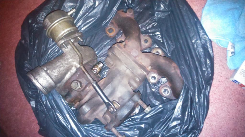

I've had to remove the turbo and go back to n/a as I can't be doing without a car and I don't have room for two!
I plugged the oil feed with a grub screw and used a bit of hose and a wooden bung for the sump return.

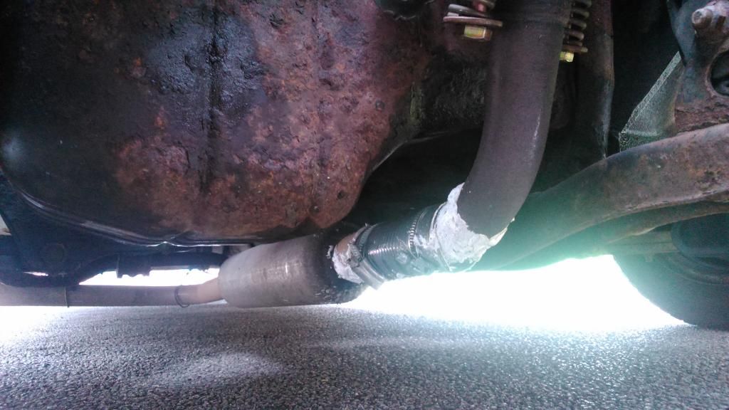

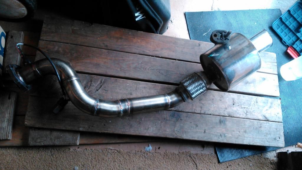

Since I'd had to cut the old exhaust off, I needed a bit of creating to get it back on...
...Beans tin, exhaust paste and jubilee clips.

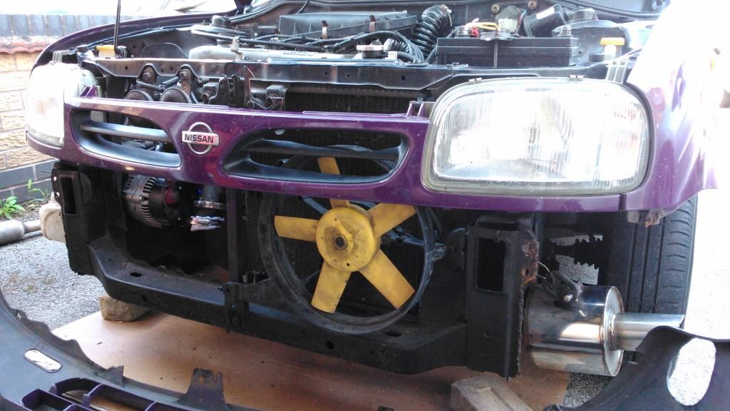

I had to move the fan to the front of the rad to make room for the turbo downpipe/exhaust side exit. I decided to leave it there as I kinda like being able to see it through the bumper :cool:
