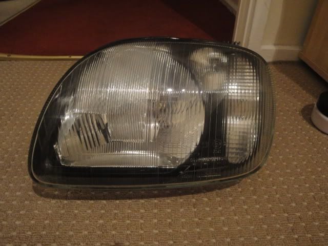

do this to the headlights(Awesome work from ITR-Mark)
