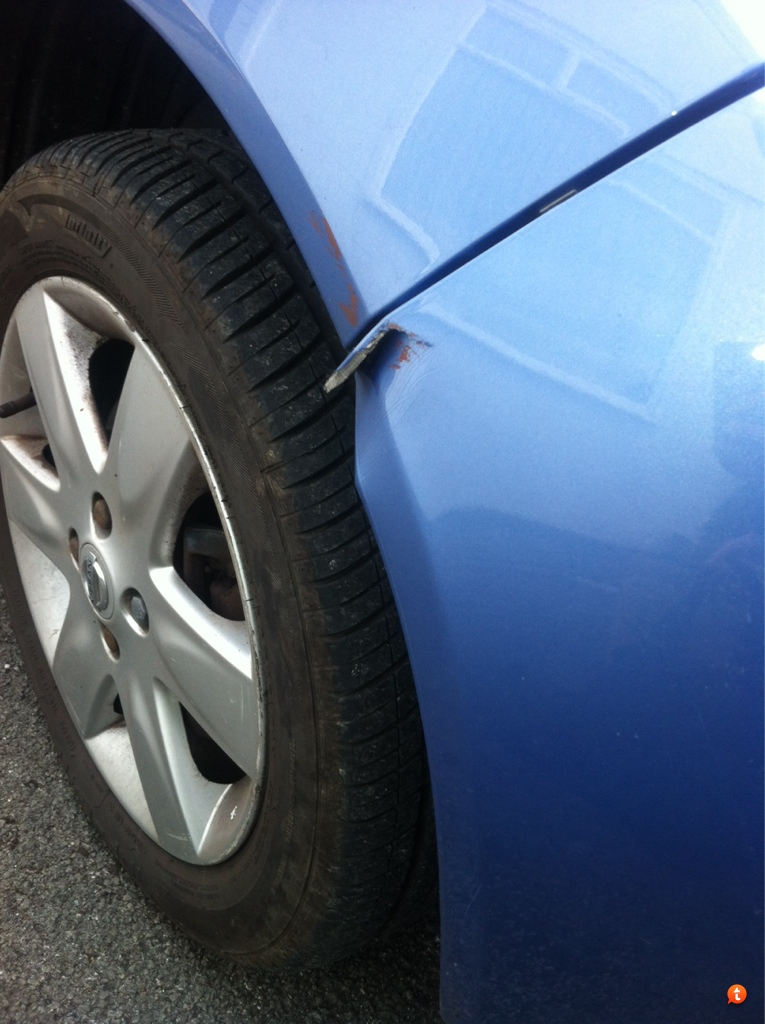

Quote for my bumper
They quoted me 160 to sort it out, is it worth it? it was like this when I bought it :(
Your bumper is plastic ;)....if it doesn't just push back out....buy a new one off ebay...wwwaaaaaaaaayyyy cheaper than getting it "£ixed" :p

Ohh! Won't the paint crack though if I push it out? Gonna look on eBay soon then hehe thankyou:)
You can probably get one for about £40 - £70 from a breaker on ebay or a scrap yard. If you're lucky it may even be the right colour :p
In theory, if the paint didn't crack going in, if you're gentle it won't crack on the way out...hopefully. ^_^
Heat it with a hot air gun or hairdryer, it'll push out easier, hold its shape better and stop paint cracking.
