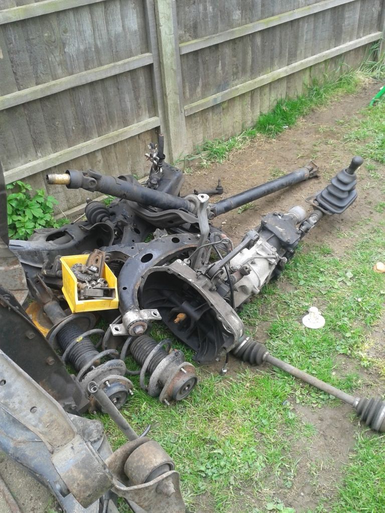

Got pictures and everything too but won't let me upload :(
So I thought I'd throw up a couple of pictures
Nothing much but it's from the start. So I guess you could say its a start of a blog almost :)
Here's mine in front of our poor unknowing donor (at my place)
I compared the heights
Then took a picture of the wheel choice. They came with 4 new/nearly new tyres. They were cheap so they'll do :p
Think I'll have to do it that way
