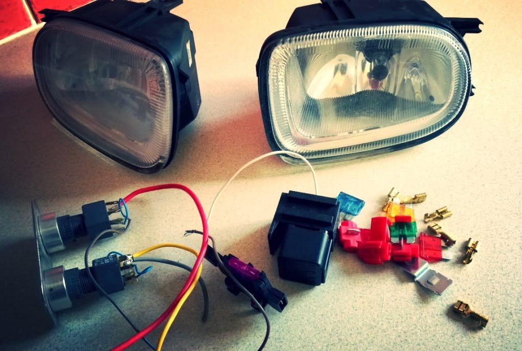

Luckily, I went round my kitcar-building friend's house for curry last night...and left with a goody bag! WIN!

Right, Mr @Agent_Sm1th
I've managed to get me an Almera stalk for £15 (delivered)...I presume that the front fog relay off the 2001 Almera is going to be identical to the Micra one...and, with both fitted, there should, in theory, be light?....

Ok...so, update on this...
The Almera stalk went on in minutes but it doesn't operate the offside headlight...which could be due to the wiring on the back...so, I'm going to re-wire it in different ways until all the normal lights work correctly...
On the relay subject...it's a weird little 15A one that I can't seem to find anywhere...hmmm...any ideas?
