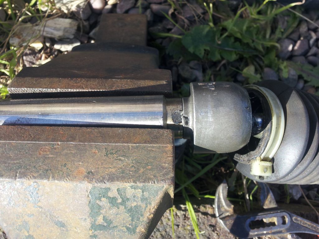

I replaced a bent tackrod today. It was easier than I expected. I was busy bashing a screwdriver under the little tab here but it was facing the bulkhead when I uncvered the one on the car. I didn't need to worry about it. I simply used pipe pliers to grab it and it came undone. I couldn't bend the tab back in when refitted to the rack on the car though, just tighten it hard and trust it to stay tight eh.
