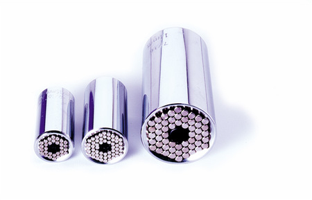

one of these?
Well my backbox is getting on my tits since I can't get my grinder reyt in cos of the flange. Should I either drill them out or get the bottles on it. The nuts are rounded and its on a welded stud.
Those Irwin sockets are really good, get's you out of the hassle of Dremel(mans best friend?)/grinder as do stud extractors if you can get a drill in.
The above ones pictured are crap though in my opinion.
