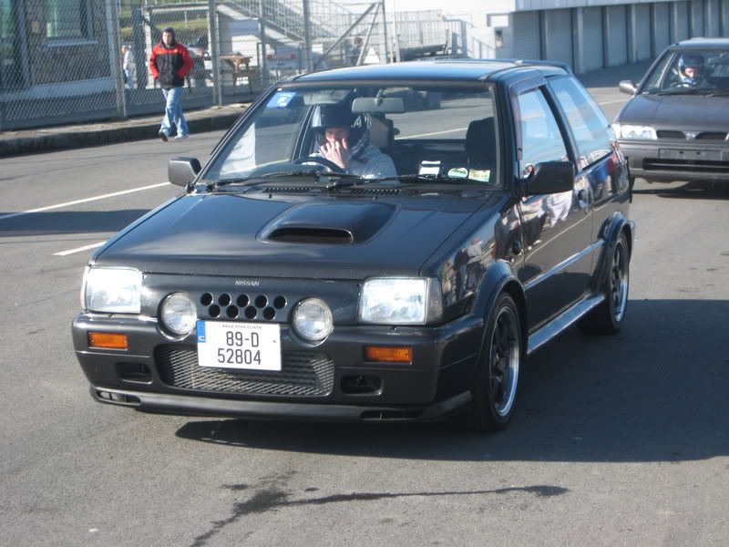

    Baz's March ST
    Thought it was about time ha ha

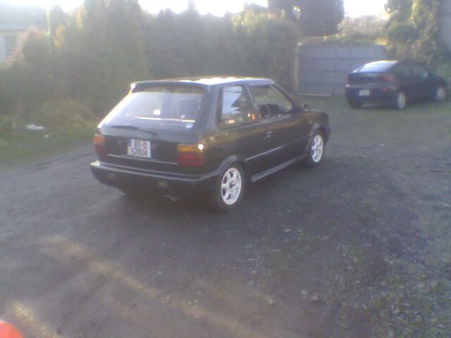

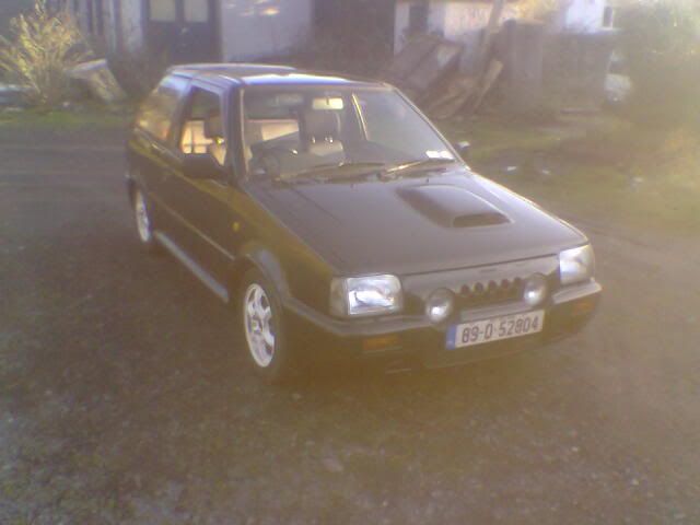

    Bought this car April 2006,arrived to Ireland august or september 2006,
    It was a one owner car with a genuine 77k kms with documentation to prove it
    Payed 425,000yen for it and with Vechicle registration tax and customs duty and Vat the car stood me 3900Euros Roughly
    March st when it was in japan

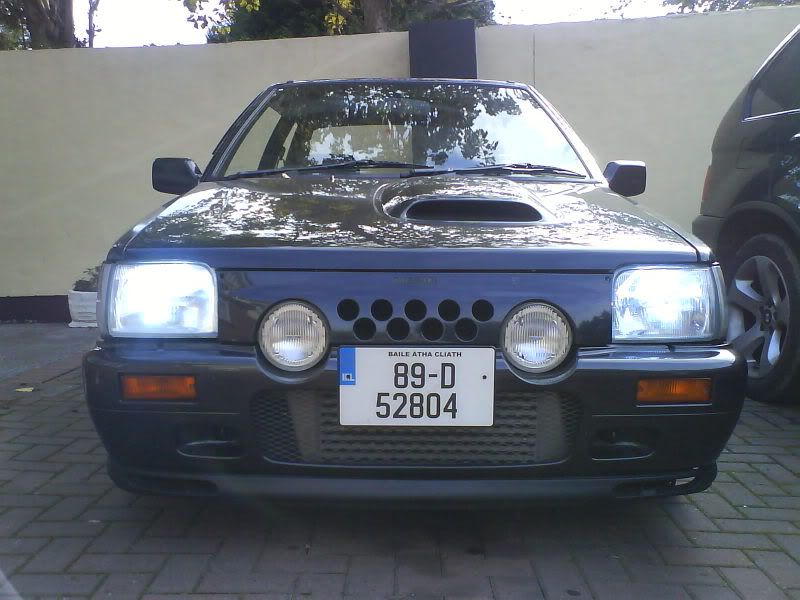

    Front

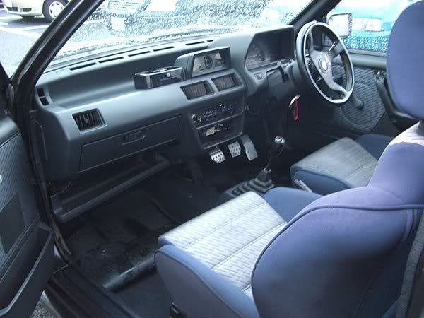

    Driver side Interior
    Passenger side Interior

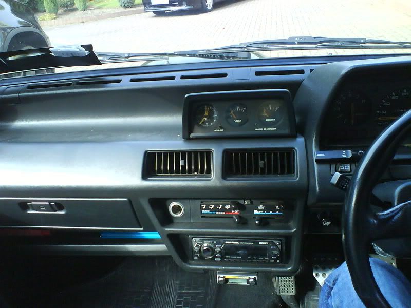

    Clocks
    Clocks 2

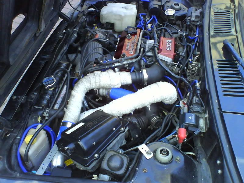

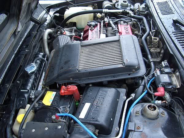

    Engine
    Engine 2

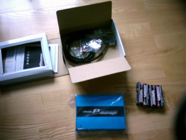

    Greddy E-manage Blue and Apexi iridium plugs

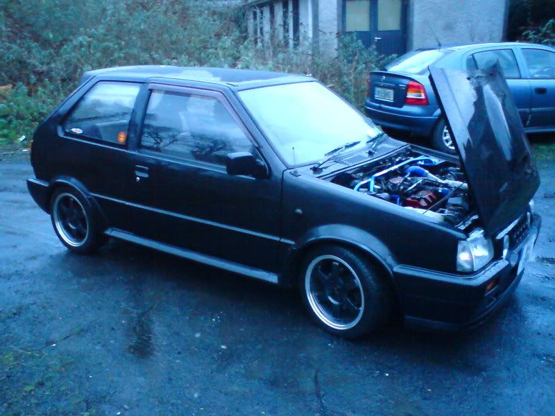

    Car as it stood One month after arriving to Irish shores

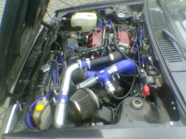

    Picture of the lump with Blitz Starlet turbo airfilter

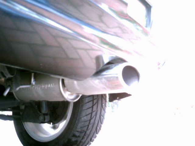

    New full Stainless steel Exhaust fittd as the factory one was rotten at that stage
    Oval Tail pipe

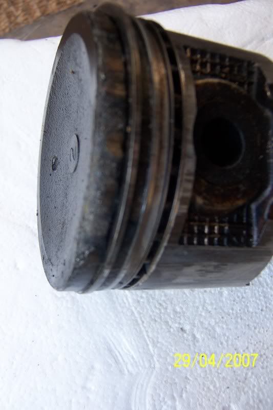

    Then after a few weeks of getting the emanage fitted she melted piston 3 due to the crap fuel in Ireland, car was mapped by ed in the uk on 99octane.
    We only had 95octane in Ireland
    Pic of the melted piston

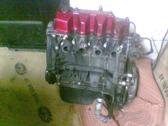

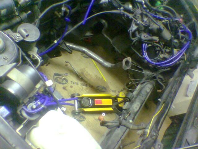

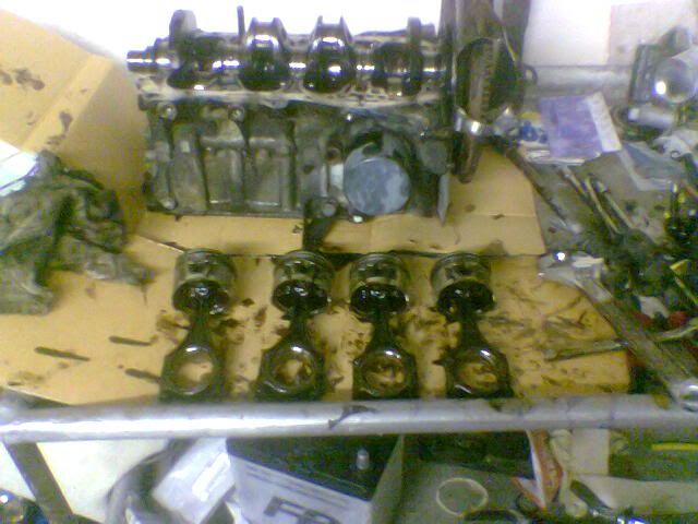

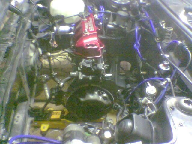

    So the rebuild started,
    While the Engine was out(car was off the road for 2-3months), I ordered a new bpcv, new ht leads distributor cap ,headgasket, head bolts,
    crankshaft and camshaft oil seals and conrod bearings, all new from Nissan japan.
    Also bought a spare engine, was'nt too happy with look of it so I ripped it apart aswell and used piston 3 from the spare engine to,
    build my original block. got the cylinders professionally honed to allow the rings to bed in again

    first pics after the rebuild

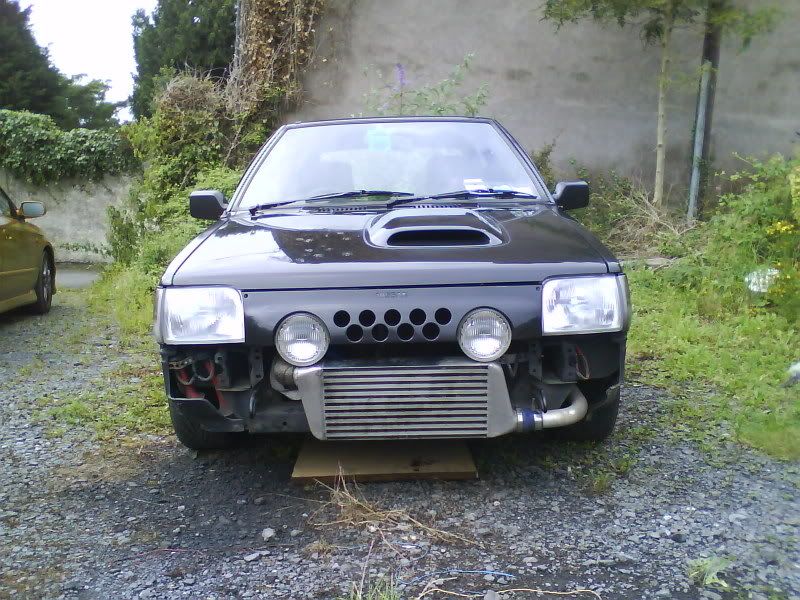

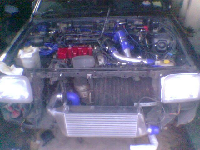

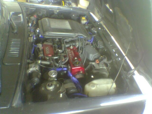

    After that I ordered pipework and an intercooler from the Us as I planed on bringing the car out on track,
    wanted to keep intake temps at a minimum on my newly built and run in engine

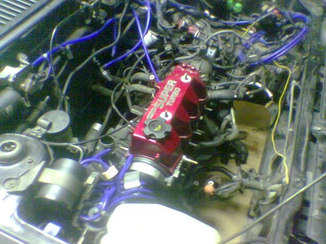

    Here's how the engine looked before starting it
    Here's how it looked the day I finished it

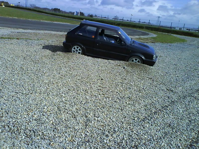

    here's how the first outing ended up lol
    There's alot more in this blog to come the last pic of it in the gravel is from March 2007 so I'll keep updating as I sort out pics and get time to write it up

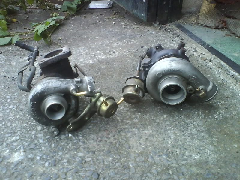

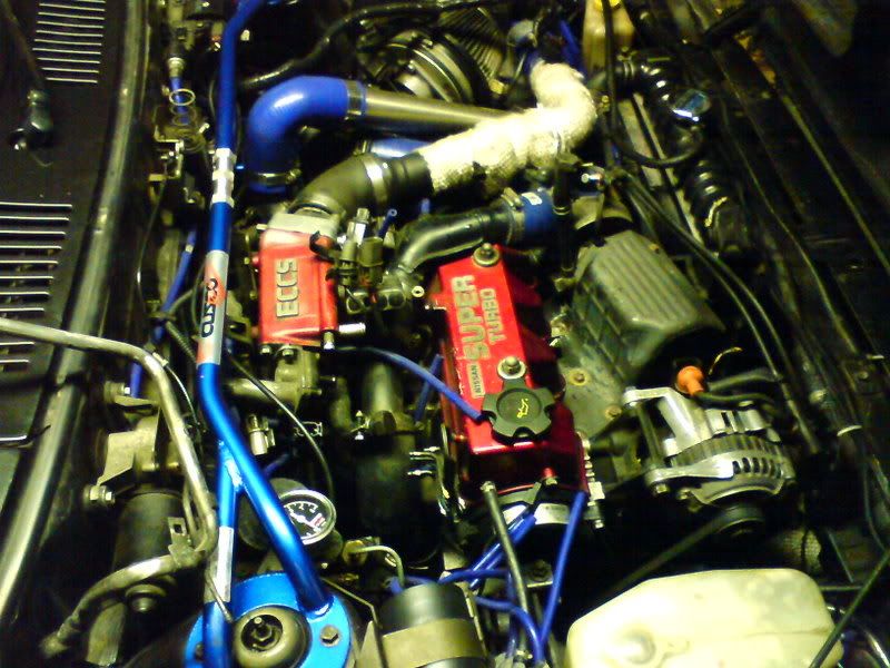

    Then I bought a larger turbo from Ed HT10/T2 hybrid built by Turbo technics
    , its the one on the right and the left one is a turbo from a glanza I had lying around

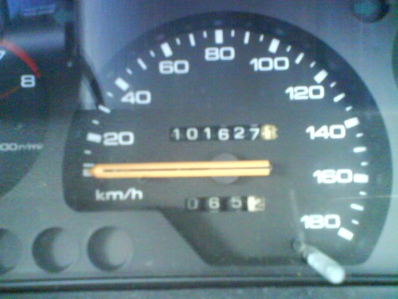

    With just over 101k on it this is how it stood at the time shortly after the turbo went on
    New tubby

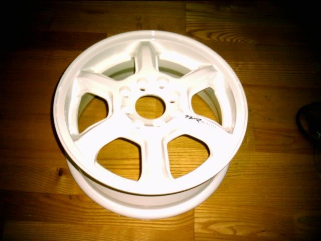

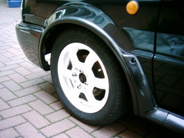

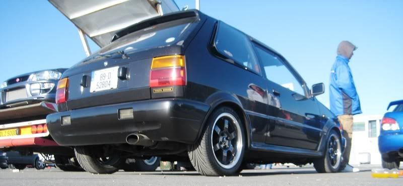

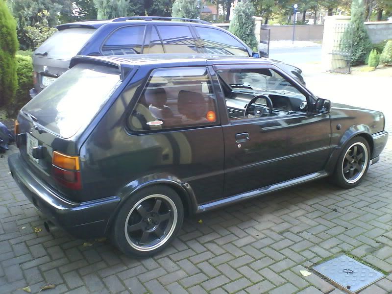

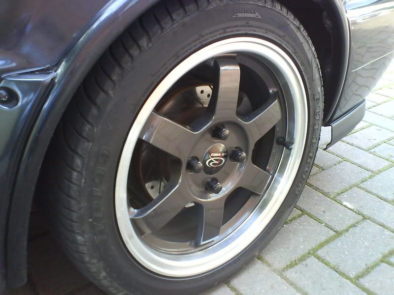

    Car with New 15" Rota grids

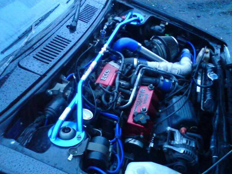

    Then I bought This ; Cusco tower brace from japan
    Pics of the brace on the car

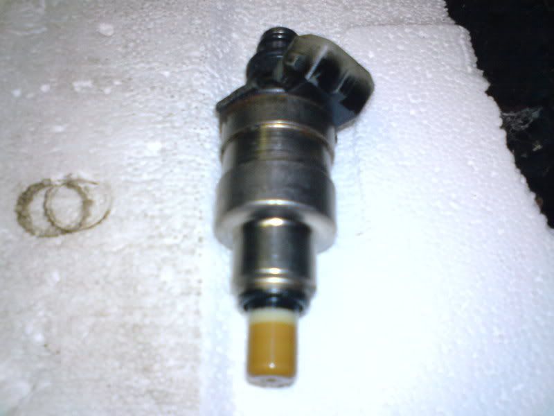

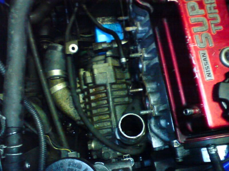

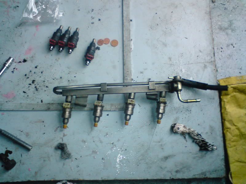

    Then I got a set of ca18det injectors which I eventually take out due to severe over fueling!!!!!!!lol

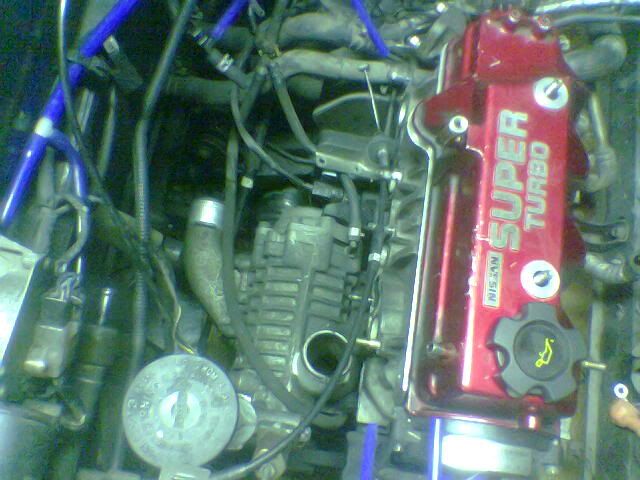

    Pic of the s/c
    Job Done

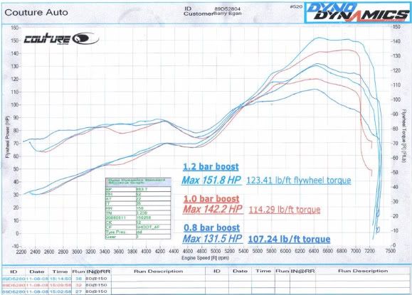

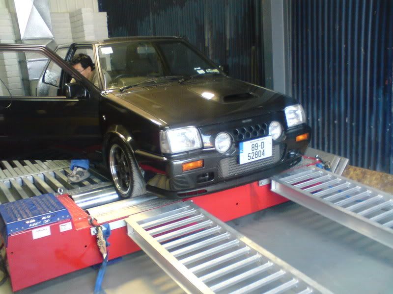

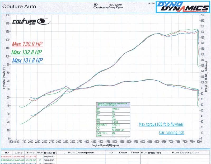

    Got the car remapped and was told by the mapper that it was running far to rich
    but it still made good power

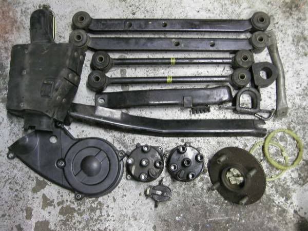

    Spares got some tasty stuff aswell!
    Two Nismo Pressure plates and paddle clutch plates
    Sold one to Warren off here and kept one for myself but did'nt fit as the clutch in the car had only done 10k kms
    I tryed to put the car through an mot (national car test or NCT in Ireland )
    and there was a serious emissions problem due to the injectors being overkill
    so it failed, so I decided to take them out and put gthe standard one's in and a remap
    The results were astonishing on 95octane petrol, we had it over 160fwhp but was'nt safe ignition timing wise
    as we had a knock sensor fitted during the mapping so after 2hours this is what we ended up with

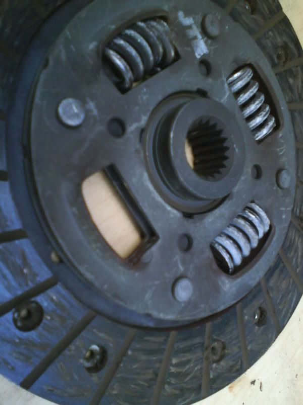

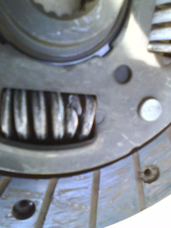

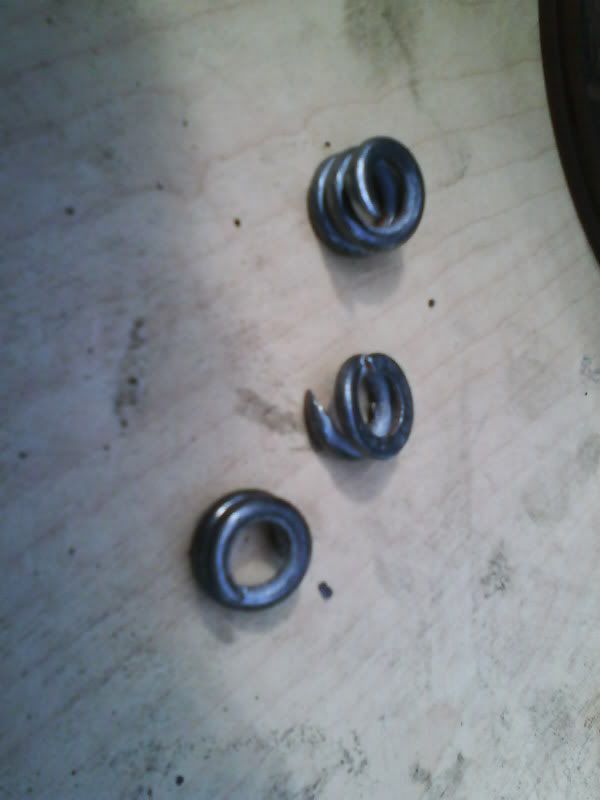

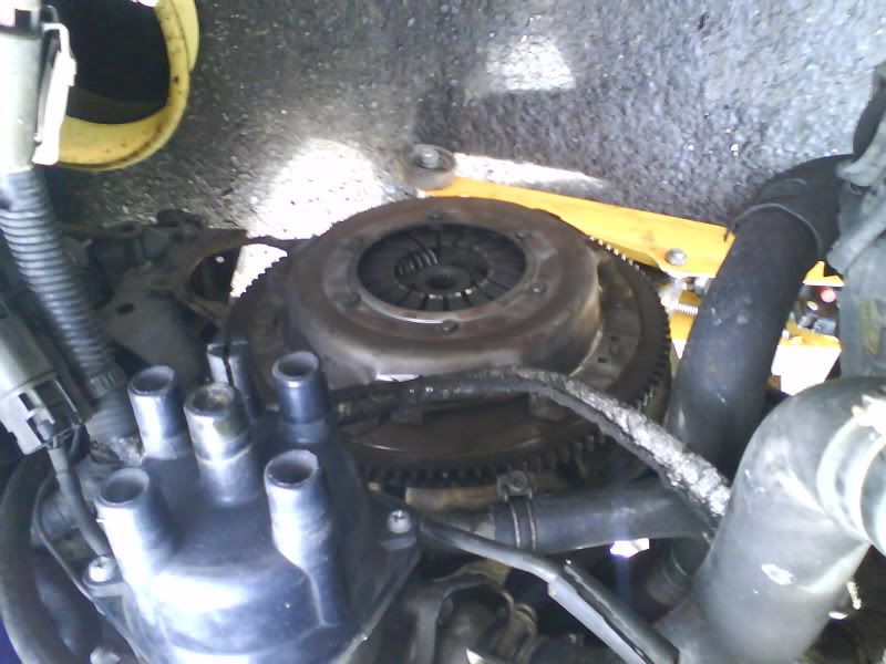

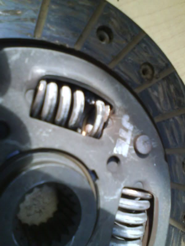

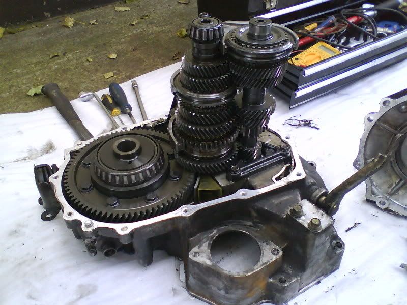

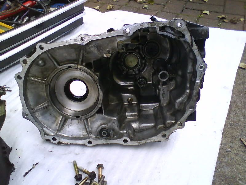

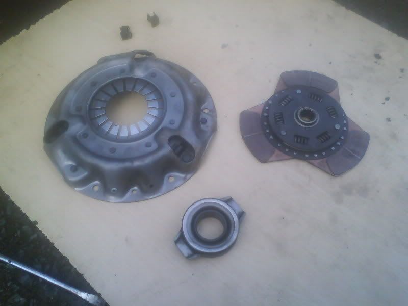

    After two weeks the clutch decided to let go and 4 days away was a trackday!!
    Here's one I prepared earlier
    A spring missing from the clutch disc!! lol
    This fell out on the deck when I removed the pressure plate

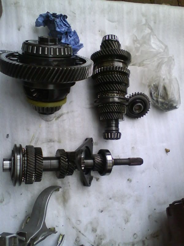

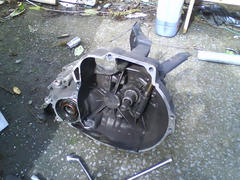

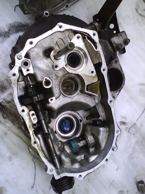

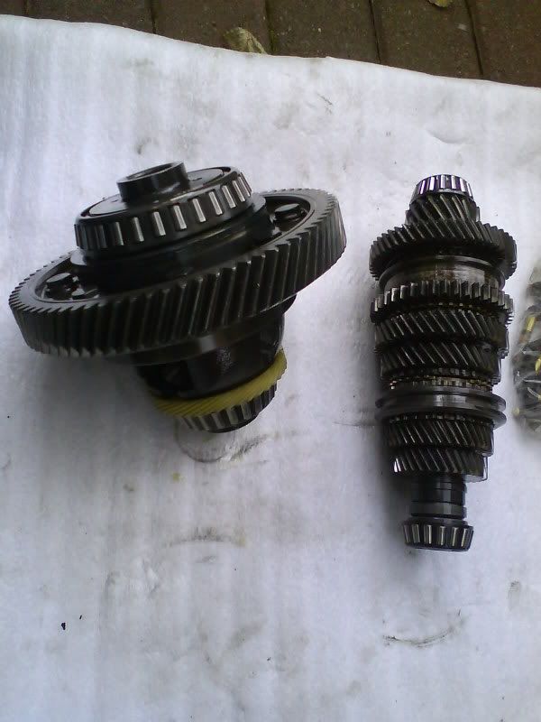

    Gearbox
    New Nismo Pressure plate and disc

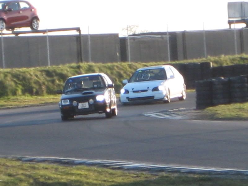

    This was one of the better dices on track
    http://s77.photobucket.com/albums/j4...tdtrackday.flv

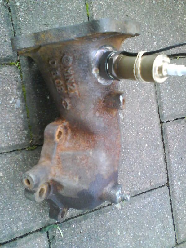

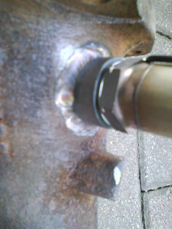

    Ed advised me to relocate the lambda sensor to the down pipe as it original place in the turbo's exhaust housing could be dangerous with raised boost levels

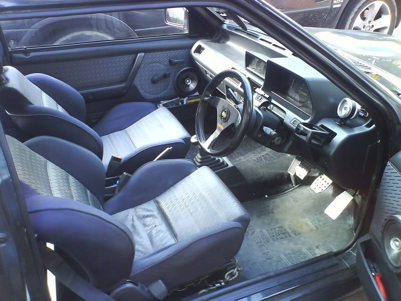

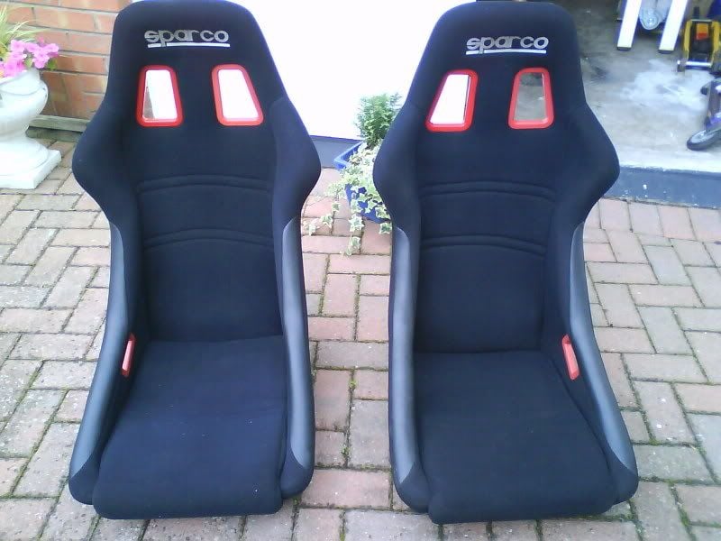

    The next mod was a set of sparco fixed bucket seats
    Had to import ek10 seats which cost €300 seats cost €80

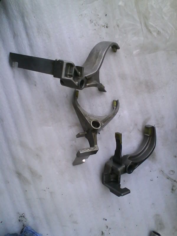

    After that trackday I removed the gearbox to inspect the bearing as they were starting to get noisey

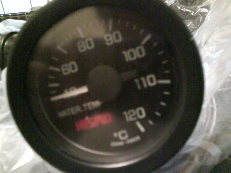

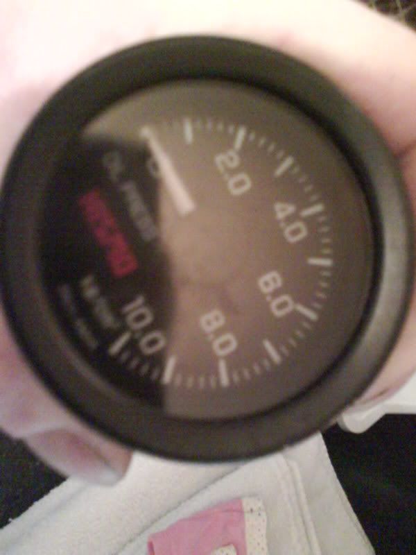

    Then I picked up two second hand ancient Nismo gauges ,Water temperature and oil pressure:
