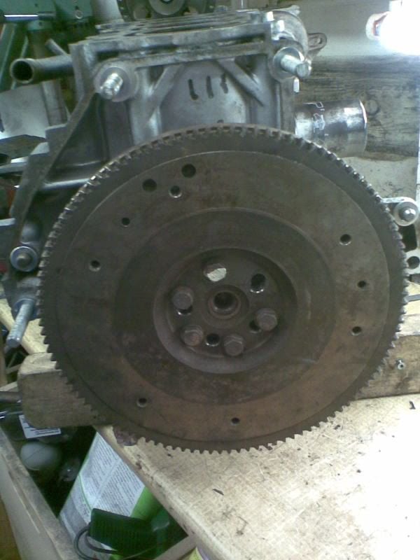

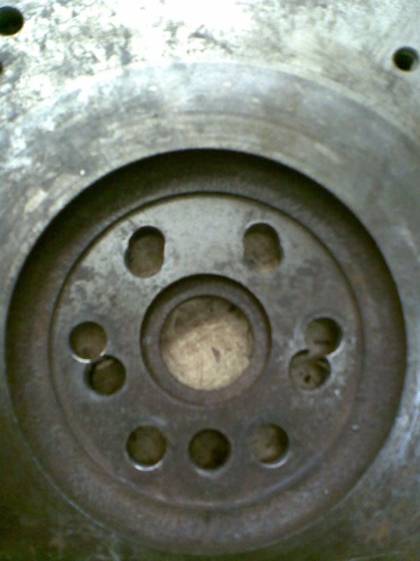

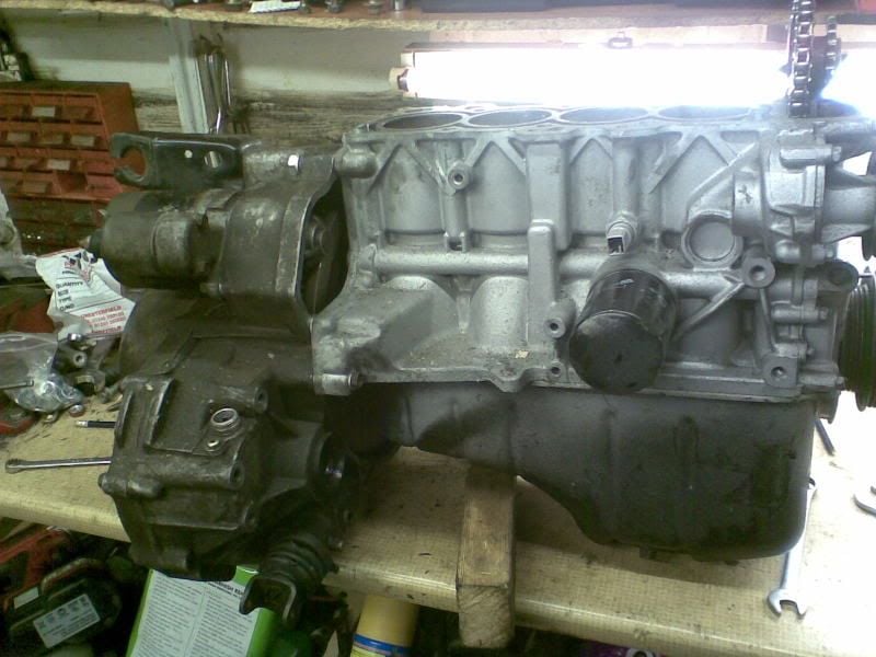

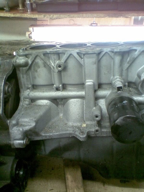

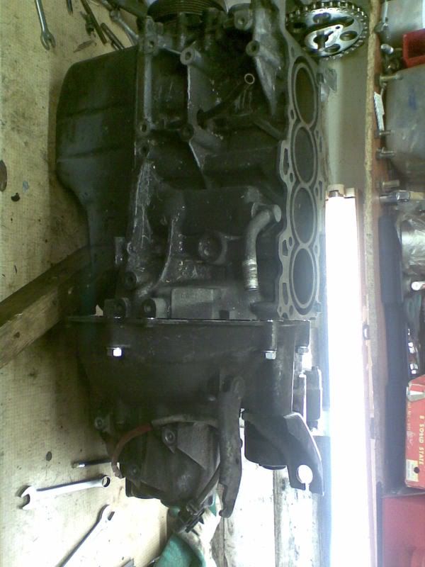

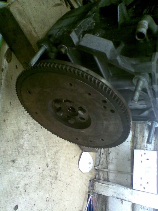

    wow, cant believe ive not updated this in so long,
    anyway, the car is back to standard proformance wise, has been for a while, but not for much longer as i have a few plans up my sleeve. lol
    update
    a while ago i accuired a cg13 block for cheap with a flywheel, my sole intentions at the time was to lighten the fly and sell it on and diasect the block hoping to find something interesting out and give me something to do, however i never got round to lightening the fly or diasect the block, they just sat in the corner of my shed for about 6 months.
    tbh i had forgotten about the engine untill about 2 weeks ago when i posted up about piston rings and that set me thinking that there was a whole lot of myth around the cg13 k10 conversion, how easy it would be and what fit etc, so i decided that if possible i was going to try and clear up a few issues.
    so i began last night.
    as i have practically at least 1 micras worth of spares, (really, you give me a k10 bare shell and i could build in excess of 1 whole fully functioning k10 with a bodykit all apart from an interia), i decided i would test a few things out and document it along the way.
    the main issues and myths.
    1*will the k10 (or early 1 litre k11) gearbox fit on the cg13.
    2*what mods are needed.
    3*method of transfering drive from the engine to the gearbox.
    4*again what mods.
    answers i have personally found

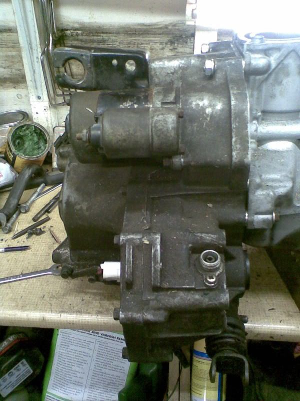

    1* not with no mods no, but can be easily made to in about 5 mins.
    2* the 2 bolts at the top of the gbox and the one at the front need drilling out from 8.5mm to 10.5mm. and you need to use the cg13 gbox bolts, also the 2 support bars from the cg13 dont fit the k10 gbox, abd you will need the k10 tin piece which fits between the gbox and engine. the last thing to make the gbox fit is you need to remove the front locating pin from the gbox, i heated it up and drifted it out, easy,
    now it will fit.

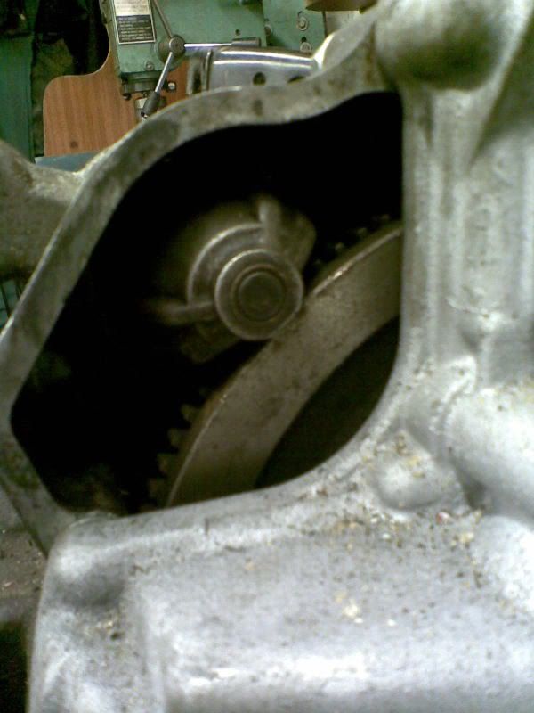

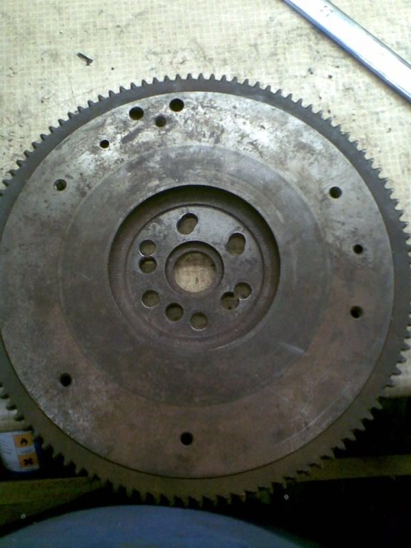

    3* right this was a biggy, the cg13 fly wheel fowles on the inside of the k10 gbox bellhousing, so it cant be used, from futher inspection the cg13 fly is a slightly larger diameter to the k10 one also it is considerably thicker and protrudes futher out from the engine, this made me decide that the k10 fly needs to be used.
    4* but the cg13 has a 6 bolt crank and the k10 a 5 bolt i hear you cry... yes your right but with a little engineering maths, a good set of drills and a little upstairs, the k10 fly can be drilled (successfully) to the 6 bolt configuration. i have already done this and it fits perfectly on the crank.
    so then i refitted the k10 gbox , eurika the engine stull turns and nothing fowles or anything great.
    the next possible problem i faced was if the started still engaged with the flywheel, so on i bolted a starter, i left off the tin protection cover so i could see, applied a little juice to the starter ond off it span, perfect the startor still engages the flywheel.
    i really wanted to put a clutch on the flywheel to see if that still meshed alright but unfortunately i dont have one, but for the time being im assuming that seeing as the starter works ok the clutch will, owing to it working the same setup on a k10.
    on a side note, i have a cg13 clutch so thought id try it on the k10 gbox and the splines dont fit, so its just aswell i cant use the cg13 flywheel.
    anyway pics below.
    before you say anything i only have 5 bolts for the flywheel as ive lost the 6th one.

    While the engine was on the bench I got a k10 block and drivers engine mount and made a jig that bolted onto the gearbox holes for reference and the engine mount, I bolted this onto the CG10 block so I knew where the engine mount needed to be, I had a spare k10 engine mounting chopped it up, got some 1” x ¼” flat bar and made a driver side engine mount.
    I had the engine completed mid December, but was waiting for the Christmas break off work to get it in and running, I decided to start it the week between Christmas and new year. I couldn’t believe how well the installation went I never really ran into any trouble the engine mated with the k10 gearbox, my jig made engine mount lined up perfectly, had a bit of an issue with the heater hoses but all came good, used a k10 bottom hose a k11 top hose, the matrix pipes were a bit more tricky though, the fittings on the engine are ¾” so off to the motor factors came back with some ¾ inch pipe, cut to length pushed on the engine, came to put on the matrix, too big, the k10 heater matrix is 5/8”, back off again got some 5/8” pipe, fitted on the matrix fine but a bit tight onto the engine, had to warm it up in hot water but it was ok.
    Got the inlet manifold and k10 carb on, had to buy an electric fuel pump as the k10 one is mechanical and obviously the k11 isn’t.
    Came to put the exhaust manifold on, as I had used quite long radius bends to aid flow it stuck out quite far from the engine, it his the god dam radiator, only by about 5mm too. So for the time being I got my k10 4-2-1 and re-drilled the flange to the k11 bolt pattern (the ports are the same) and fitted that.
    The k10 alternator is 3 wires, main to battery, to light and excitation current. The k11 one I had was only 1 wire, as I couldn’t be bothered with altering the wiring I altered the bracket and had to make a top bracket so I could fit a k10 alternator onto the CG engine.
    Time came to fire her up, double checked all connections etc, turned key, bit of gas, never really fired, at which point my dad wondered out, giving it all I told you so, etc as they do, turned over again bit more gas, bang flame out of carb.
    Now I’m like yea it’s definitely got fuel and spark, it’s just in the wrong order, plug 1 our, dipstick in hole turn engine till at TDC, dizzy cap off is the rotor arm pointing at plug lead 1, no, well turn it so it is then, right cap back on, plug back in, turn key again, right were cooking on gas now, but lumpy, had to turn the idle up but at least it was running, I was happy for the day, was getting dark and very cold and tea was ready. After tea and a good night sleep, got up early straight into w’shop altered the new 4-1 manifold to make it fit, fitted that, and now armed with my strobe gun fired the motor up and let it warm up, disconnected the vacuum advance to the dizzy, turned off connected strobe gun and kicked her up, turn on strobe gun, crap its about 35 deg advanced, quick adjust dizzy, adjusted it to around 10deg BTDC.
    Fitted bonnet and bumper back on, took her for a spin, it wasn’t right but it was running, the carb wasn’t jetted correctly (which is obvious as the cams are different there’s twice as many valves and it’s a bigger engine), over the next couple of weekends I experimented with jetting, i’ve got it now where its almost bang on, but with out a rolling road session it wont get any better.
    The standard carb is only a stop gap anyway as i’ve got a set of bike car'bs which i’m going to make a manifold for and also i’ve got a set of 2 twin choke Weber 36dcnf’s (the same type that Curtis and speedle had on there car).
    If you got this far well done, i'm sure I wrote less than this for my final college project ha-ha.
